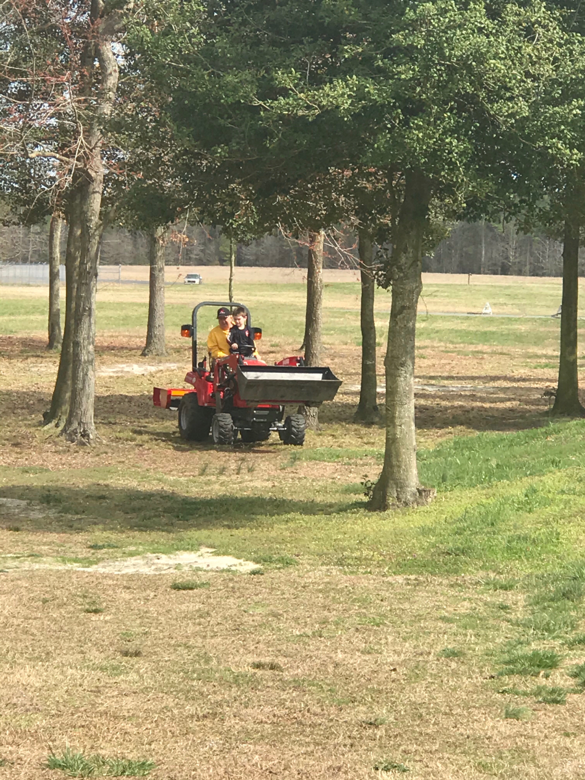

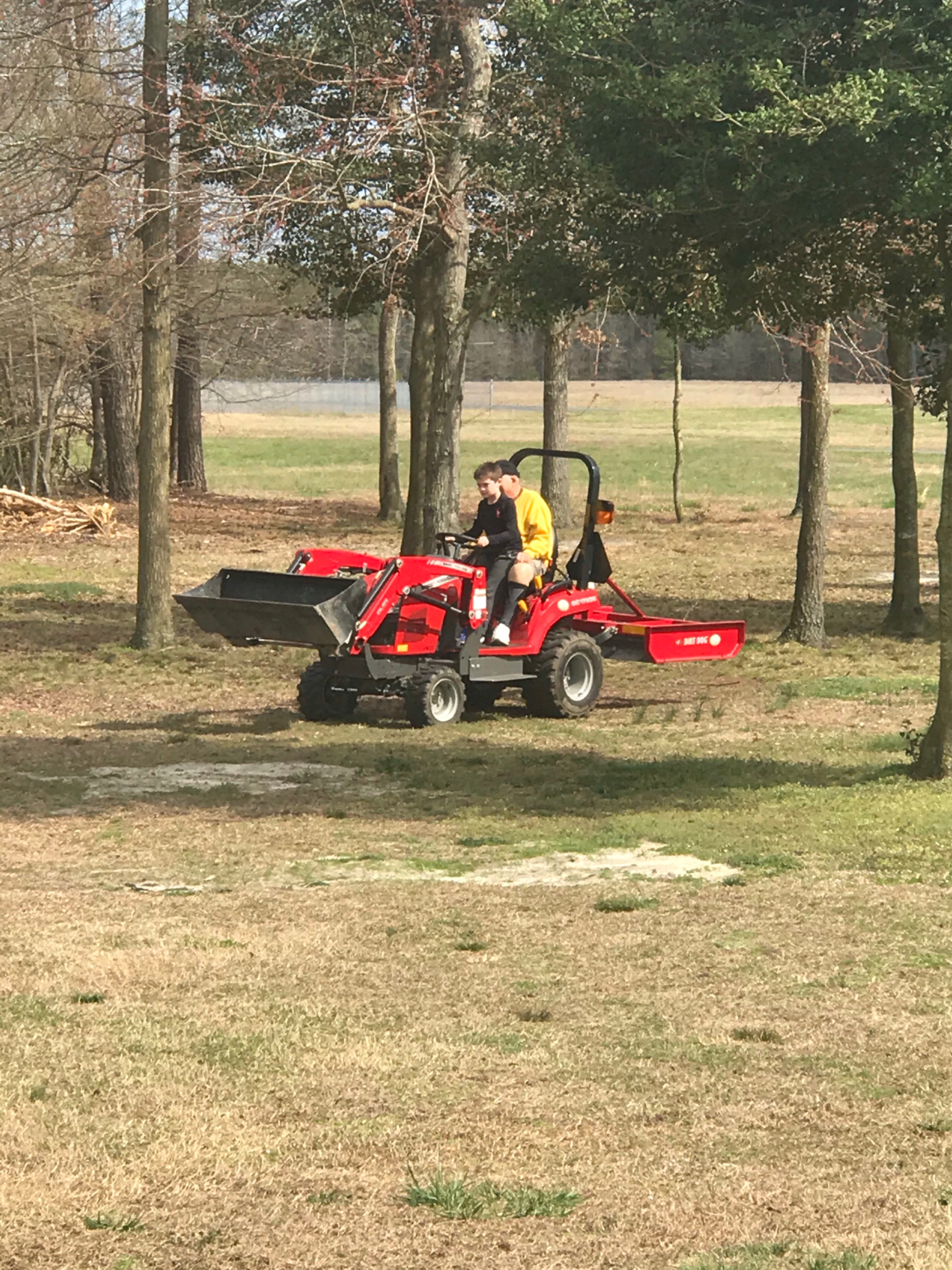

Grandson getting wheel time.

Randy- Thanks for sharing Grandson sharing Grandpa's tractor pictures.
