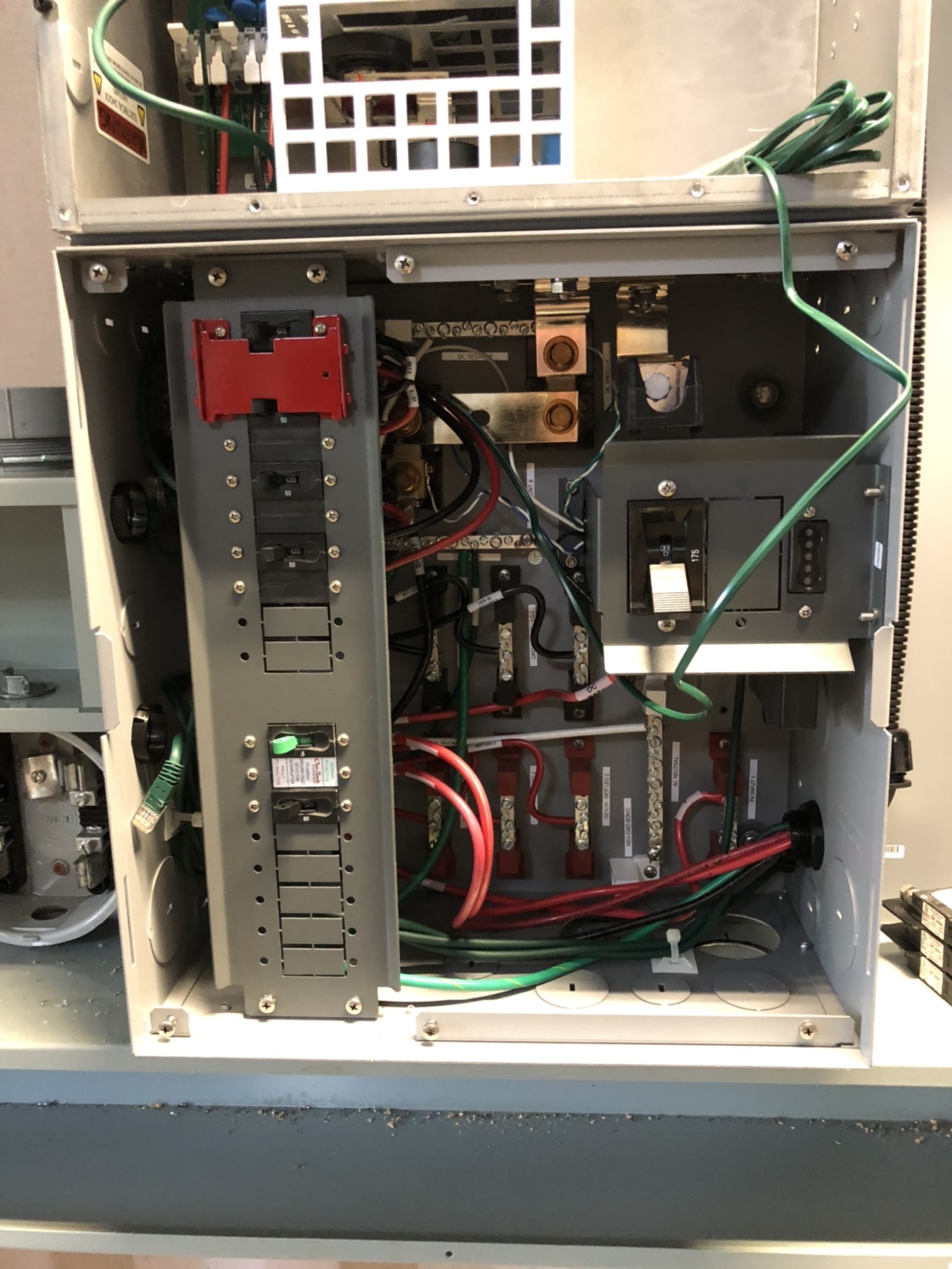

Notice breakers in lower left for FM80 CCs
4048
8048
Is the 4th FM80 not wired yet?
Is green breaker the FM80 dc out with shunt? Or is shunt in the 175a dc breaker?

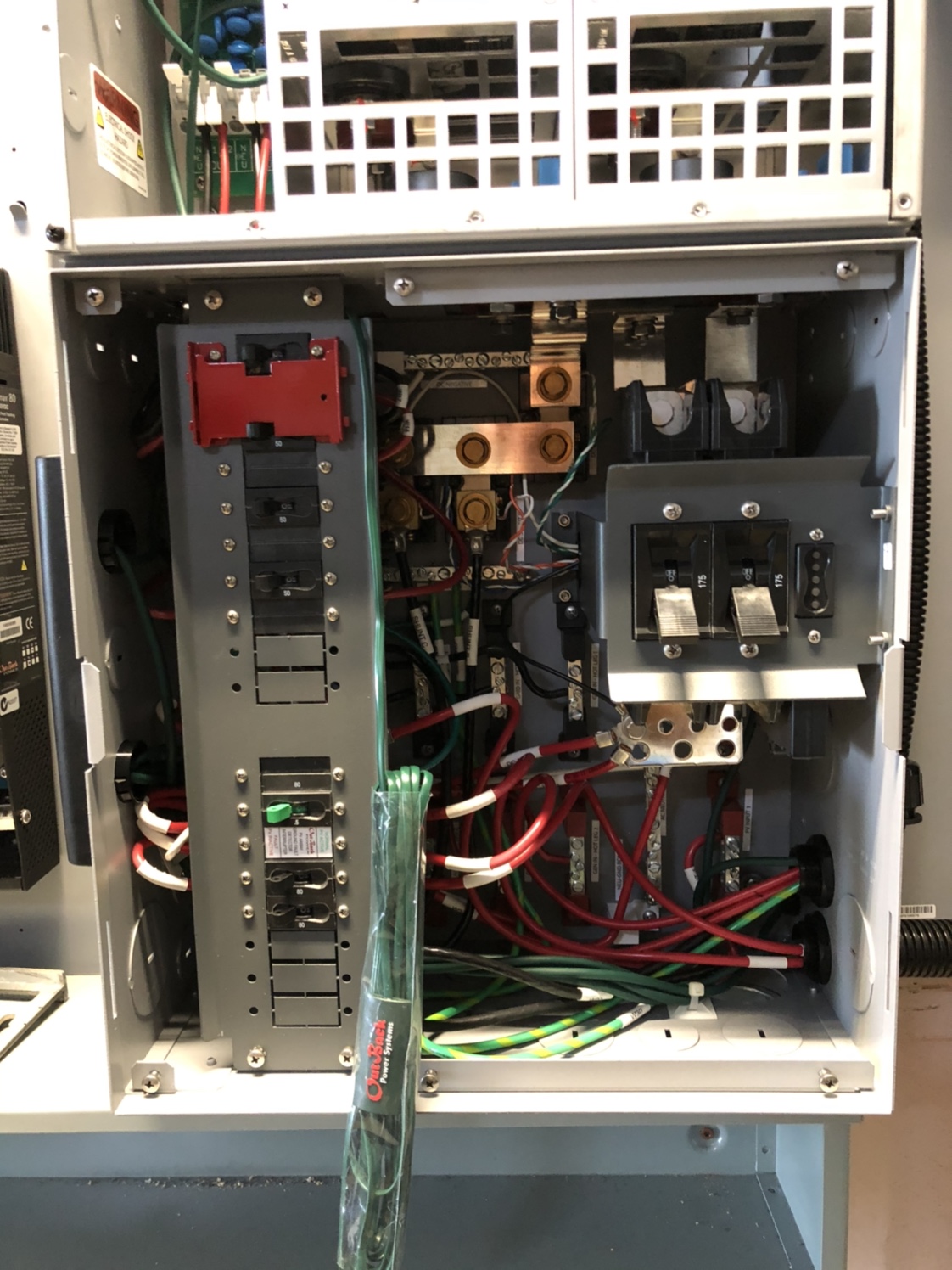

I believe the FM80 breakers are in the Load center. That is part of today, adding the 2nd CC and appropriate breakers to the 4048 system.
System will only use 3 shunts.
A - all the Radian inverters
B - all the FM80 CC
C - my FX external chargers.
I’ll get an as is pic after coffee, then update after all together.
When you go away for a long trip, do you disable diesel backup? If it runs you need to manually reset the FM80 breaker to have panels charge batteries.
Not wired. The Prewired 4048 comes with just 1 CC
Green breaker is GFCI
No, generators stay enabled.
No resetting, the CC have own programming.

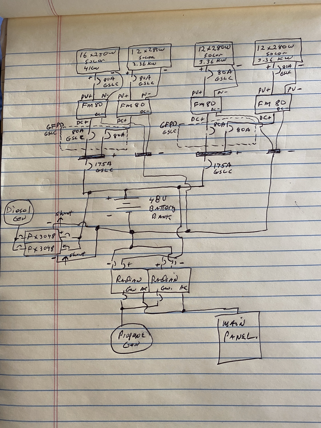

David what is the purpose of the shunts?

The shunts provide the means to meter various values. How much output from Radian inverters or charge from their chargers. Charge provided by PV via the Charge Controller. I will use the 3rd to meter the charge provider by my FX chargers. My understanding is a shunt provides a known resistance, making measurementspossibe

The end of another long but productive day. System not quite finished, should be tomorrow.
Need to unwind a bit, also take a good look at BEF’s drawing.

I think you did very well.
Don’t know symbols etc but I thing you got the flow.
On another level the inverters, charge controller, and batteries are connected together via something called Hub 10 and managed by a device, Mate 3s. This allows setting various parameters in the system, monitoring of system at individual component level and aggregated performance, and the ability to start/stop various functions via internet.
