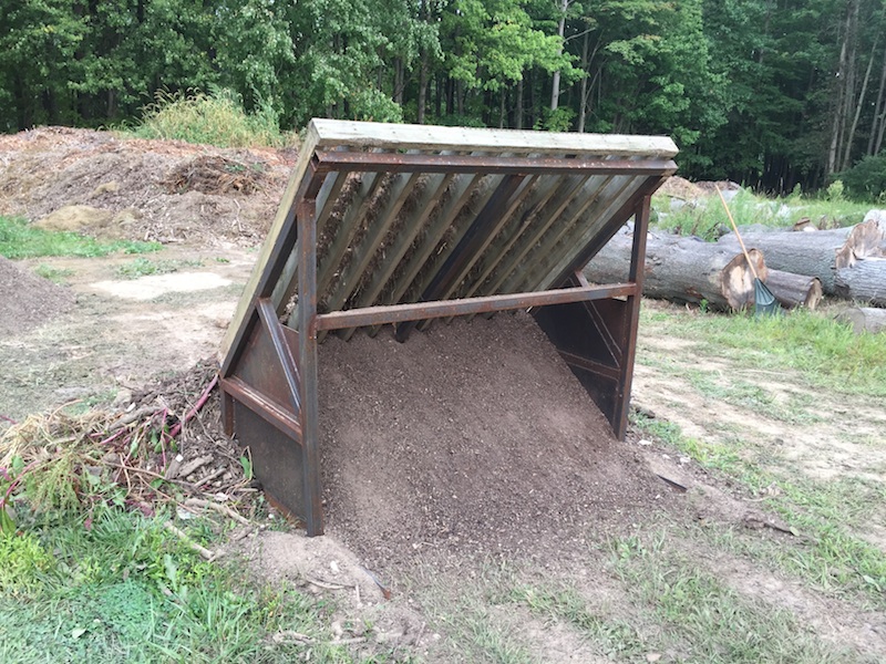

Here's a pic of the soil screen frame with the 1" screen on it:
I actually made an error in my previous description ... the 1" screen has the most 2 x 4's in it ... looks like one every 6" O.C.
I think I did that because I was going to be using it to screen stuff that had some pretty good sized rocks in it and felt it needed the support.
Looked at the gravel screen yesterday (buried behind stuff in the barn) and I think the spacing was 12" O.C. rather than 6" because there really isn't any large rocks in it and I can control the rate at which I dump it.
You can see some of the grass/weeds that gets caught in the screen.

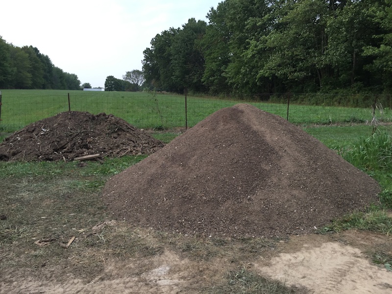

Here's the results. The screened pile in the foreground is about 5' tall and 10' in diameter:
The pile in the background has been through the screen several times and still has a lot more in it that could be sifted out. The majority of the screened material isn't any larger than probably 1/2" to 5/8" generally.
The frame that the screens sit on was built from 2 x 2 x 1/8 wall square tube, 10 gauge sheet, and a couple of pieces of 3/8" x 3" (?) x 6' long angle for the two runners on the bottom ... plus a few short pieces of 1/4 x 2 bar stock to keep the screens from sliding off. The 10 gauge is probably overkill ... 12 gauge would probably be fine ... but it should hold up long-term. (Same deal with the 3/8 angle runners ... 1/4 probably would have been fine)
Based on my experiences using a wooden frame for the base (and having to rebuild/repair it a number of times), metal should be much more durable ... particularly if you are going to move it.

Thanks RS, very informative. Biggest question is how did you determine the angle of the screens?

Gotta question for you, though. I noticed on the 1" screen, the 2x4s in the middle run from top to bottom. Wouldn't that orientation prevent some material that would otherwise make it through the screen from going through as it rolled/slid from top to bottom on top of the 2x4? Would turning the screen 90 degrees would prevent this and give you a higher yield?
That's a interesting observation ... :thumbsup:
Part of the reason I did it that way was because the hardware cloth I was using was 24" wide (3 pieces 24" wide = 6') ... so the hardware cloth is supported on the edges where two pieces abut.
I can't really just turn the screens 90 degrees, since they are longer in one dimension (6' x 5') ... but it might be worth exploring if I ever need to rebuild one of the screens.
Mebbe at least reduce the top to bottom runners to only two ... and have the rest of them go side to side.
Rick,
Not sure if you are asking how I decided to use 45 degrees as the angle ... or how I determined the angle is currently at 45 degrees.
As to the former, I just arbitrarily picked 45 degrees ... based on having read some stuff about dump trailers and how much angle was necessary, at a minimum, to get them to dump.
On the latter, I didn't actually measure it before I made the post yesterday ... and am mostly operating off memory. I am reasonably certain that 45 degrees is correct ... primarily because it's very easy to set the angle on the bandsaw to 45 degrees ... using a combination square on the bandsaw's vise and the blade.
I originally modeled the frame/base in 3D in my CAD program to come up with a workable design, and to come up with dimensions/lengths for a cut list for the individual pieces ... factoring in the dimensions of the old wooden base (which was actually a little too tall)

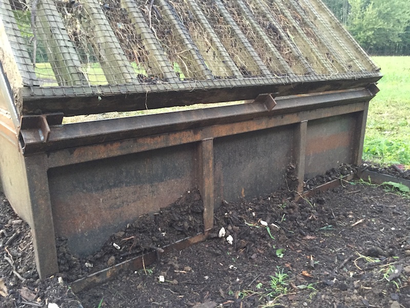

Here's a pic of the stops, made from 1/4 x 2 bar stock that keep the screen(s) from sliding off the frame:
You can also see how deformed the hardware cloth is from having large rocks (size of a football or larger) dropped on it.

The grass/weed/root debris that tend to get caught in the screen:
