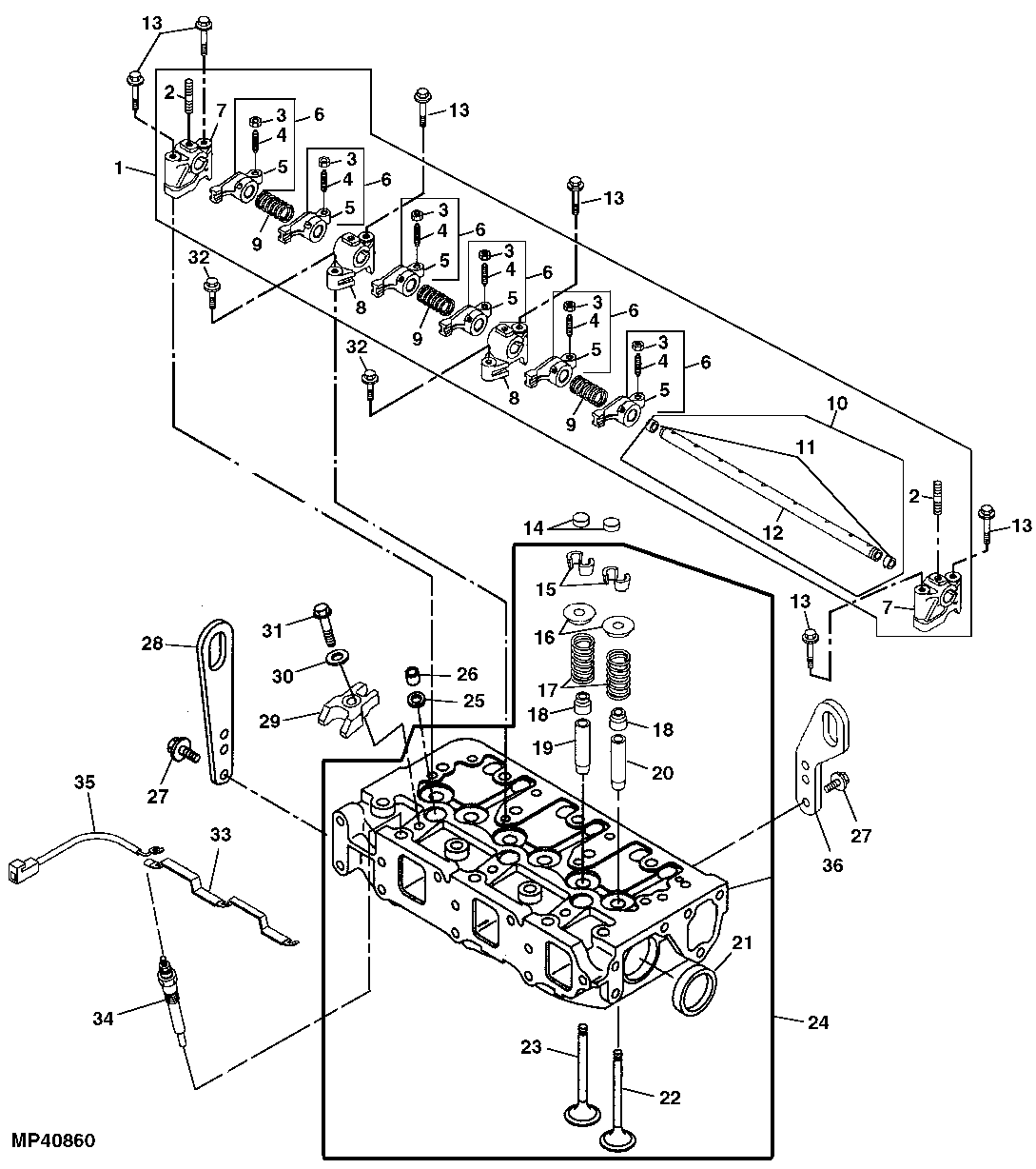

I was reading through my 2720 manual and got to the section on cold starts. I do not have the tractor yet, but part of the cold start procedure in the manual is to let the glowplugs cycle. The manual also shows a glowplug light on the dash as the 2nd light down on the right side. Again, I don't have the tractor here to confirm the light and its characteristics.
I thought the direct injection engines did not have glow plugs. I had read that in posts here and my dealer had even volunteered that info. I did a search here after reading my manual and did not come up with a definitive answer. Some have speculated that the light, which seems to be a recent addition, may be connected to a pre-heater. If so, why would the manual refer to it as a glow plug light and cycling the glow plugs on a cold start instead of just referring to a manifold pre-heater?
Do the newer direct-injection engines have glow plugs?
Thanks,
John
/ Glow plugs or not? #2
Yes, it has glow plugs...While you are waiting for your machine you can learn to use JDParts:D
Look at #34 in the diagram below:

Thanks Kenny; I'm still learning all the resources available. I didn't even think of looking on JDParts. I was scouring the paper and online manuals last night as well as old posts, and all along the info was easily accessable on JDParts. :)
Now I'm a little curious why the addition of glowplugs? From my reading, it looks like they may have been added to the 2520 sometime in the '08 model year, and I guess on the 2720 all along?
Since I've owned a few diesel vehicles in the past, I found it odd that JD had a diesel engine without glowplugs. However, in all the research I did during my buying process, I never found any posts complaining of difficulty with cold starts on the 2520.
