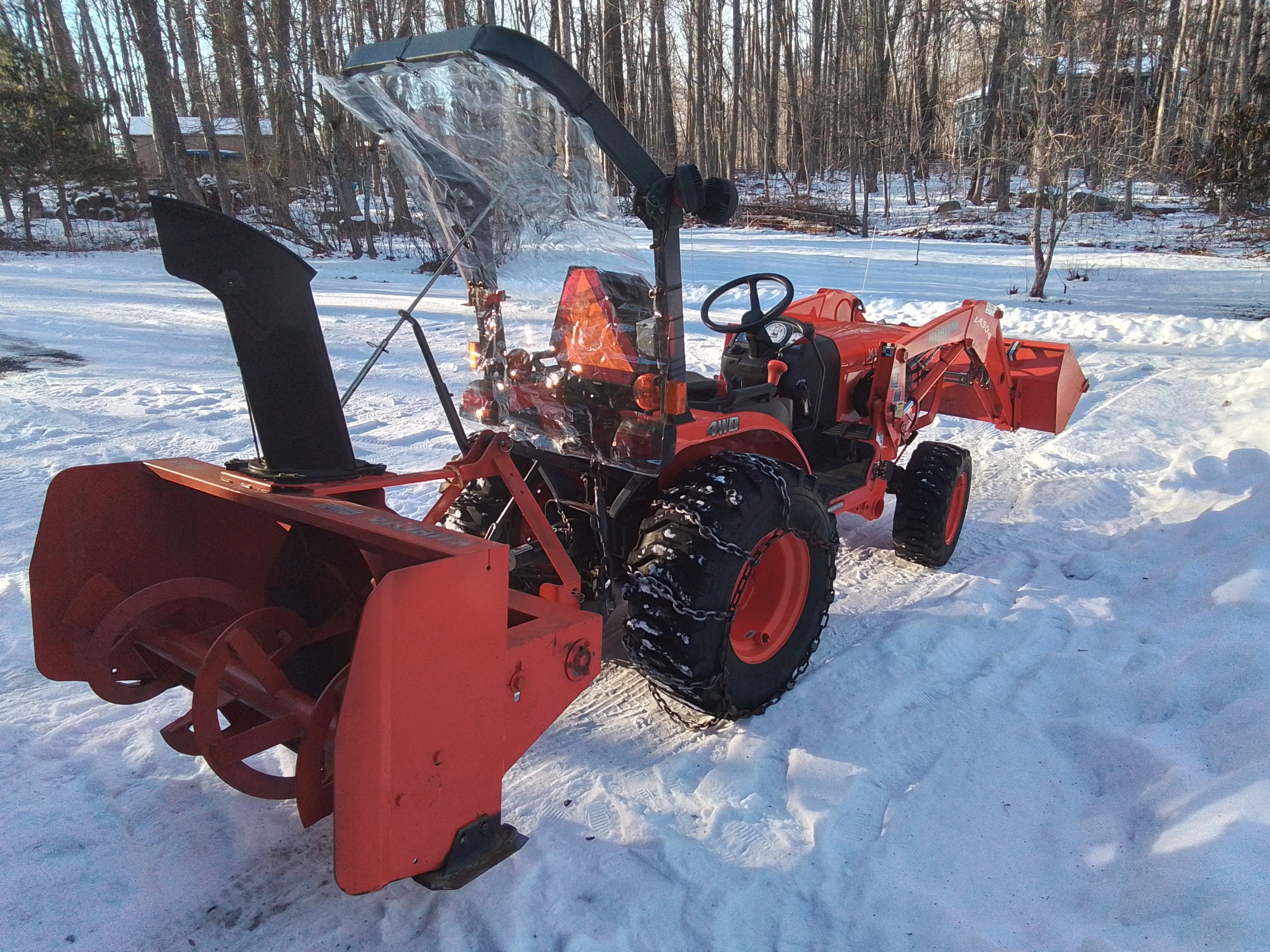

Little orange machine started really hard today.
It's about 10 degrees outside.
Battery is new.
I've never experienced a hard start before but it's a 2010 tractor so it's not new.
In the past it started easily: glow plug, cranked, always started first try
Today: glow plug, cranked & cranked, glow plug, cranked & cranked, glowplug, cranked and started.
It's possible I didn't hold the glow plug on long enough at first. I haven't started it in this kind of cold in a while. We didn't have much snow last year so there was no need to.
I like to fix things before they break if that makes sense.
I've stayed on top of all maintenance.
Is it common for a 16 year old tractor to need a new glow plug? Anything else that I should consider replacing?
Anything else I should keep an eye on?
Hopefully it starts okay tomorrow and Monday after the snow falls.
