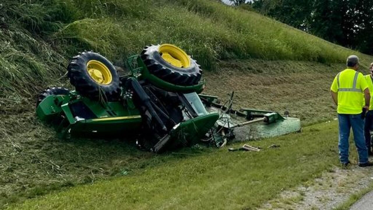

Always concerned when I see these folks cutting by the side of the road on a hillside. Wonder if that blown right rear tire was the cause or a result.
Worker safe after tractor overturns during a mowing job in Lebanon

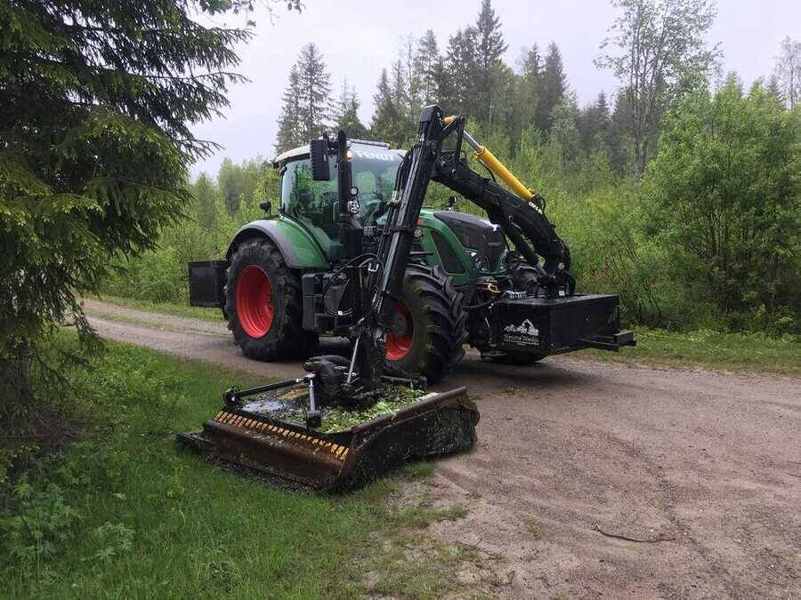

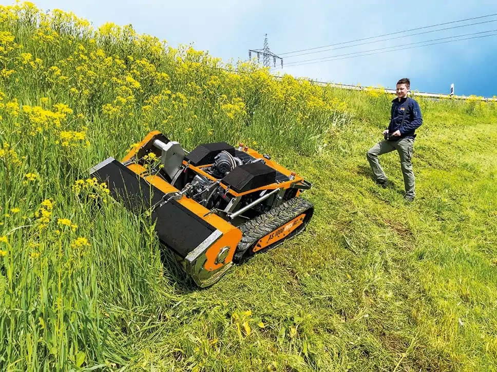

Over here those hillsides are handled with boom flail mowers and the tractors never leave the road. When those can't do it, a crew of 4 to 6 people will do it by hand with gas string trimmers that will also handle the brush around poles, signs, etc that the tractor can't do.
Lately there has been a slight increase on those remote controlled flail mower for the very steep hills though.

There’s a vast amount of road sides to mow over here. Using large tractors with bat wings is the only feasible way. They actually have fairly few rollovers. They use those boom mowers on county roads where the ROW isn’t wide enough to need batwings and they also use them to trim branches off the road but the interstates are almost exclusively done with batwings.

Not sure why I have questions but I do... (slow typing) WHY was the rear (up hill) tire blown? It should have just lifted off the ground and if it did "blow" it would have made the tractor more stable by lowering the uphill side. Also, the location of the front (down hill) tire, suggests he was higher up on the hill, if it was a simple roll over that tire would be closer to the bottom of the hill. My guess is that he was in reverse (higher up the hill) when the roll over took place...

Came across one where the operator died later that night from internal injuries… side mowing, older tractor no rollbar.
Was told same tractor had been mowing the same side hill since the 80’s each year in preparation for fire season…
