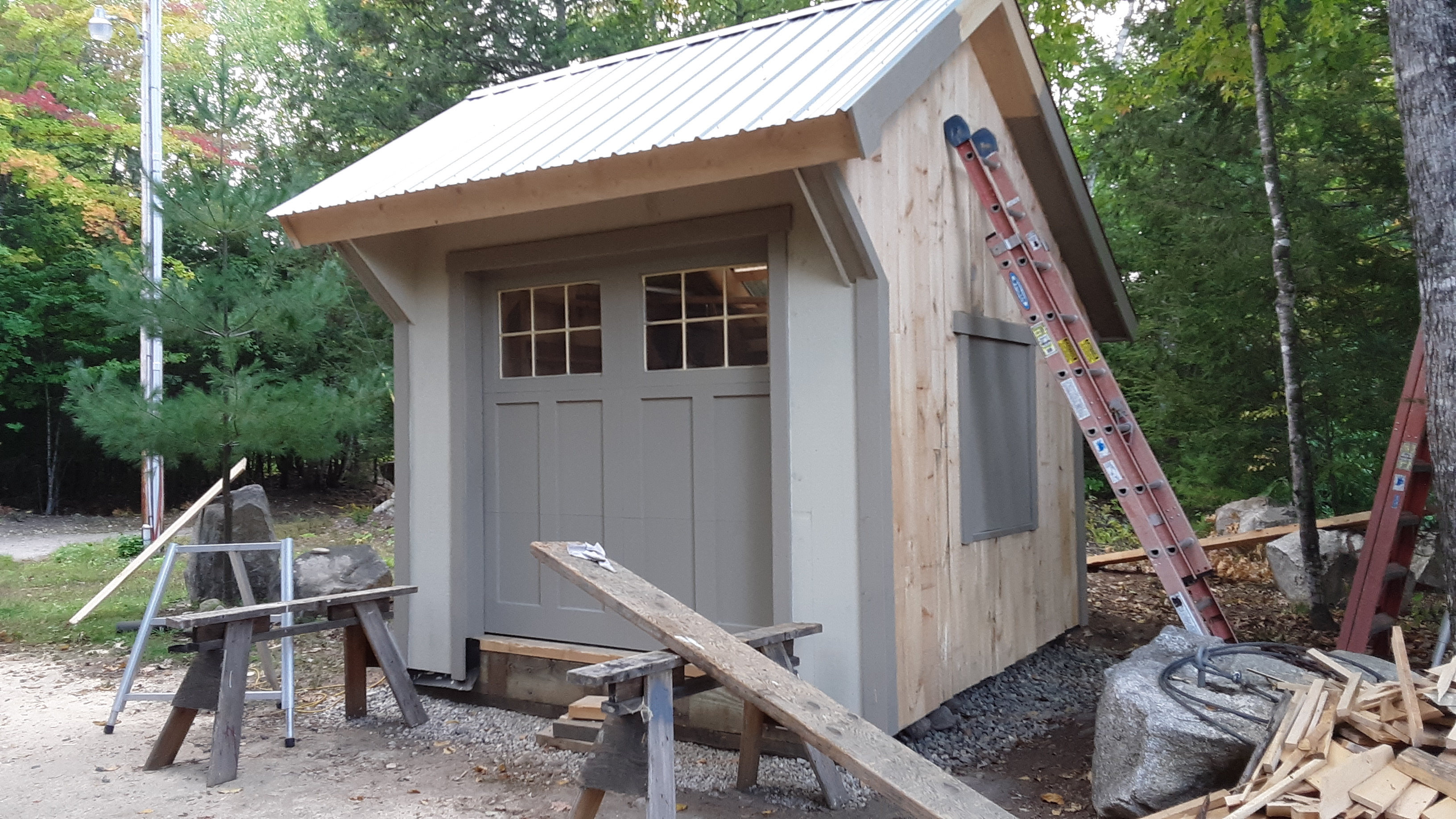

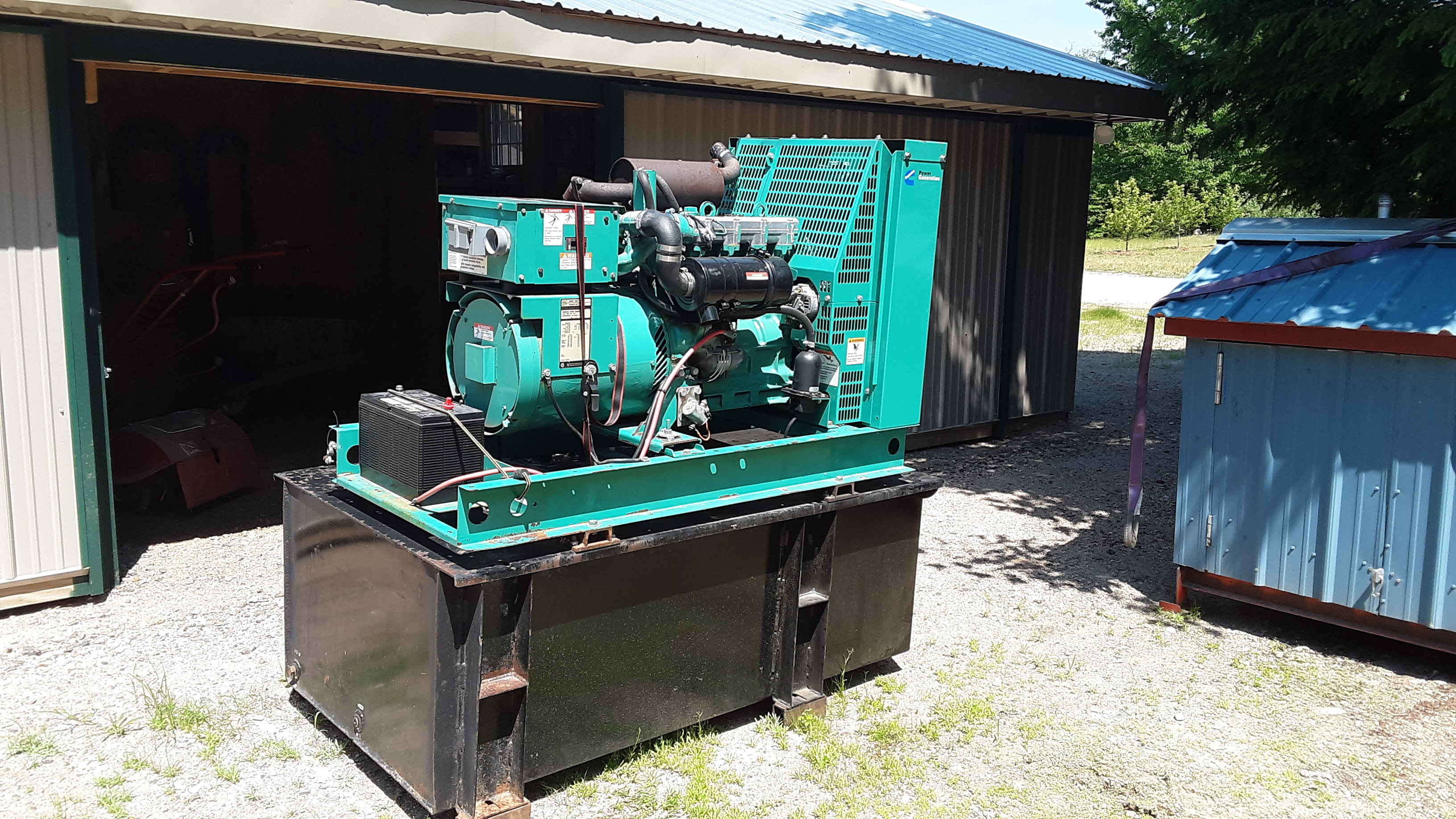

Anyone have a good recommendation for treating diesel fuel as far as a "biocide" or whatever it's called to prevent the algae growth. I just got a new diesel generator with a 200 gallon tank for a base, I'd like to keep it filled (just in case) but that might be enough for quite a long outage at 20kw. And it won't be pulling 20kw too often or at all.
Any suggestions for an additive or possibly only filling partially?
It's going to live in this little building when I finish it.

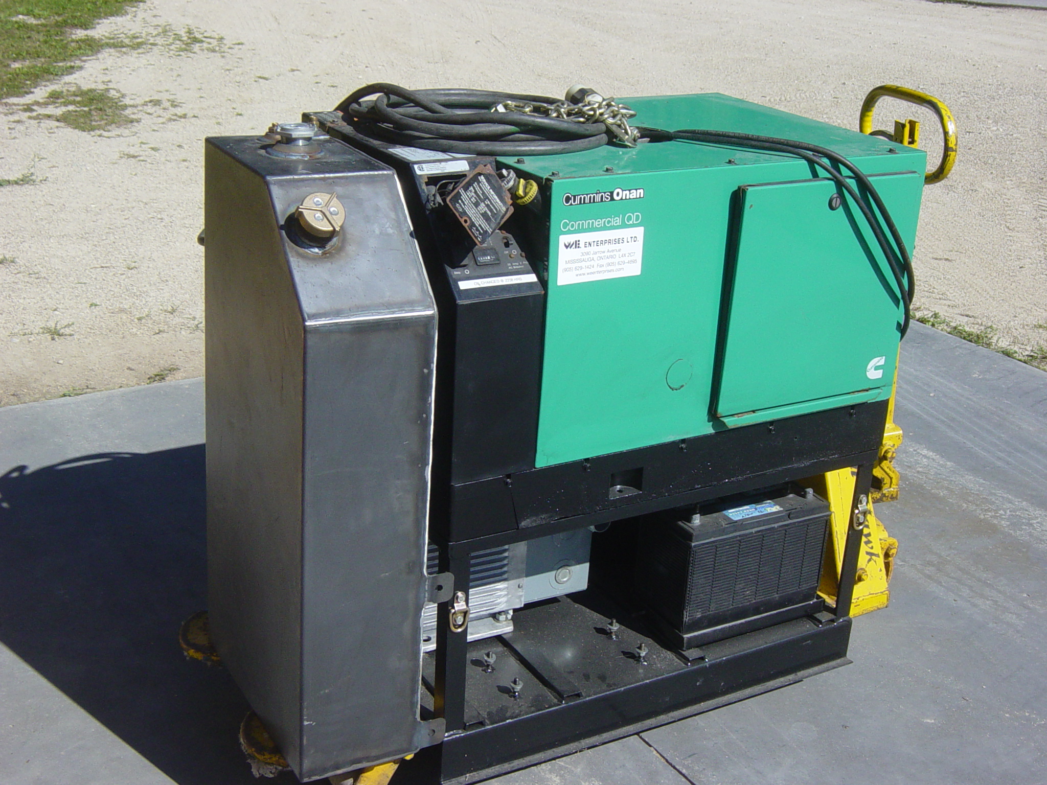

Sawyer, you know we differ on that. Not so much the hours, I couldn't sleep knowing my tractor was running, and as for my old JD 770, full bore, throttle pulled right back, to run my old Onan 15K pto set, perfectly. Fan belt breaks, rad springs a leak or oil pump quits and it's a fifteen grand bill! Maybe not that high, or maybe higher depending on tractor.
JD 770 Onan 1500 July 26 1997.jpg 2002
Only filling a tank partially is far worse for condensation. And besides, I like having every possible tank always filled anyway.
I made my fuel tank high for this project to limit the exposure area, fuel to air.DSC00062.JPG
Nice rig! I use the JD stuff but any parts house should have Seafoam or several like it.
