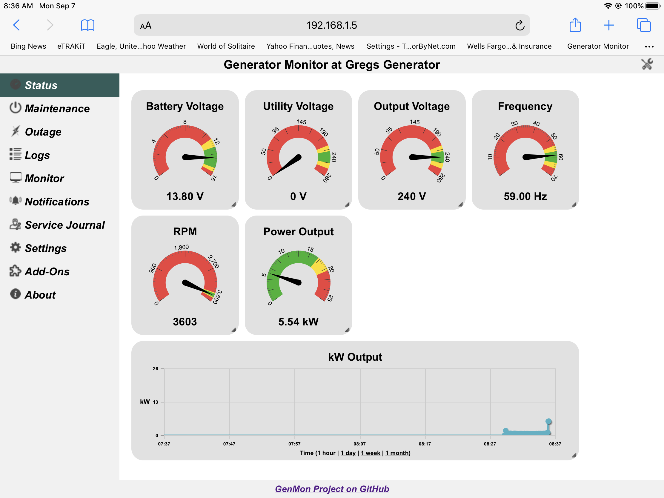

Just lost power about 15 minutes ago.....generator power supplied 15 seconds later. Not even interrupted my breakfast 08B59E06-75C6-40F1-8CC4-8AD7BEFD82E7.png

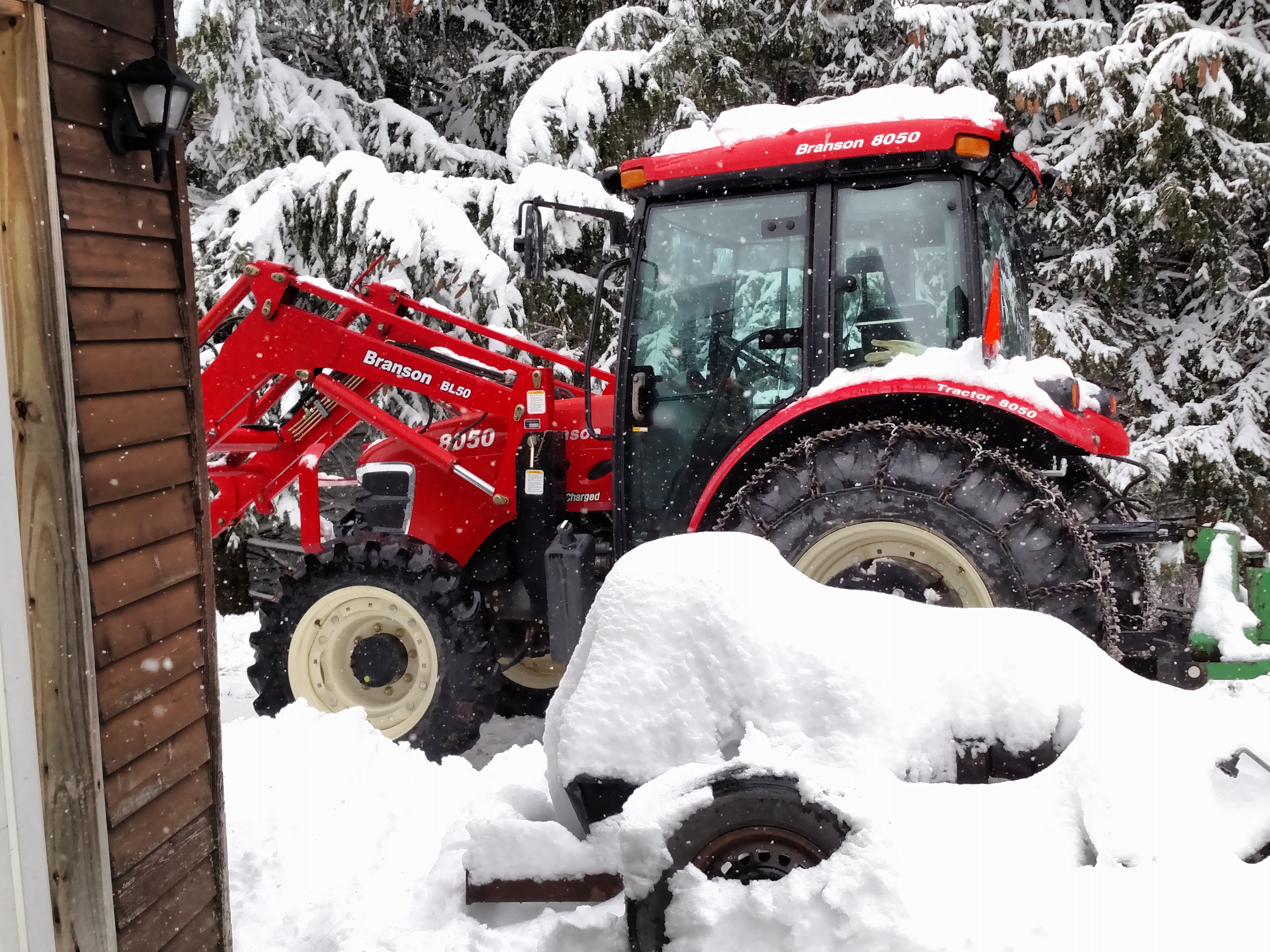

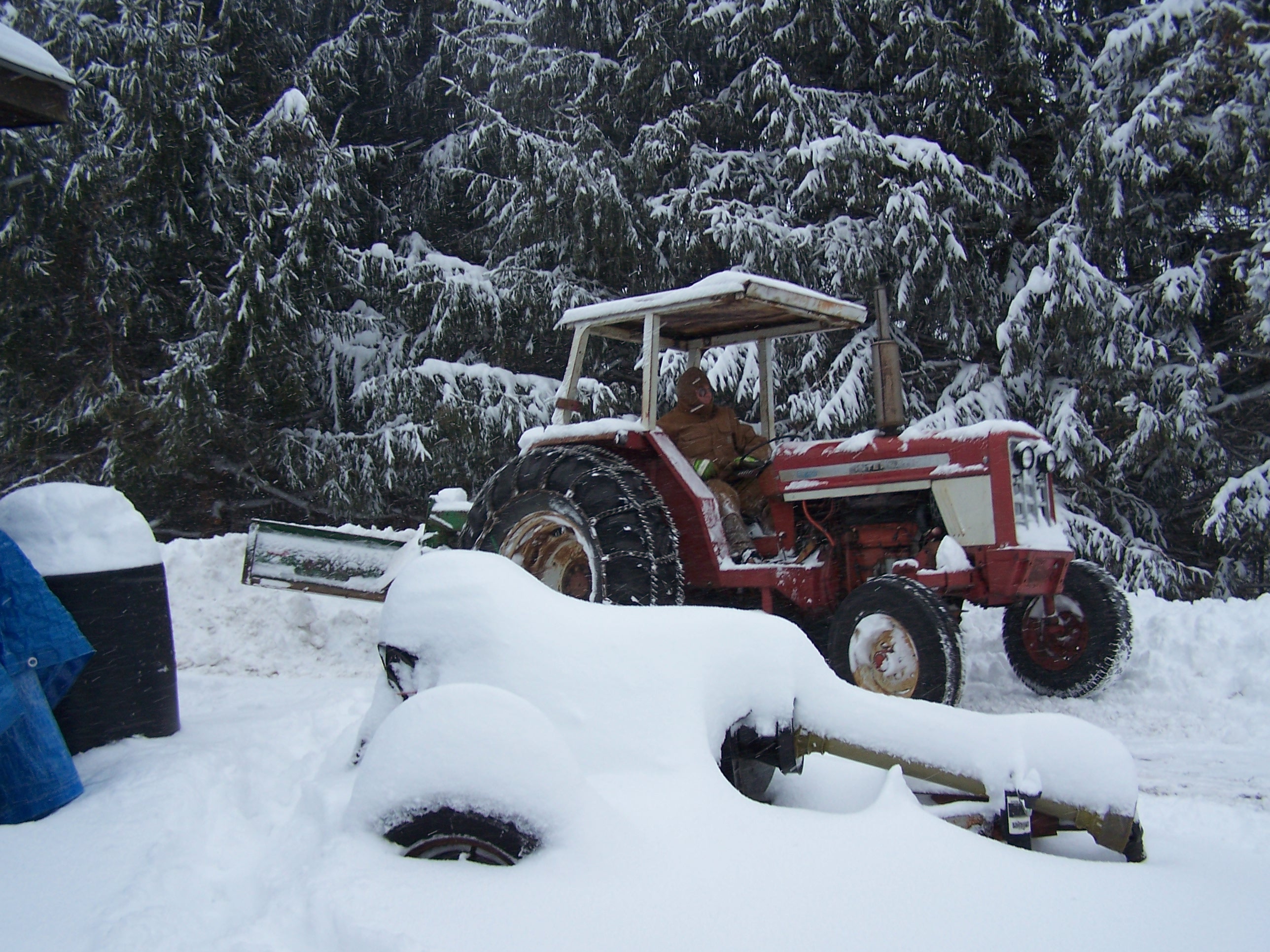

Was wondering with a PTO generator if they need to be sheltered from rain? Do they have to be covered? May someone using a PTO generator can chime in?
It would be nice to keep it under cover but then it takes more time to get to it when needed,
mine spends 90% of it's time parked right were it will be used.
I have run it without even dropping a draw pin in the trailer.
I do have a piece of heavy plastic that covers it,
I run it with that plastic in place most times.

Just lost power about 15 minutes ago.....generator power supplied 15 seconds later. Not even interrupted my breakfast View attachment 668943
That's a pretty nice readout. What are you using and can it be applied to the my generator with the Nexus controller?
