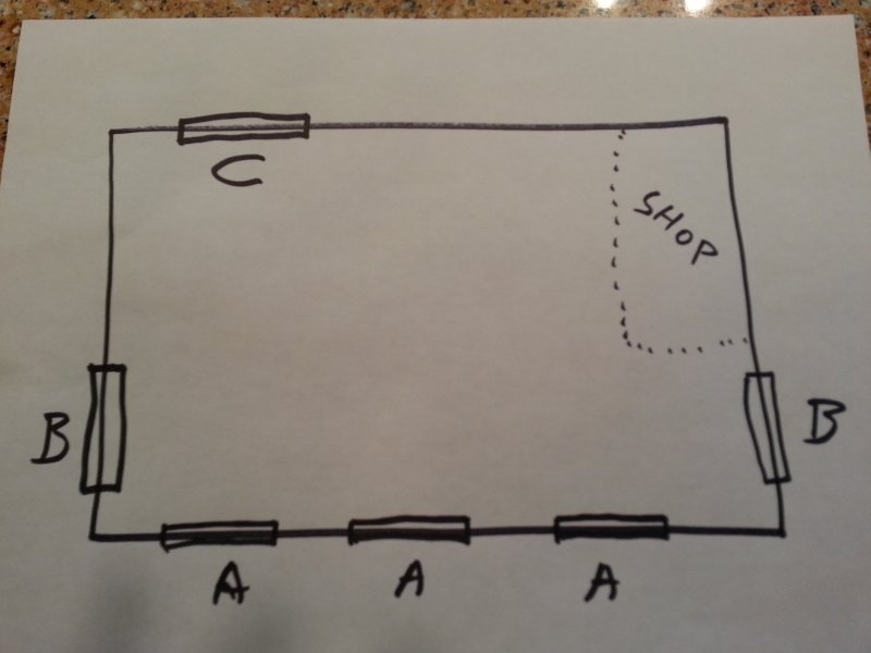

Just closed on a new property, need to build a barn, and I am looking for feedback (and an education) from y'all. I have some general questions first, and then I can start to develop a more detailed plan (and come back with more specific questions).
At my old place, I had a 25x40 open-sided metal building, with concrete slab. It had a 12x25 tuff-shed (workshop) up against one end. Both were great to have (they were already there), but I've learned I want more space. I'm thinking 40/or/48 by 60 or so, with a workshop inside. Here are some thoughts & questions, love to hear your feedback.
This will be in Brenham TX, where the cold is not much of a factor, but heat is. I can easily live without any heat, or just heat in the shop part. But must have good ventilation for summers. And I know you will ask, "what are you going to do with it?" It will be to store my tractors, attachments, tools, mower, gators, trailers, etc. Just general farm & ranch stuff. Pleasure farm, not working.
* Metal or wood? It seems metal buildings are preferred, and I'm ok with that. My only concern is I love to hang things from the walls, and organize stuff. It seems with wood studs that's pretty easy; not sure how metal framing affects my desire to over-organize.
* It seems many of you build an outside area, covered but not enclosed, as an extension of your barns. Why would I need that? What do you do with it?
* I love having a workshop. My plan is to build it inside the barn, wood framed, probably around 20x25. Deck the top, and make that storage.
* What height do I want? I have no specific requirements (ie, special equipment), but want to have room for most possibilities.
* I'm intending to have big overhead doors, plus at least one std entry-type door. I need the doors for both entry & ventilation. But I would also like to be able to drive thru. It's much easier to drive in with a trailer, unhitch, and drive out, rather than back in. (see attached drawing, not to scale) But I'm thinking it's better to add Door "C" so I can drive thru and exit "A", rather than attempt to add Doors "B" and drive that way.
I'm at the stage where I just need info to help me create a general layout. Once I have a size & layout down, I will sketch it out and come back with questions about all the details--lights & drains & elec & etc.
My budget is generous, but not unlimited. Feel free to respond to any part of this you have feedback on. I've attached a pic of my old barn setup, so y'all can see how I used it. Plus a rough, not-to-scale of a new one, mainly so I could ask about door layouts.

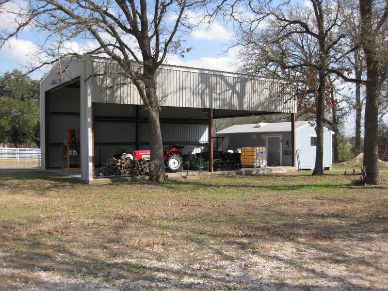

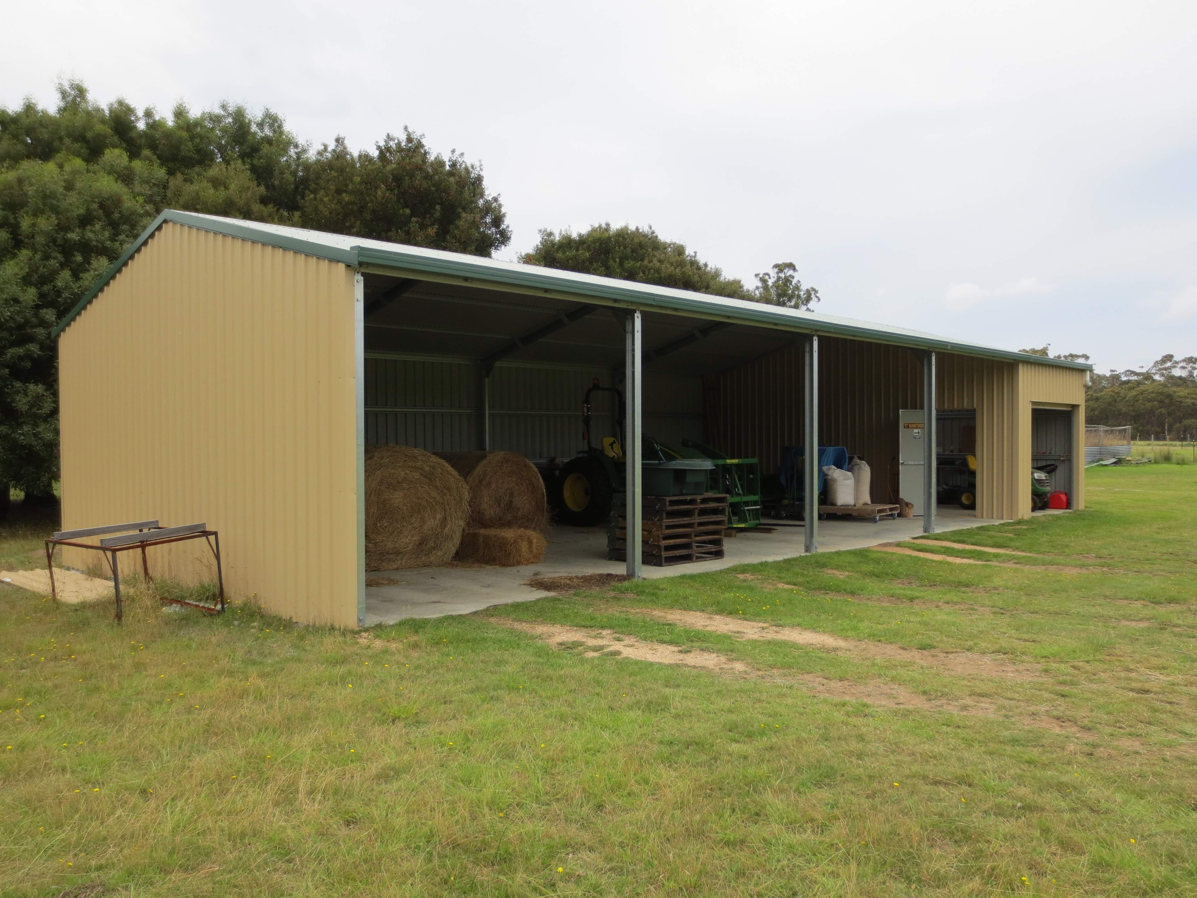

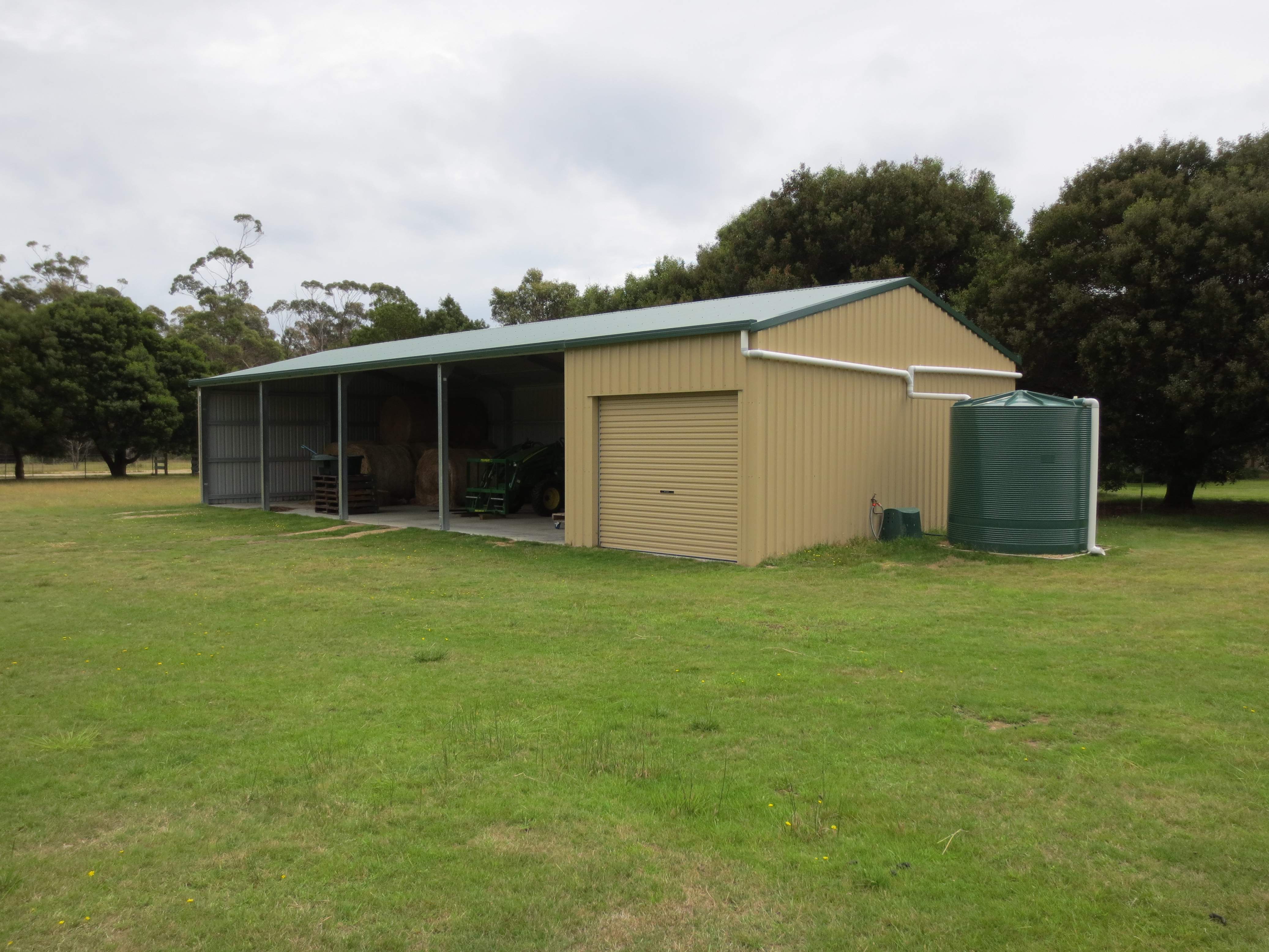

This is the shed that I had built. Its front is south facing to keep it cool and minimise sun damage. A clear roof panel in the workshop provides all the light that I need from the sun. Build it away from trees, taking into consideration future growth... shade is nice but potential tree damage repair is expensive. This shed is all metal 'colorbond', which is fairly standard now in Australia and the manufacturer is more than happy to plan additional roller doors. ($)
If you can afford it, a reenforced concrete slab floor is a must-have. Implements can then be mounted on wheeled pallets to easily manoeuvre them & store them out of the way.

Thanks Wagtail. Love that water collection system. I hadn't thought about one, but that's a great idea.

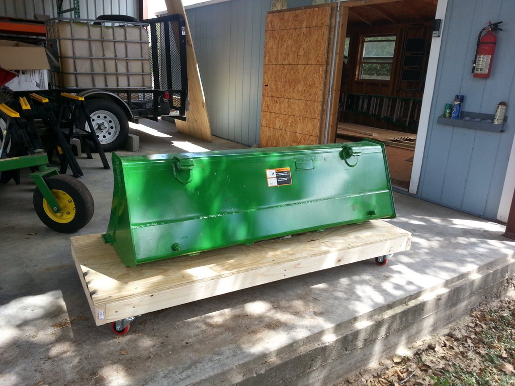

I plan on a concrete slab. And I have built dollies for most of my attachments. Here's one...

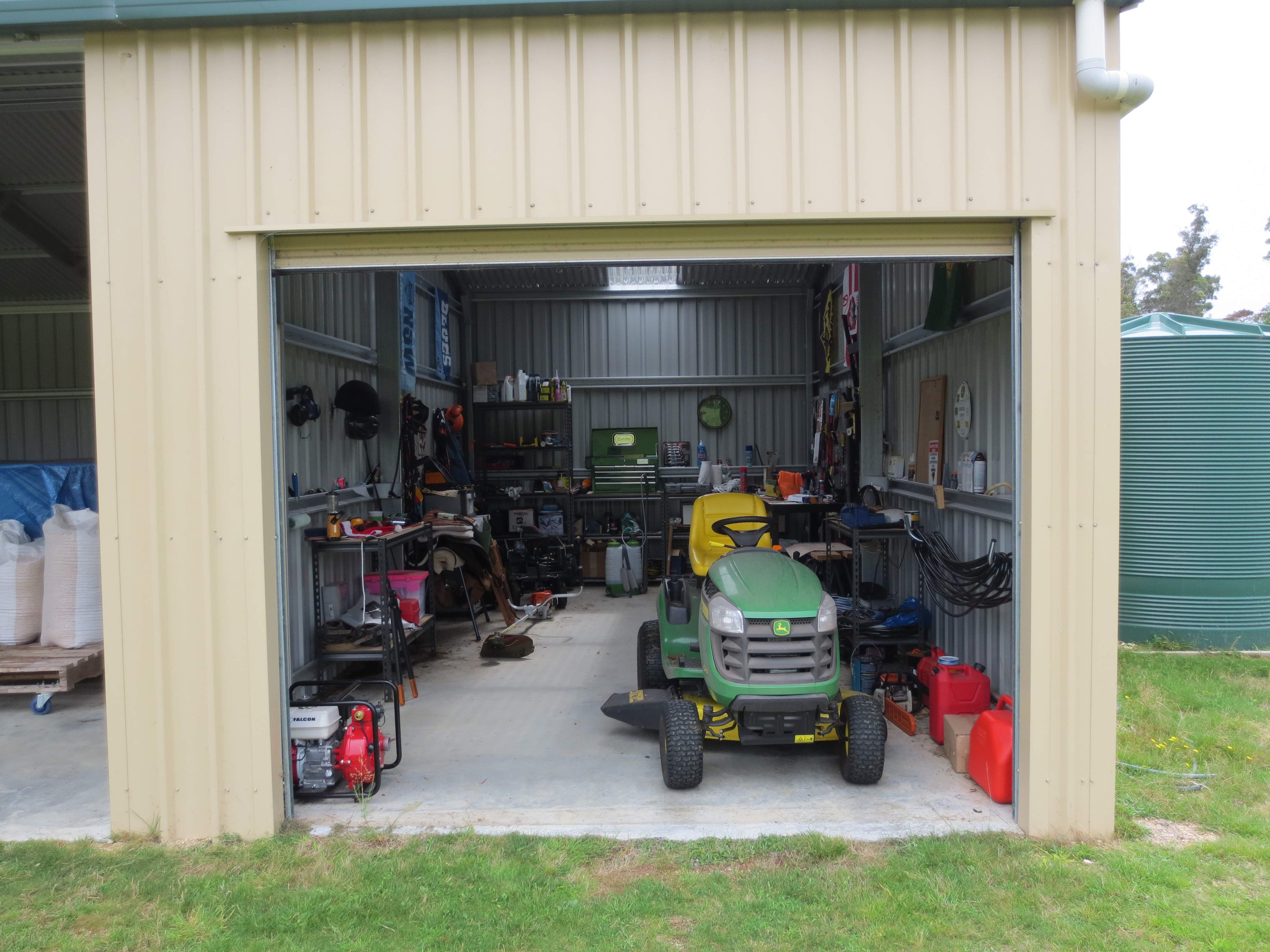

Ta for that astrohip. I'm not on 'town water' and would have included the tank in the plans anyway but the local Shire insisted on a water management system as part of their building approval. Which equals fees, fees & more fees leading to an increase of your property assessment 'cause you've made an improvement.
The water is used primarily to water the horses and, occasionally, to wash down the tractors when they get too dirty (when I can barely tell that they're JD green).
It's a 5000 litre tank and, just like a tractor, I should have gone bigger (10,000) but the one I got was on sale with the pump, delivered. Naturally, a month later they had a 10,000 litre package deal but it was too late by then.
Oh, I like the spray can rack. I'm going to nick that idea! :thumbsup:

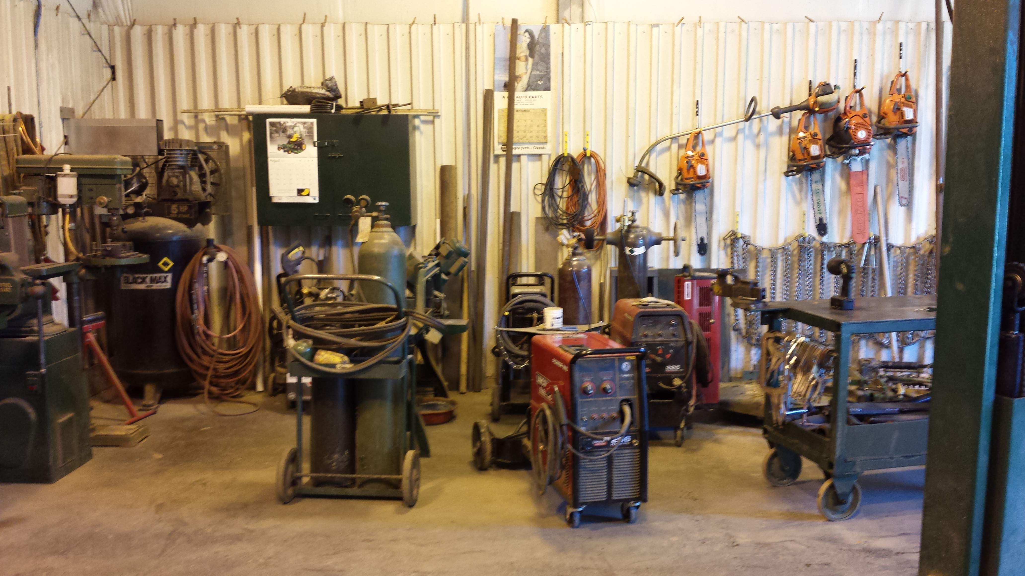

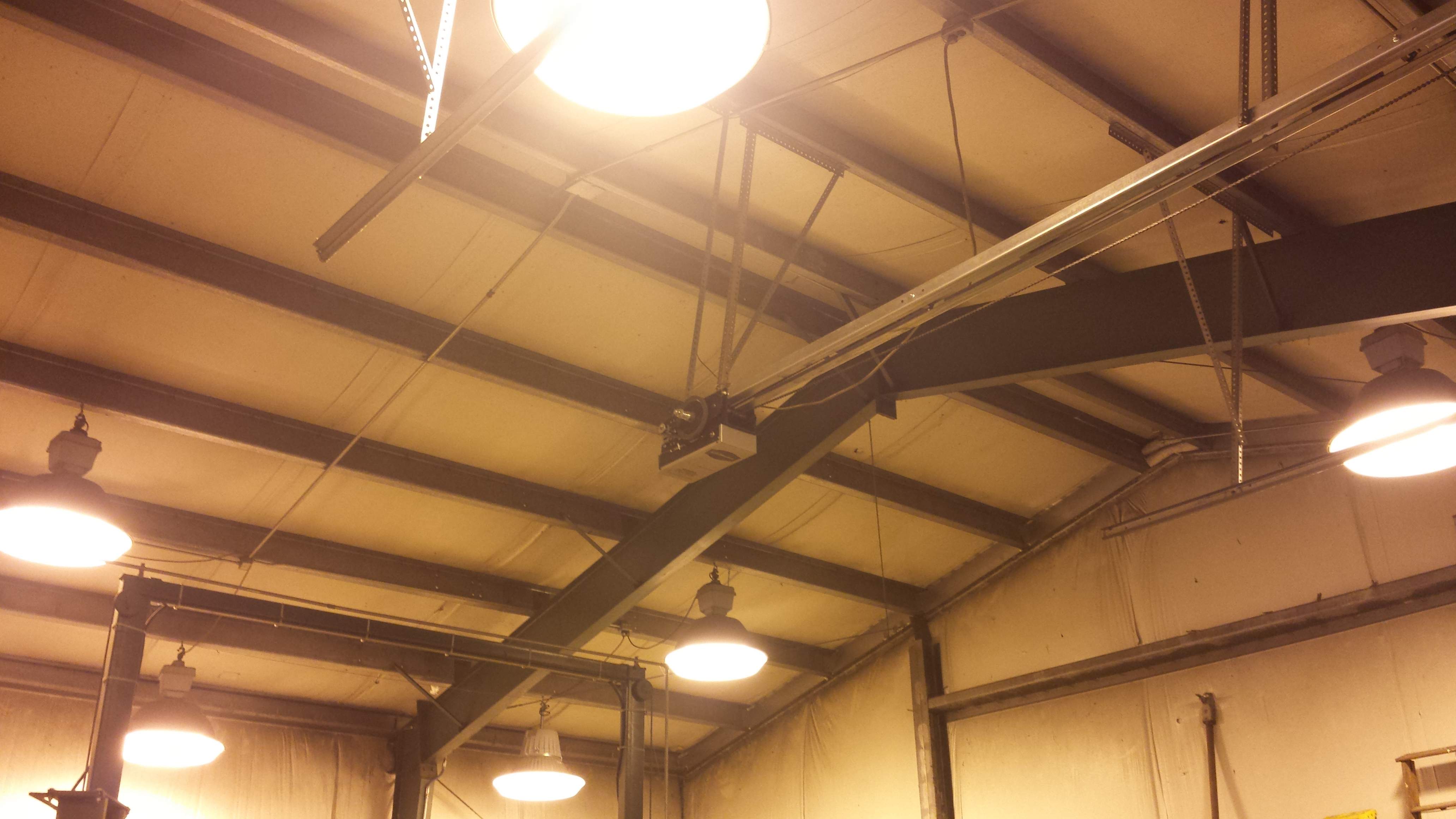

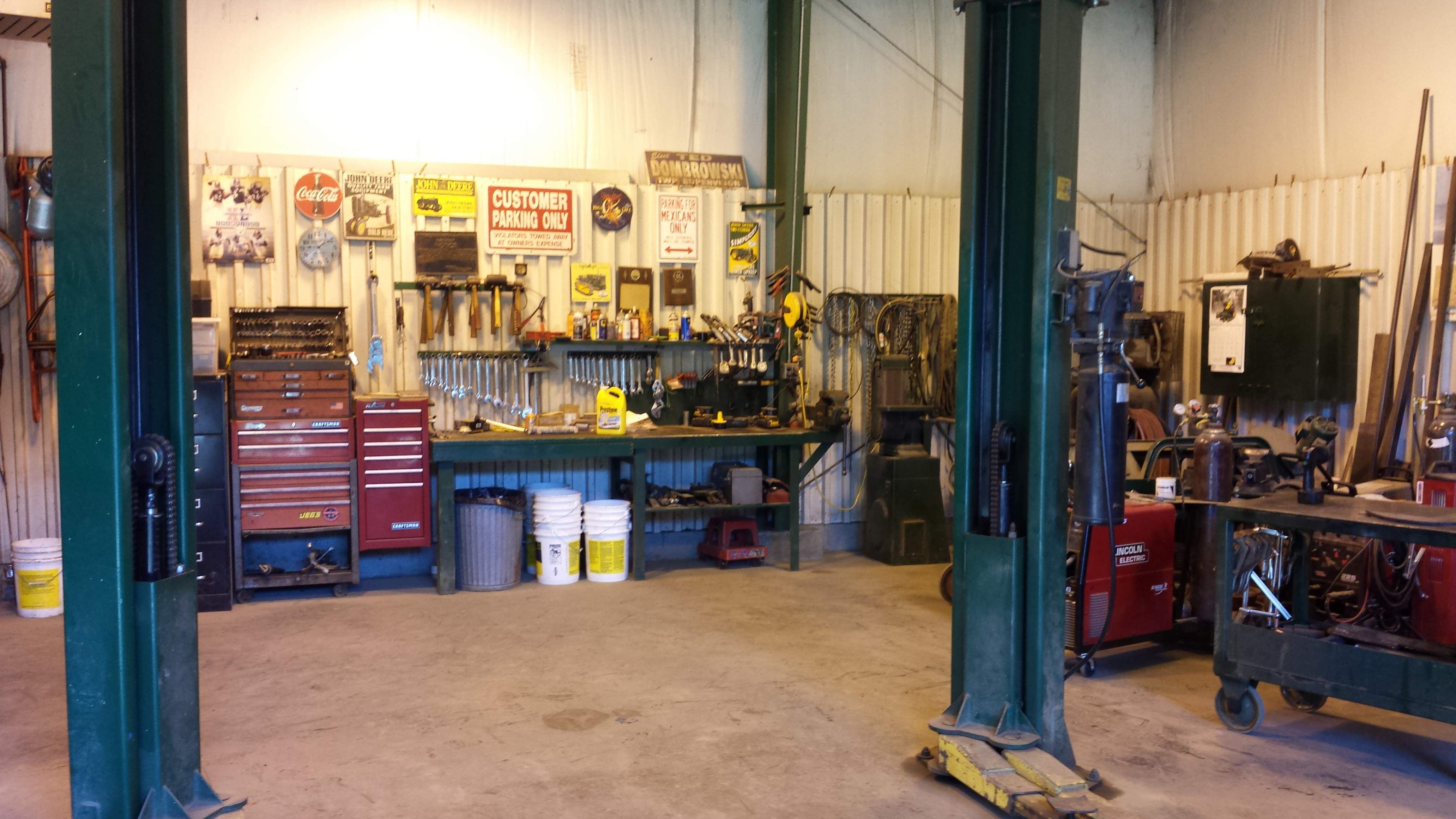

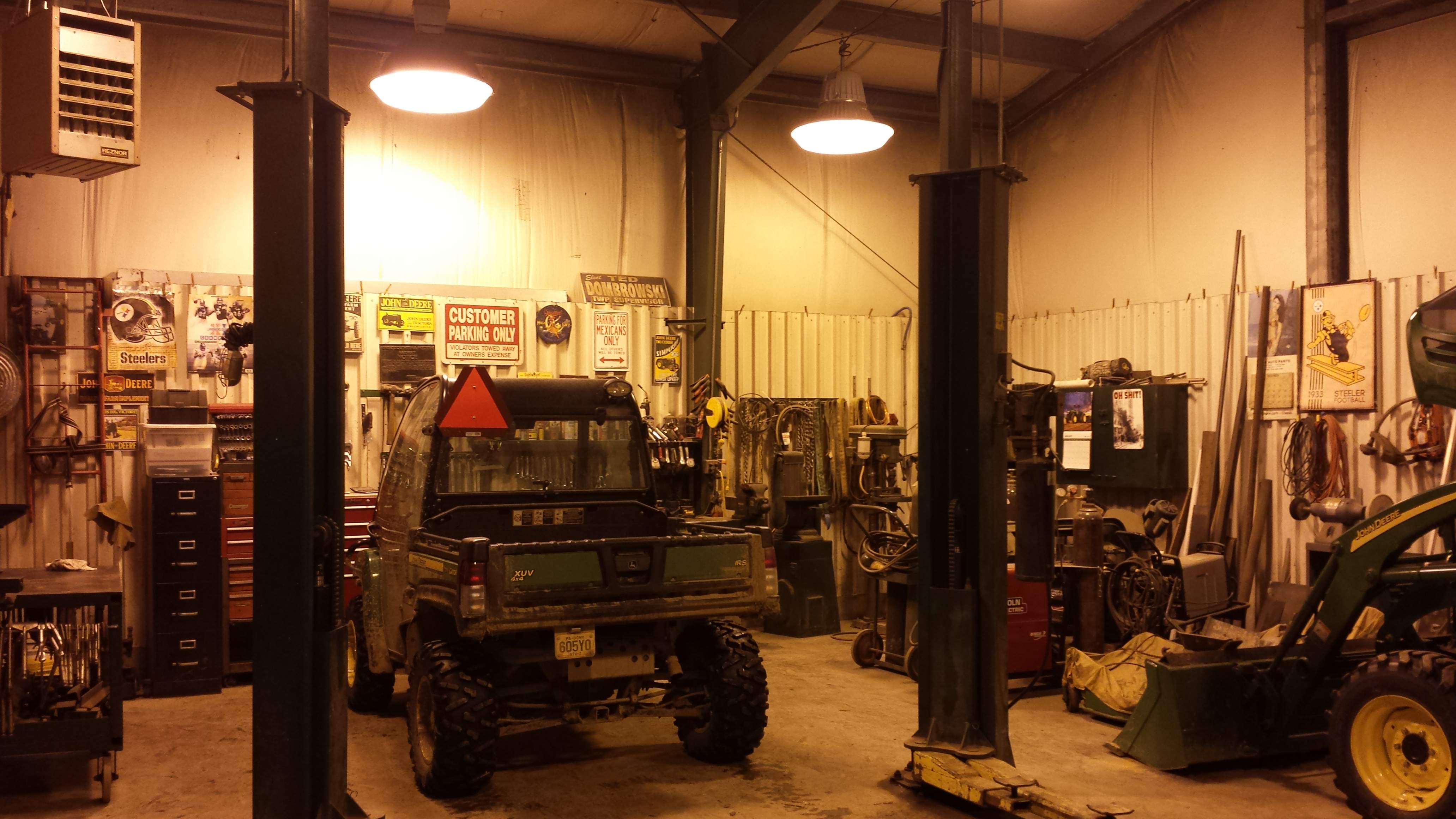

A couple pictures of my building, 40' x 60' steel clear span Sharron Steel Bldgs. 26 gage galvalume sheeting. Built 1991, 14' side walls 3-12 pitch 4' over hang 1.5' on gable ends. One exterior man door, one 12' x 12' garage door, one 14' X 12' slider door. Center partition wall with steel interior man door, steel galvanize purlins and girts Non expandable end walls, middle columns are 6 gage with a 18" section, single sided weld, 40' X 30' heated with 4.0" reinforced concrete with wire and 1.0 insulation board and 40' X 30' not heated with gravel floor, 6" x 72" rolled insulation with reinforced poly in heated side, 2" in non heated side, 100,000 BTU Reznor, heater, original gutters gone due to ice. 200 amp dedicated service all electrics in conduit. Water is piggy backed from my home. Cost in 1991 dollars $40K. High pressure sodium lights 400 watts $800 used, interior walls are steel roof decking 22 gage approx. $900. Plus a lot of other incidentals and toys.
One of your questions concerned hanging shelves and or any thing from the interior walls of a steel build. The roof decking could not have been a better fit for my interior walls. I put down another base angle and the roof decking is screwed between the middle girt and the new bottom base angle, they are 8' and 9' high respectively. I painted it bright white when initially installed but 24 years later it is starting to show it's age. I have done a lot of arcing and sparking inside my building. I use self drilling screws to attach anything to the walls. .31 hex. The green shelving is attached to the walls with the SD screws. The bottom edge of the shelving just catches the 10 block for vertical support. I can sweep under all of the shelving. Non of the shelving is sitting on the floor. Everything else show on the walls is fully supported by the roof decking, the bottom base angle and the middle girt. I have been buying the garden hose brackets from HF cutting them in half and screwing them to the walls the with the SD screws. They make excellent hooks. I have a one block exposure, 10" block, on a separate footer, between the column piers. The concrete floor on the heated side is also pined to that block. Maybe this will give you some ideas. Later.20140927_122952.jpg20140917_093644.jpg20140917_093707.jpg20140917_093728.jpg20150124_163422.jpg20150124_163518.jpg20140506_172404.jpg

Rustyiron -- good points (on use vs design). In reading y'alls comments, I've been thinking about making a larger "under cover but not totally enclosed" area, for as you say, tractors & implements. Which is about half of what I store. Maybe a hard pack floor, with a roof and a back wall. Depends on what slabs cost these days, that may drop the price, give me a place for outdoor equip, and free up a lot of the barn. Need to do some thinking, esp about how much to spend.
Appreciate all the feedback on the heat, from you fellow Texans. Right now I have a one wall structure, so I get a good breeze (when there is one). Need to think about the heat aspect. Fans maybe, like Big *** Fans, or maybe wall fans, to try to keep air moving. That and good design, with doors that allow breezes.
