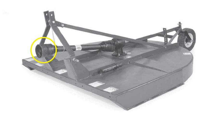

This is what the boot area on mine is like. You can see how the boot is longer than the connection. Just makes it real difficult. Maybe not cut that boot entirely off, but several inches back so I can see and manipulate the u-joint and collar connector?
I can't have the PTO running and be out of the seat. I can't think of any good reason for me (or anyone) to ever be anywhere near the rear of the tractor with the PTO engaged. This is the only shaft-driven attachment I have though - maybe a log splitter or something else I guess there could be a reason for someone to be somewhat near that area.

3) you're just going to have to make a judgement call on trimming the inconvenient plastic PTO shaft cover. Tractor and implement manufacturers all need to cover their butts for liability that sometimes they make things super inconvenient for the user. Assess what works for you and be cognizant of what you're doing, balancing safety with convenience.

Another trick when you're about to give up is to take a bungee cord and hang the shaft from the top link so that it's a "straight on" connection. Not having to hold the weight of it makes it easier to twist, turn, pull, slide, push, pop, spin, etc...as required.

Regarding PTO shaft hook-up, Bare PTO shaft guards are great in this regard. I had to buy a new PTO shaft for my bush hog and I got one of their shafts w/this guard. Also makes it a lot easier to grease.

I leave about a 8-12 inch gap, hook up the PTO, then back up to the 3pt hitch. Test how far out your shaft will come before separation, then leave less gap.

I've only had "difficult connects" a couple of times. After you have pulled, shoved, grunted & pushed - sometimes a good scream helps.
NO - without exception, those times when it seems like it will never "connect" - its because of improper alignment between the shaft and the PTO stub. And it does not take very much "miss alignment" to cause a failed connection. And the fact that your arms are about to drop off trying to hold up a heavy PTO shaft doesn't help either.
I ALWAYS connect the pto shaft to the tractor stub first - I have the most energy and its the most confined connection. The "shaft to implement" connect is the easier of the two because its out in the open.

I loop a bungie cord around the top link and the PTO shaft. With the right length cord it takes the weight of the shaft so all you have to do is line it up. I got that trick from someone here.
