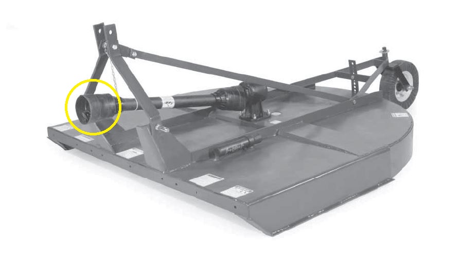

This is what the boot area on mine is like. You can see how the boot is longer than the connection. Just makes it real difficult. Maybe not cut that boot entirely off, but several inches back so I can see and manipulate the u-joint and collar connector?

If the "bell" of the plastic is protruding past the end of the PTO universal joint, then by all means move it back so you can access the PTO to hook it up. This can either be done by trimming with a knife or perhaps it just needs to be slide back on the PTO shaft a bit. It should never extend past the end of the universal joint.
