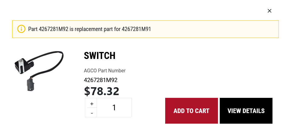

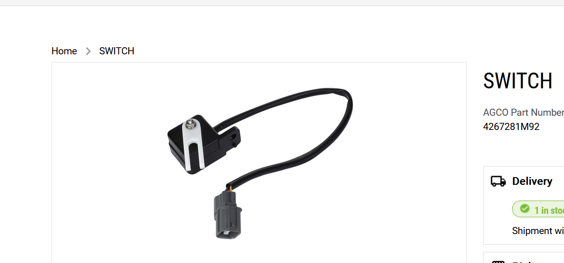

I have a 2014 GC1715 that needs a lot of work. It appears that the Range Neutral Switch is missing. Does anybody have a picture of the switch installed on a 1715 for reference? Also very curious in the connector as the original looks like a 2 wire, but the substitution on the AGCO website looks like a 4 wire. I believe mine only has 2 wires if I'm looking at the right thing (it's messy and modified).

for gc1715 should be part number 4267281M92 (replaces 4267281M91) and is 2 wire.
same switch my 2010 GC2400 takes and its what I bought when mine broke. that little nylon arm easy to break when old, gets brittle.
edit: you will have to modify new one with weather proof connectors if you can't find one that fits switch.

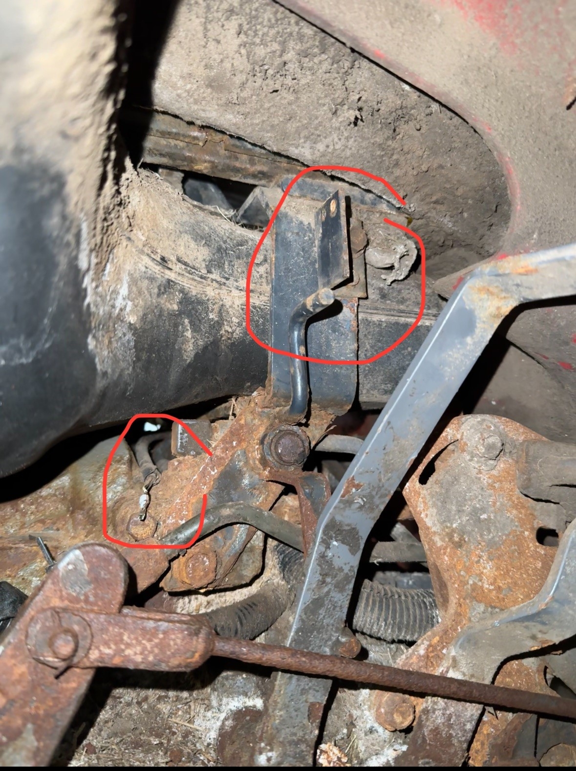

Finally got out there to take some pictures of the 1720 , hope this helps.
/ GC1715 Neutral Switch #13
your connector easy to get at, mine was stuffed under fuel tank and was PITA to get at.
iirc I saved the old switch (I superglued it into neutral position while waiting on new one) and if I get chance today I will verify if neutral is open.

My estimation looking at wiring diagram is that both neutral safety switch (22) and PTO switch (21) has to be closed circuit to operate the starter relay (23) which is not in diagram... Again its a guess from poorly done wiring diagram in owners manual/shop manual...
Correct! I used jumpers to bypass the switches and it started up.
Thank you all for your help. Now it's on to the next problem...
