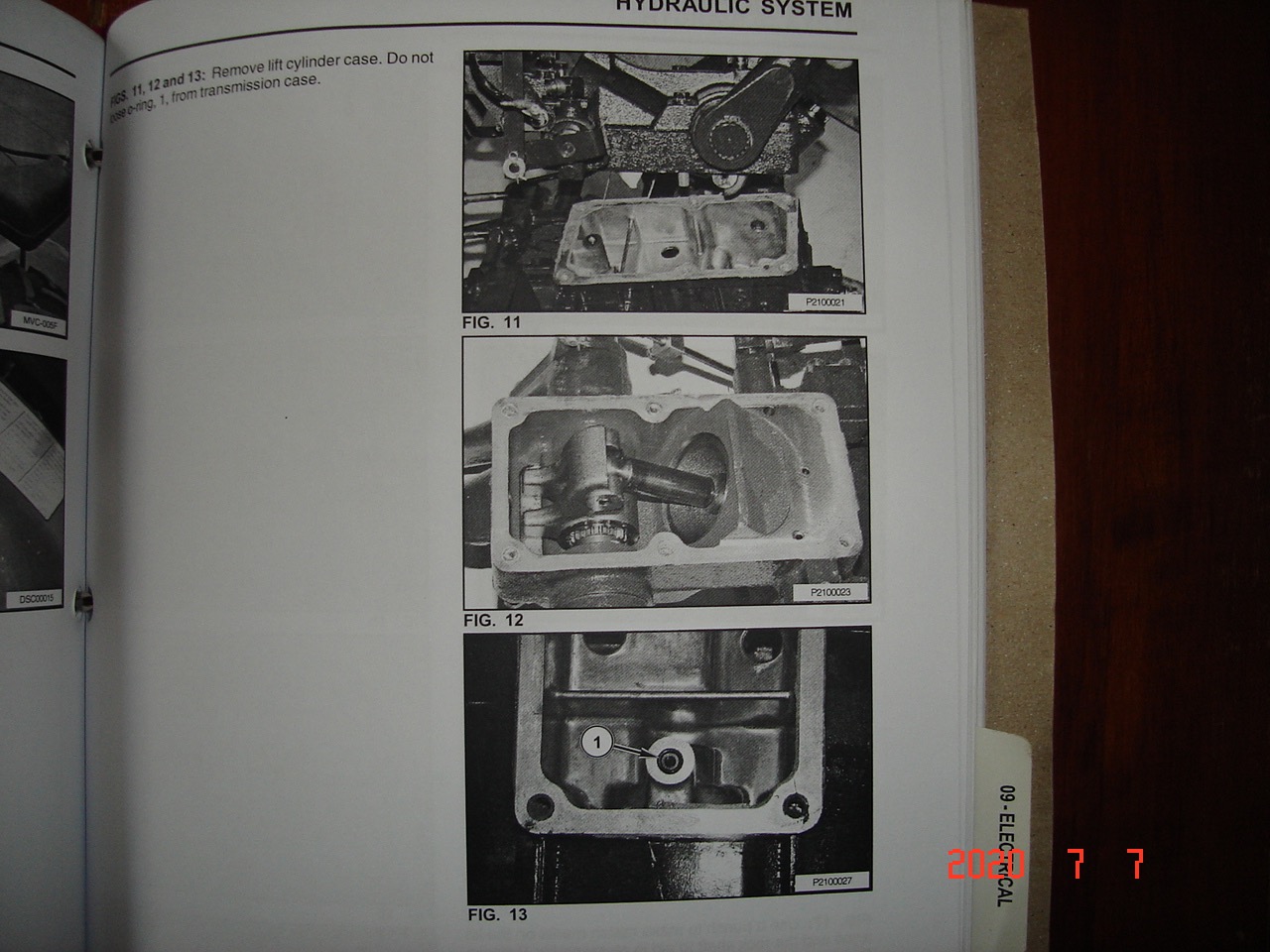

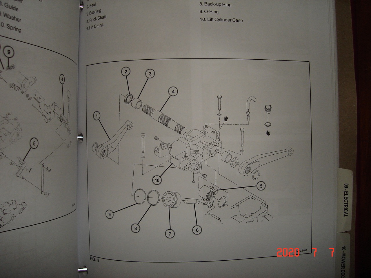

Thanks guys!!! ok it appears to be the 3 pt cylinder seal the tractor will drive I removed all the accessories and pulled the back off the pump; the gears splines and gears looked perfect compared to the last pump I pulled off. the fellow I talked to said if I could lift the3 point with no resistance then my seal was shot so I did and It is .
SO the diagram for the 3 pt cylinder would be appreciated if anyone has a good illustration.
