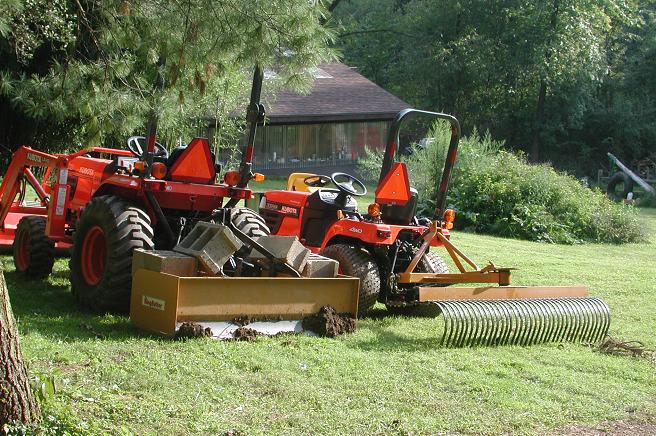

So anyway, I figure that if I last summer had had a MMM I would still only have one tractor and my BX would be parked in someones else's shed. I ended up trading in my almost unused RFM towards the BX, rather than buying the MMM for the B2910. I thought at the time [and still do] that it would be nice to have the BX ready to go when I wanted to cut grass, and also to have it available to do things like pull a cart or whatever else I might want, without having to change over my B2910 [read take off the back hoe, or box blade, or whatever].
I further rationalized the purchase by telling myself that hours on the bx would be hours not on the B2910, and therefore both would last longer! That is still true too...
Am I happy I got the BX? Yes. The possibility of a little snow blower on it has entered my mind already...it is the season for visions of snowblowers to be popping into my head...or so it seems...but for around Pittsburgh that is something that you wish for occasionally every ten years or so it seems...wished for one this year and last though... /forums/images/graemlins/shocked.gif
But back to the question! My B2910 rear tires are liquid filled and my fronts are foam filled. They are R4 tires. They do dig into the yard a little when the ground is soft. Your turfs will be better. If you have a yard, I will bet the B7800 with MMM would cut it just fine. Get the widest deck you can so you can get close to things.
In answer to your question, do you want a BX little sister for your B7800?
Of course you do! /forums/images/graemlins/grin.gif
See attachment... /forums/images/graemlins/blush.gif
