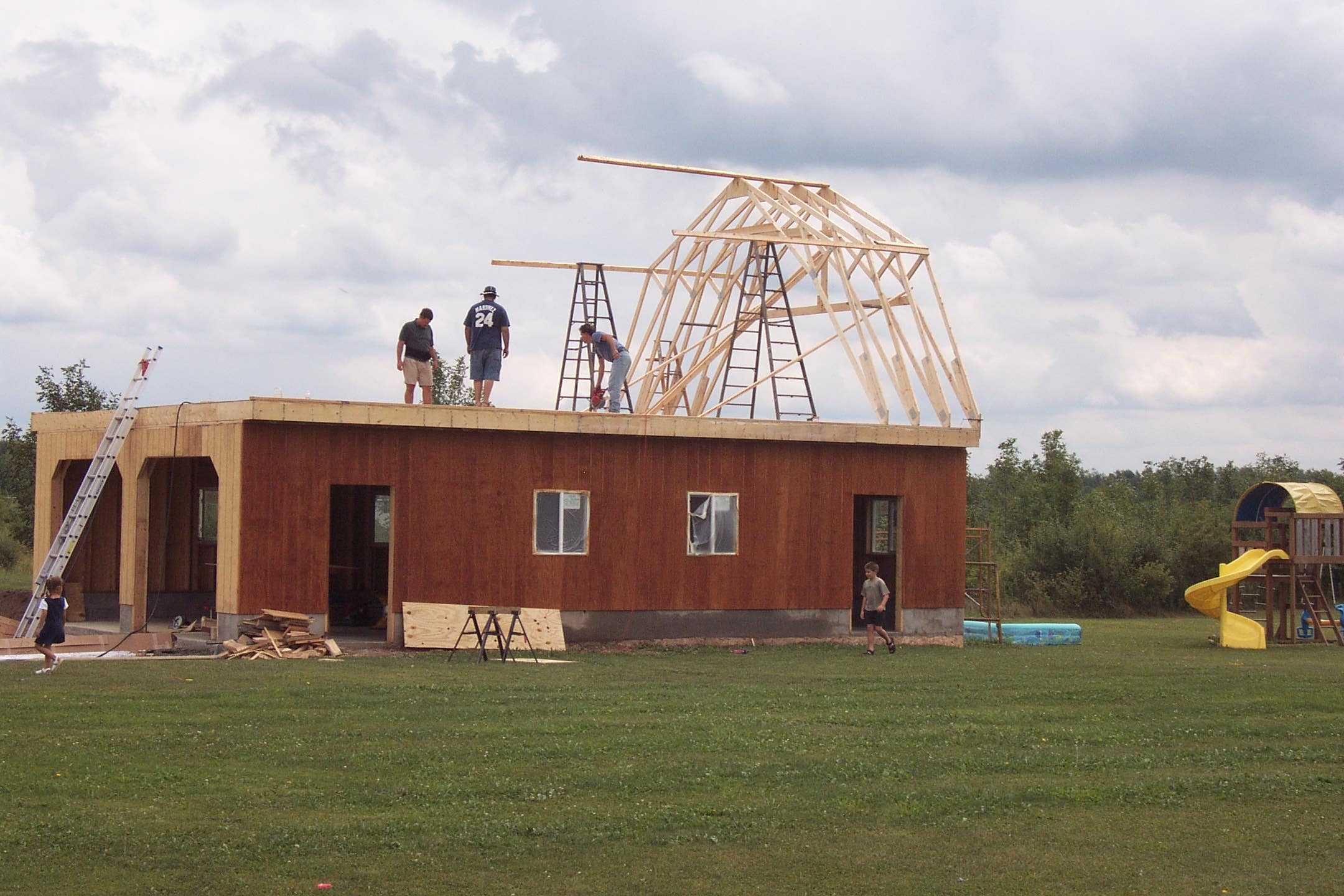

I used a double scissor truss wtih a plate and collar tie at the top. It's about 11 foot the the bottem of the collar tie. I also have a 40foot 10inch steel I beam down the center to support the floor without any posts.

Hate to say this but you are going to have to frame the second floor before you put the rafters up. That is unless the trusses are going all the way to the ground. The reason for this is that the second floor joists also tie the side walls in. The load from the roof has a natural tendency to push the side walls out. So you either have to design some sort of wall tie system or frame the second floor.
Yea the more I though about, you guys are right. I would either have to have a bottom cord to keep the roof from pushing the wall out. Or build a whole second floor.
