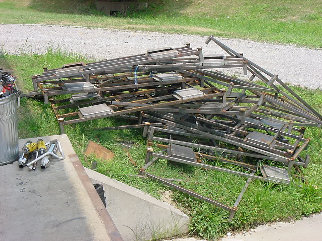

harv-I have seen many of your posts and have an appreciation for metal work too. Since you mentioned square tubing earlier I thought I would send you a picture. I don't know if this would interest you, but I pay people to haul this away. You local Yamaha dealer should have the same thing. SOME models come in these crates and I find it useful for many things. I have made about 15 workbenches out of it for the cost of some wire and Argon. Only U.S. models come in the good crates, Japanese model crates are pretty worthless metal.

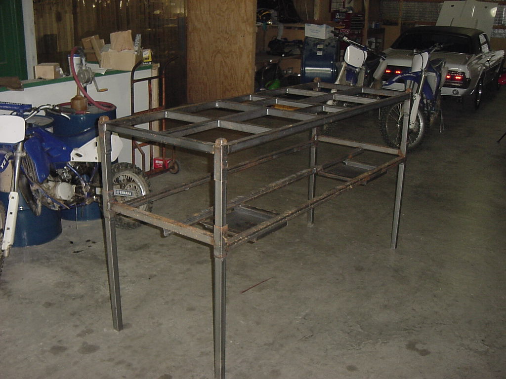

Here is a picture of a bench (finished version will have a top and straight leg). The steel is about 1/16th inch thick, 1 inch square tubing. Not as sturdy as what you like, but it is free.

That's a nice looking bench. And I'm with you when it comes to things being free means they're worth ten times the price.
Actually most of the stuff I do is on someone elses nickle. So the cost of new is less than the cost of me cutting around and putting together used.
But I'm sure there are a bunch of guys here on the forum that are going to be visiting their Yamaha dealer this weekend.
That stuff is great for a lot of projects and it's perfect for practicing mig welding. Thanks for the tip.
