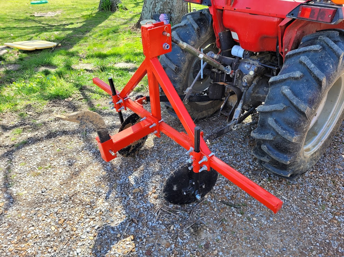

Yeah, you can use grade 8 or whatever you think you need. I just made what was needed using some grade whoknows 1/2" bolts and some scrap pieces of 1/4" diamond plate to make the brackets. It's what I had in the shop, and is plenty tough enough. Welded the pipe to a 3"x5" piece of plate, and cut 4 pieces of the plate into
1 1/2"x5" straps. Maybe this picture shows the brackets better. I did use u-bolts similar to what you show for the cultivator shank mounted on the 3 point upright. Again, more than strong enough for the application. Hope this helps.
Edit: I need to correct some dimensions from my earlier post. The hiller crossbar was fabbed to 44" to fit inside the 48" footprint of my old 50 8N. I now have a 66 1020. It has a 5' center tread to center tread width. In both instances, the width of the hiller to tread width allows for cultivating the rows. Important for weed control, and in potatoes hilling or laying up in the rows. You're driving on an established tire track which is easier to keep 3 point tools on track and not digging up crops.

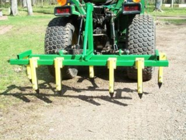

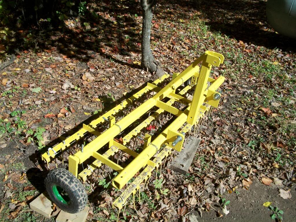

A number of years ago I built two 3pt tool holder frames.. And a number of attachments for the frames.. It worked well..
First... At the location where you want the hole, drill a small hole first.. A hole about the size of the center tip of the drill.. A pilot hole, 1/8 or 3/16" will make it easier to drill the full size hole on location and to size easier..
Use drills the size of the hole you need.. For instance, for a 3/4 " hole, use a 3/4" drill.. It will usually be big enough to let a pin through..
The trick is in lining up the holes to get the pin through 2 tabs..

WOW, that chisel plow you made can be very universal. Unbolt the chisels and then add in the discs for a garden hiller. Really nice work. I love it! That's a keeper to pattern from. Thanks a whole bunch!

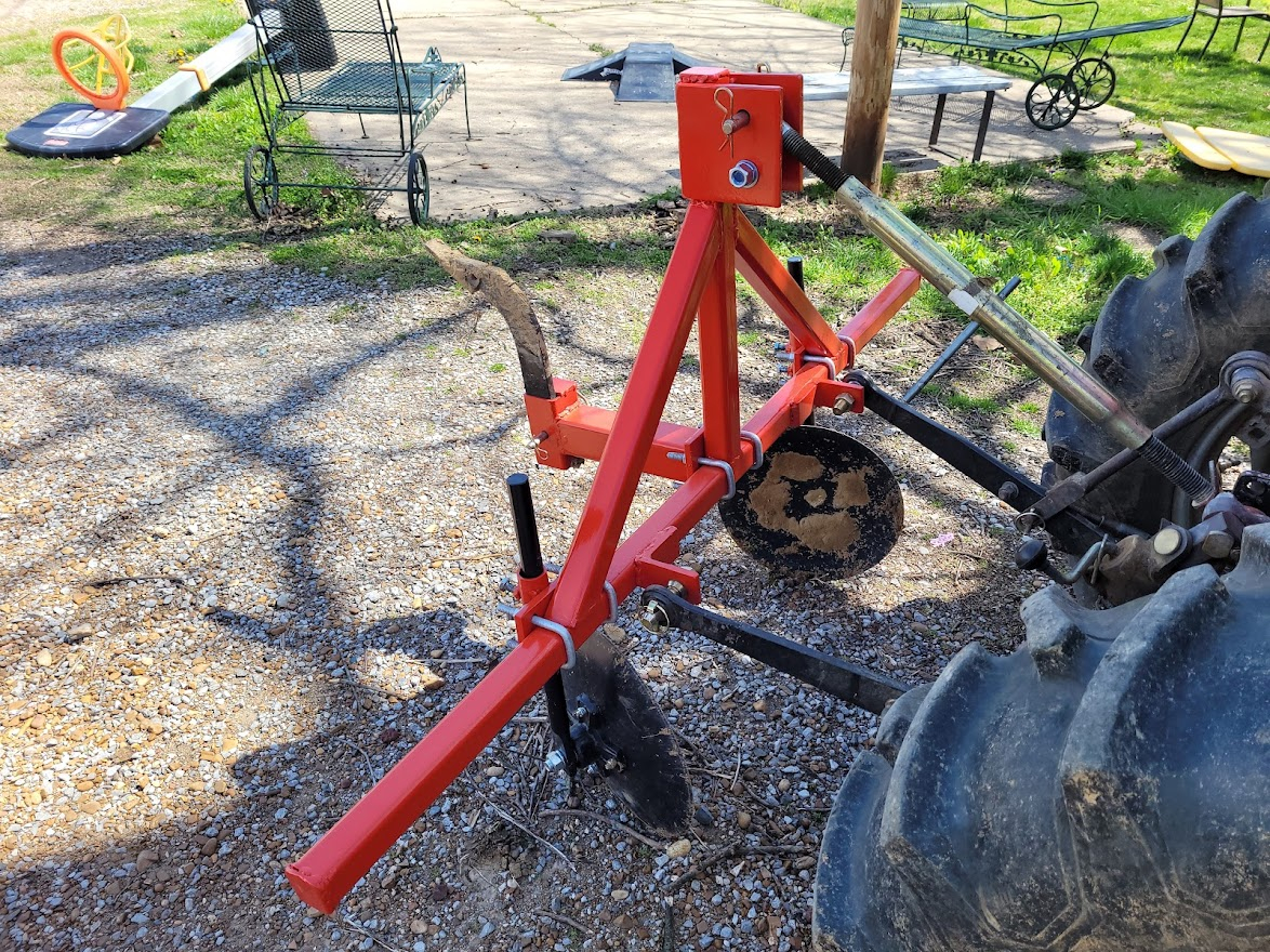

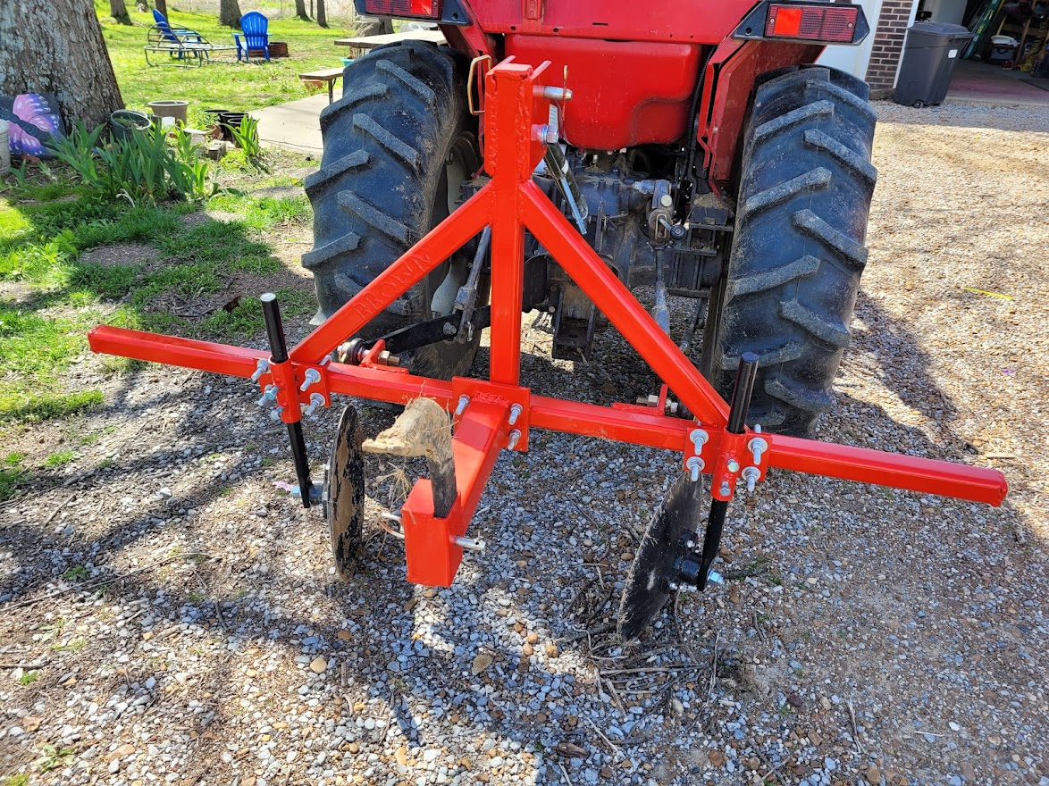

Got it made! I've already used it to hill up my mounds in the garden, and planted potatoes with it. The ripper shank makes a nice little furrow, might add a small sweep onto it to get a little wider, and I can just flip it over out of the way when I make a pass to cover up the potatoes. Ripper shank also makes a nice support to keep it standing up when not in use. Very very handy thing to have! I think I may get some clamp-on S-tines and use it as a cultivator as well this summer on sunflower fields.
Steel - $200
U-bolts and pins - $40
Hiller disks, 2 ea - $130
2"x2" square tube is 1/4" thick
Plates/flats are 1/2" (probably overkill)
Angle for lower pins is 1/2"
U-bolts are all 1/2" diameter
