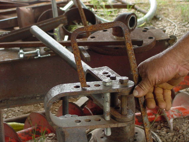

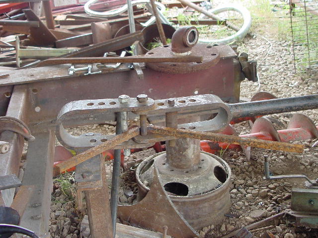

Harv, can you use a larger jig for bending 2 inch tubing, or does tubing that large require heating to get a good bend ? I want to make a canopy/FOPS for my tractor, and was wondering if I could bend the tubing for the front bar, or would it be easier just to weld the pieces together. The roll bar already on the tractor is bent, but I noticed the inner parts of the bends appear to be crimped.
/ Fun with square tubing too #28
Springback.....
Harv, do you have to 'over' bend to compensate for springback? Or is that minimal? Also, what's the largest square cross section you've bent? Do you have a feel for how much wall thickness impacts deforming of the side walls?

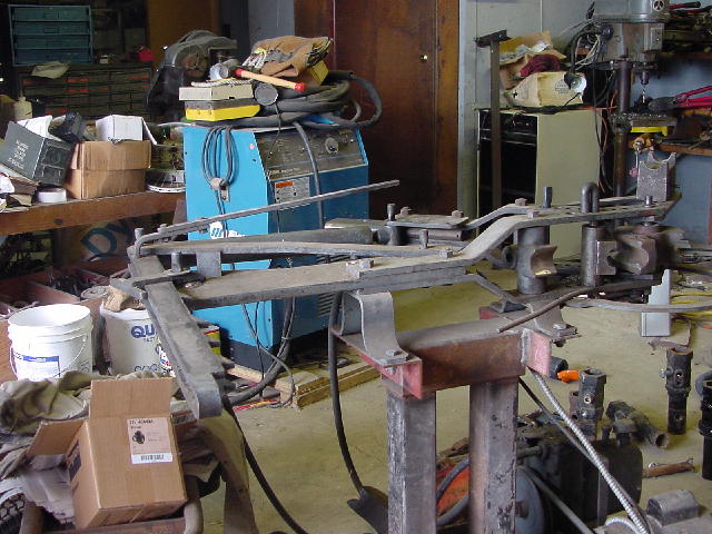

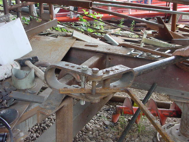

Harv, did you build Miss Hossfield or is she a commercial product? I would like ot see more pictures of her.
Thanks,
/ Fun with square tubing too #31
HARV,
is that a #1, or #2 hossfeld bender? you sure have got a lot
of good stuff. all of that scrap iron is worth a lot.
accordionman
william l. brown
#33
<font color=blue>Harv, did you build Miss Hossfield or is she a commercial product?</font color=blue>
Evening Don,
Go Williams Lowbuck Tools also carries the Hossfield bender.
I picked mine up for seven and a half as is from an ad in the paper. I was about as lucky as winning the lottery.
But you might keep and eye open at the high school surplus shop equipment auctions. I once picked up a Number One Hossfield complete with all the dies and the trick storage box stand combination. It was a sealed bid deally do and I got it for a hundred and fifty three dollars. Again, luck, you gotta have it.
I use my Hossfield at least once a weak. I bend pipe, bar, round stock, angle iron etc. It's better than the bank owing you money.
