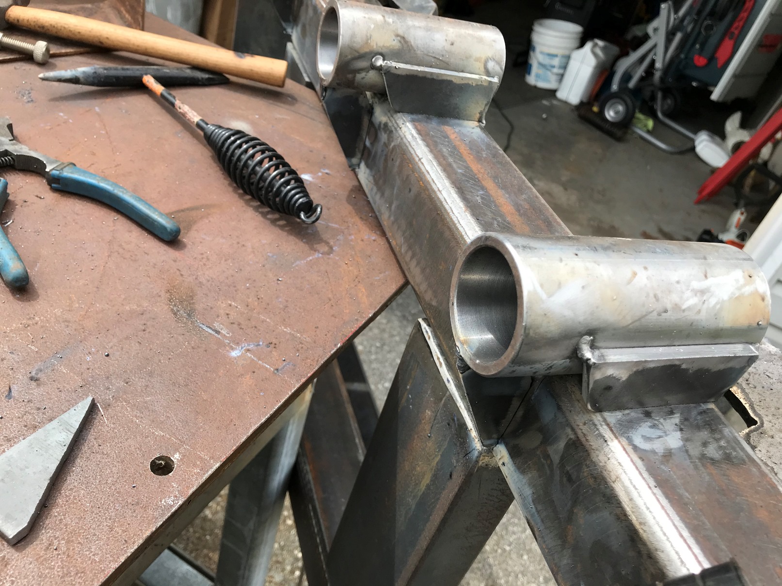

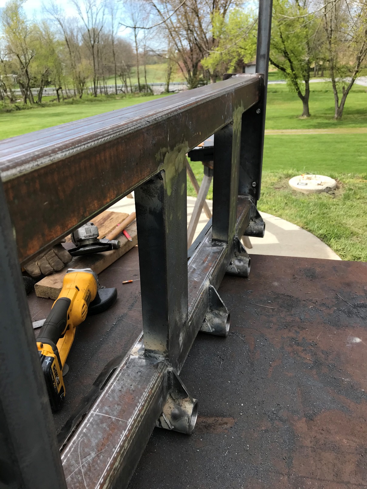

I do use brush forks fairly often and it didn't take long to miss them. Since the L4240 has a QA bucket, these forks will be on a QA frame. A few months ago there was a super heavy duty frame on FB Marketplace for a reasonable price. Yesterday the project was started. Nothing will happen today, but this coming week should be productive. I'm in the middle of restoring another Caroni RFM, but the need for the forks is greater, so the deck was put on the saw horses in the background. The 5' RFM will just be for backup, rough stuff, trimming or fun on the Ford.

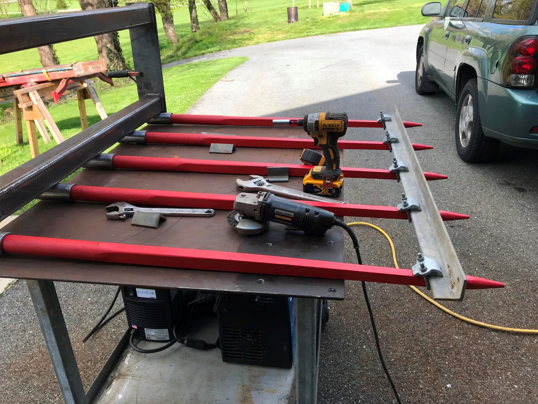

Here's the start. Had to remove the vise from the welding table to get a nice surface for everything to fit. Bale spears (48") were chosen because they are strong and can be replaced easily if they would get damaged. The pieces shown are all tacked and ready for welding. Two pieces of channel will be added between the top and bottom horizontal tubes for added strength. Gussets will be welded between the spear bushings and the bottom tube. I'll add a slotted angle on the top tube for chains. There will be a headache rack to keep the brush from rolling off the back. It will be bolt-on for easier repairs if damaged. Still need to come up with some loops or some method of being able to attach a rope or binder for that odd load.

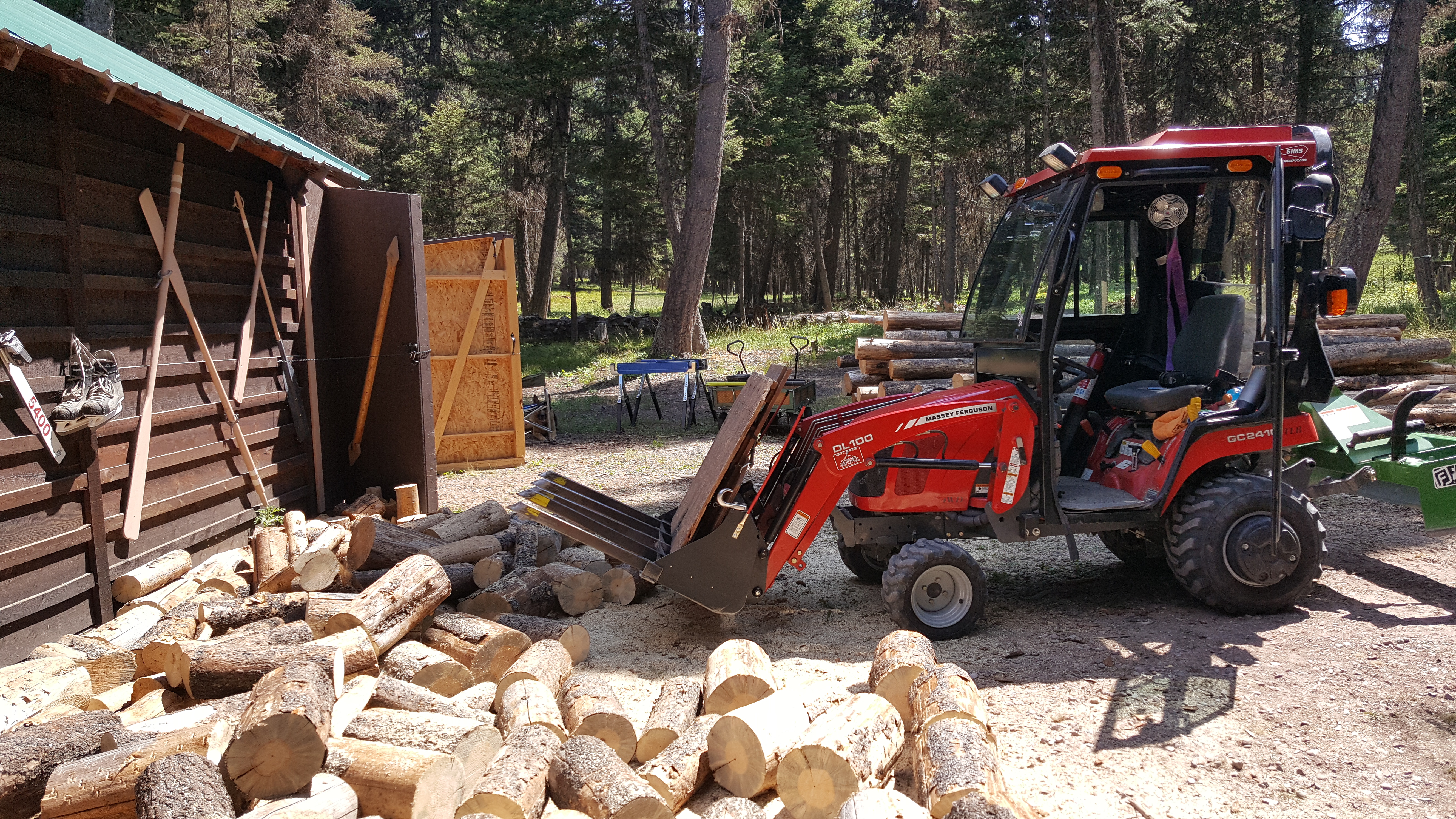

I built my brush forks about 9 years ago and during the summer they are installed on the FEL bucket most of the time.
I also installed a 3/4" hinged plywood deck on top of the forks with a wood framed type of headache bar.
I have some bungees on the vertical wood frame mainly to secure tools, etc...
My brush forks slide into the bucket and are fastened with three 1/4"-20 grade 8 machine screws taped into each side of the bucket for easy on/off.

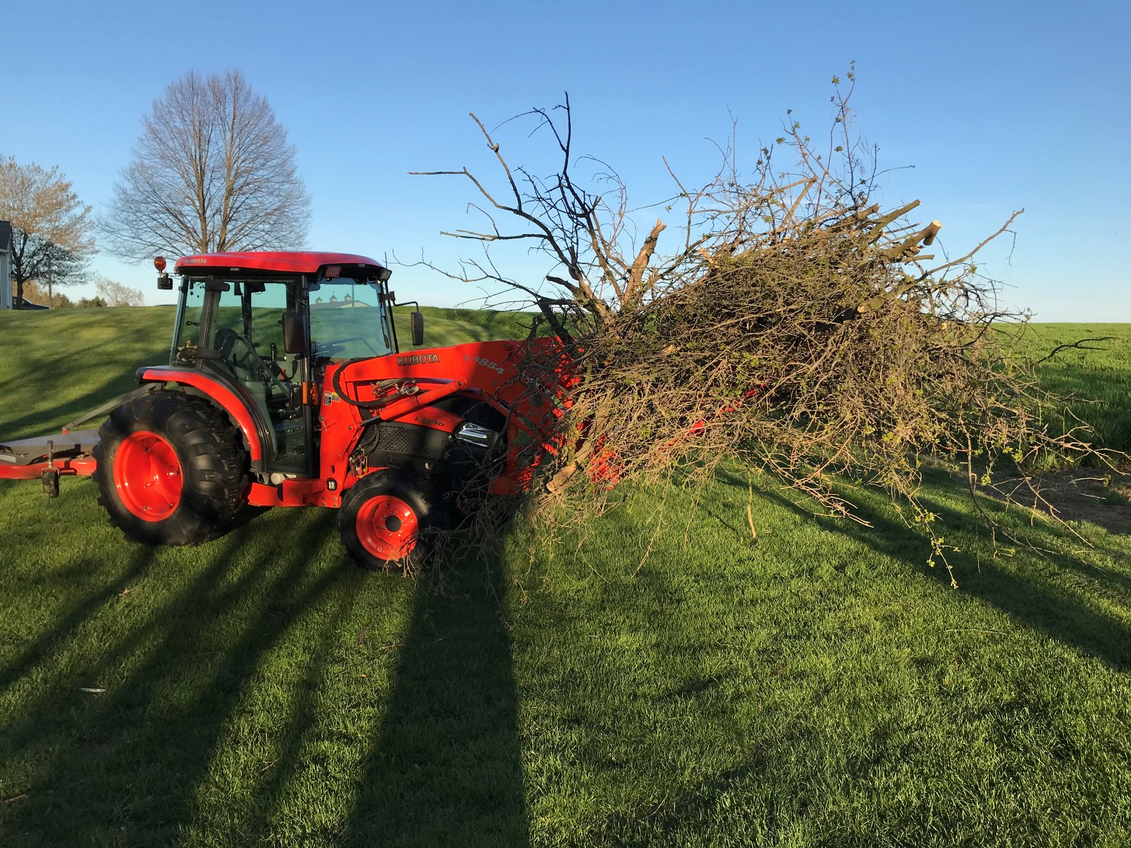

Made serious progress today. With the exception of a little cleanup and paint, they're done. They hauled their first load of debris from down near the creek.

The new forks got a good workout yesterday while doing some tree removal. The headache rack was handy.

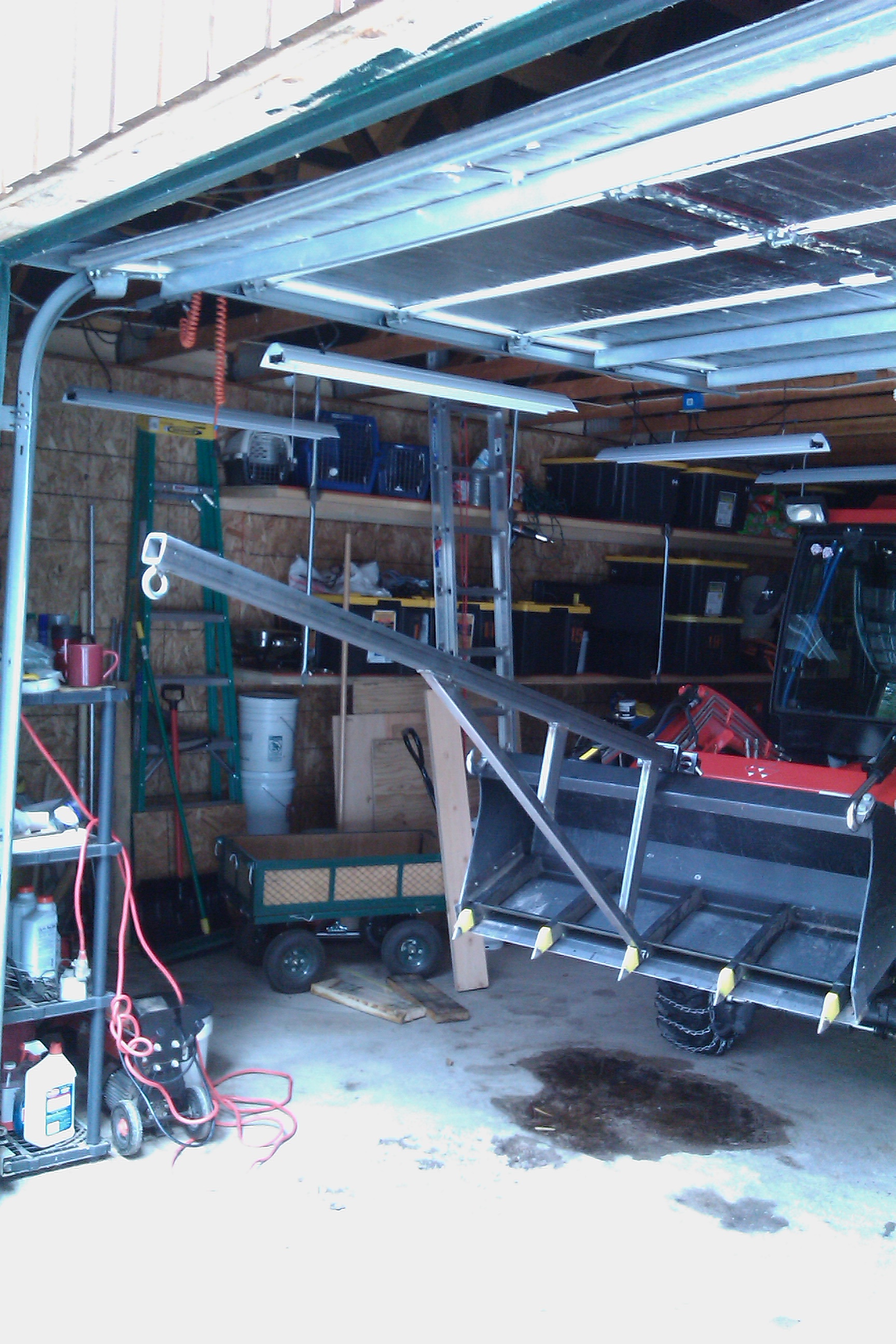

I hope you get the idea how I built my brush forks from these pictures, I'm embarrassed to show mine next to what chim built...
I think I used 1" x 3" x 1/8" rectangular tubing, 1.5" x 1.5" x 1/8" angle iron, and 3" x 1/8" flat bar for the brush forks and the tooth bar, and the angle iron connections are about 1/8" smaller then the length of the FEL bucket..
I also built a jib that works with both the tooth bar and the brush forks, and used it to set the wife's greenhouse walls that I framed on the garage floor years ago.
The plywood platform on top of the brush forks hinge up and can be bungee to the vertical headache rack.
I used two 1/4" - 20 welded eye bolts to secure the plywood to the top of the brush forks, and used the same fasteners to secure the headache rack to the upper edge of the FEL bucket in order to slide into the bucket easy.
The plywood hinged platform has sure worked out good for me to use as a work platform, etc... and I just flip it up and out of the way to pick up a pile of tree branches.
All of the fasteners are installed in holes that are tapped.
