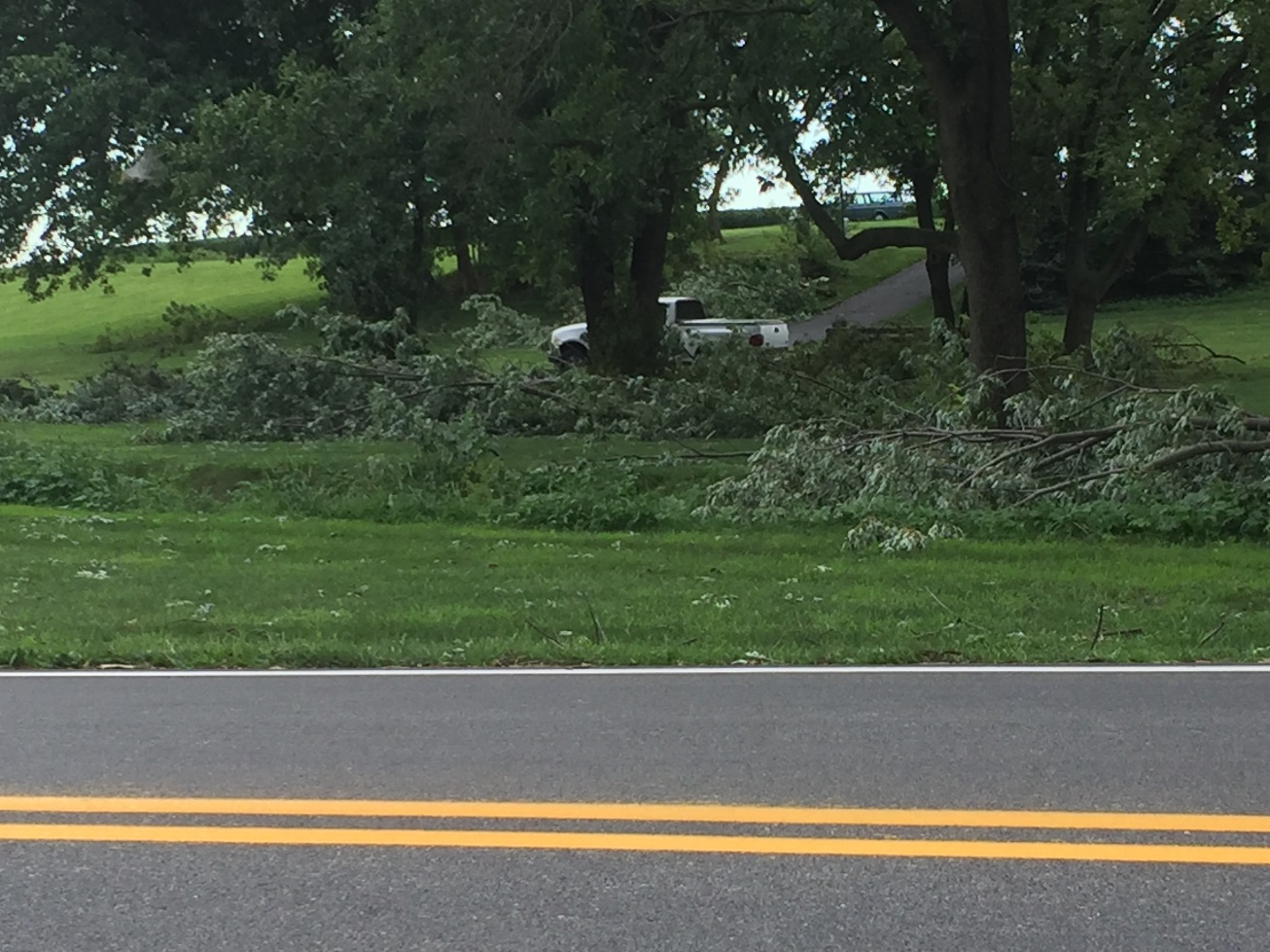

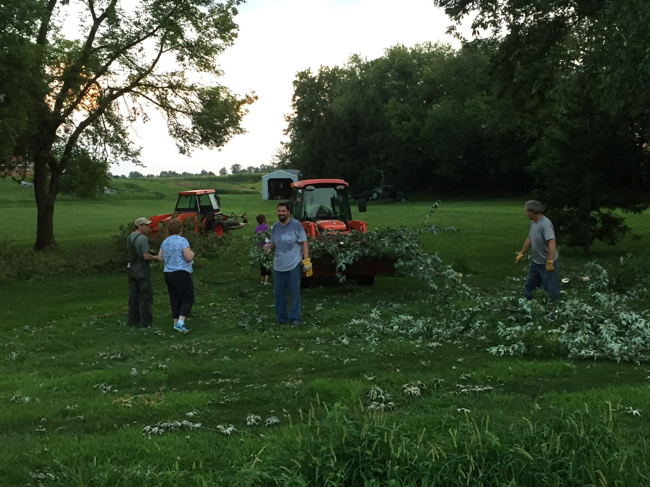

Experience with the set first set on the L3200 was not wasted. The bucket was the only thing preventing stuff from rolling off the back and onto the hood. We had a storm a few years ago that broke off a bunch of tree branches. Friends and family turned out when they saw how much was on the ground. Brother in law brought his L4740 over and it didn't take all that long to get the place in shape. There's a brush pile at the end of a fence row where we dump limbs and trimmings. One of the helpers with less experience took a load and wasn't familiar with the need to dump a little while raising the loader and a limb dented the hood.
Not long after buying the L3200 I had a mishap pulling a sapling that came back and thwocked the hood, so it wasn't a pristine hood. The difference was that the original damage couldn't be seen from the seat:)

Was at work one day a few years ago... had told wife's cousin he could cut firewood from downed trees in my lower field, and use tractor to tram bucket loads of wood back to his trailer at the road. Did what your help did, bucket up, firewood rolled over top of bucket, hood damage as a result. But my hood was perfect before that! Still dented, but I've managed to make the fenders match it now... and it doesn't hurt my conscience to bum beer off him every chance I get!

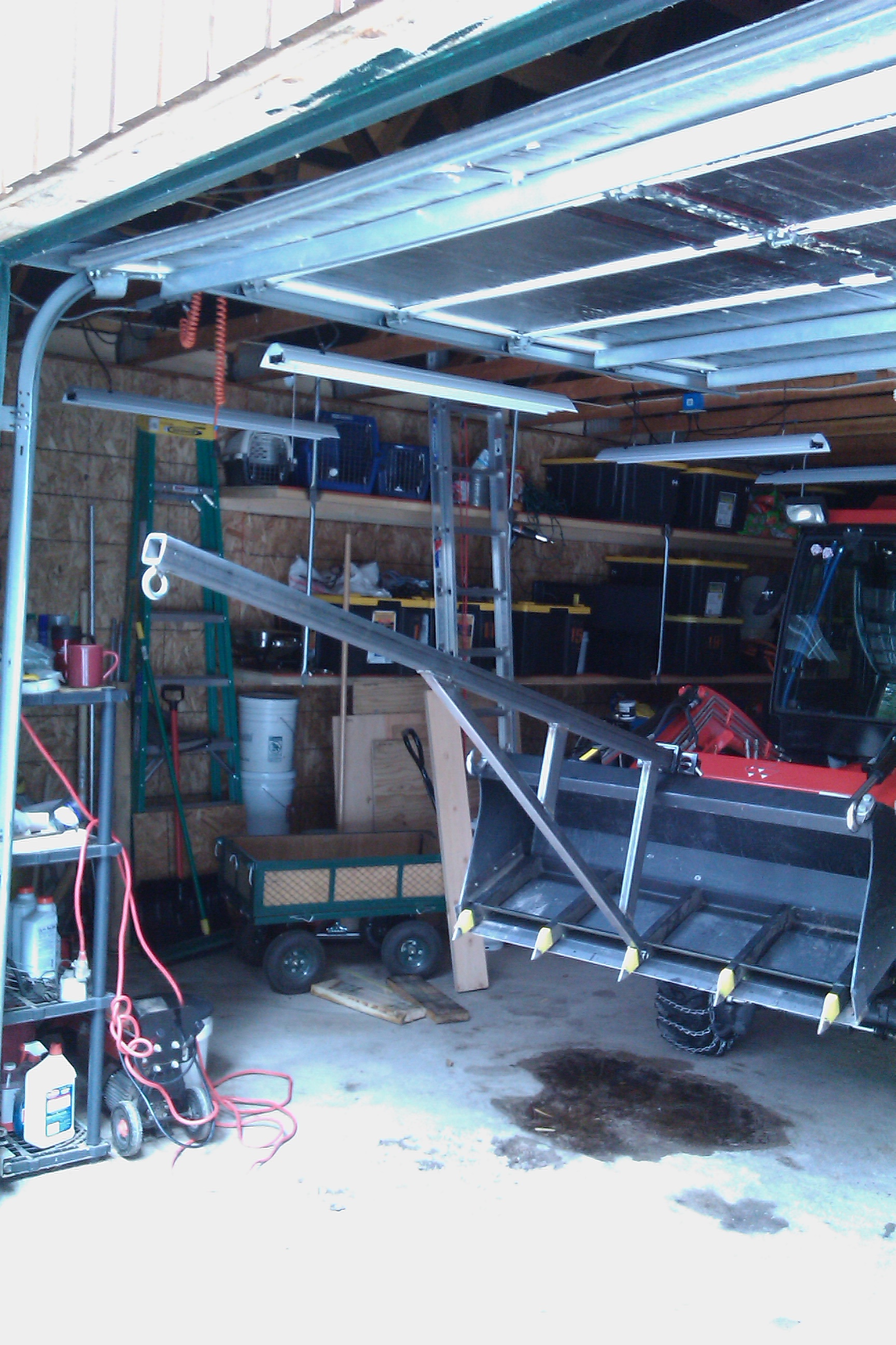

Since you said bucket, I guess you mean the forks in the link in my first post. The angle iron grabs the bucket edge and the chains and binder lock it on. After the pictures in the link I did add a couple tabs and two chains on the front side. That made it easier to install. It is just a matter of parking the bucket over the forks, dropping the two chains in the slots, and curling the bucket. The added chains don't perform any duty except helping with the installation. The design was to get something simple to work with the pin on bucket.
The new forks got a good workout yesterday while doing some tree removal. The headache rack was handy.

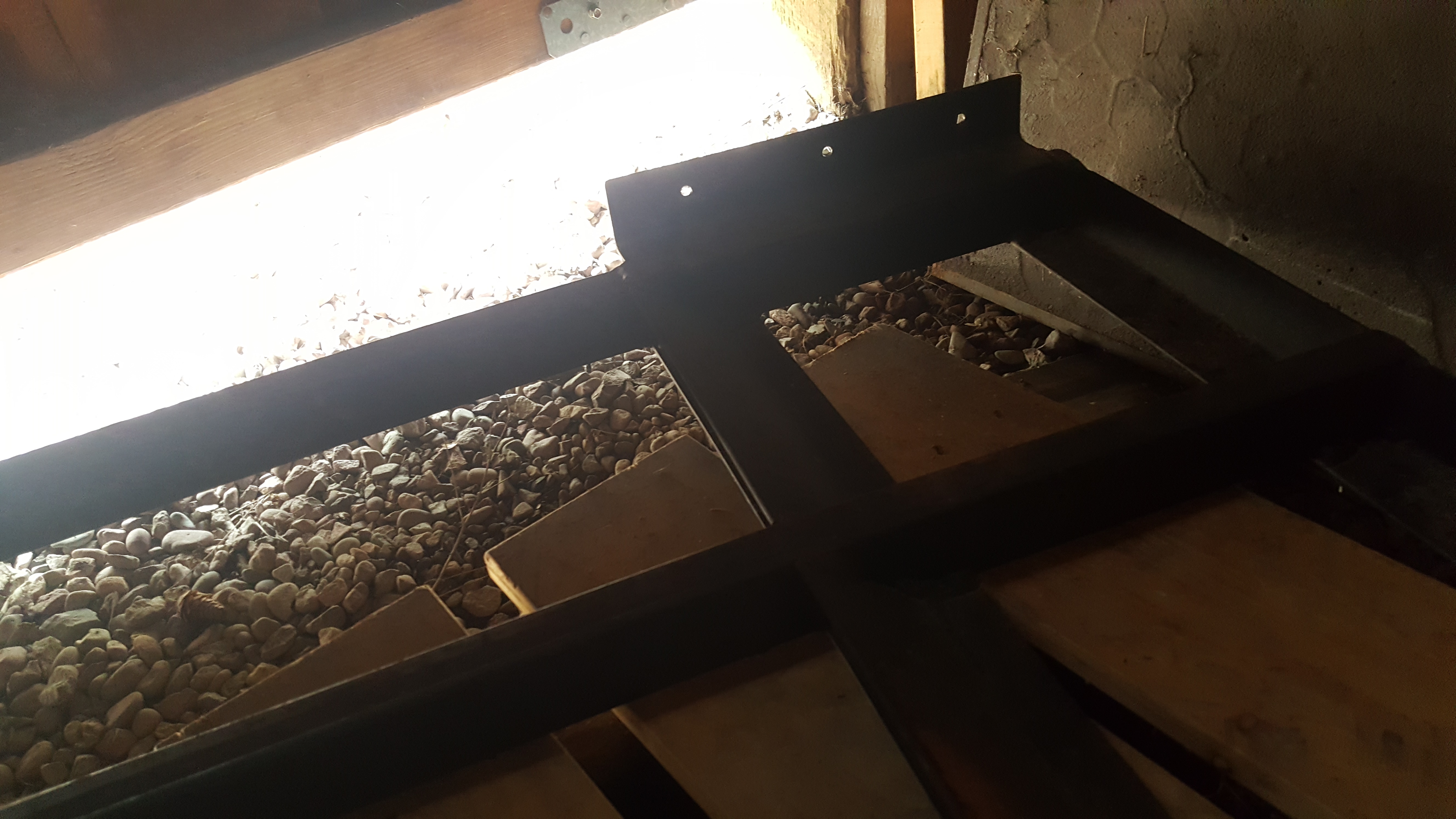

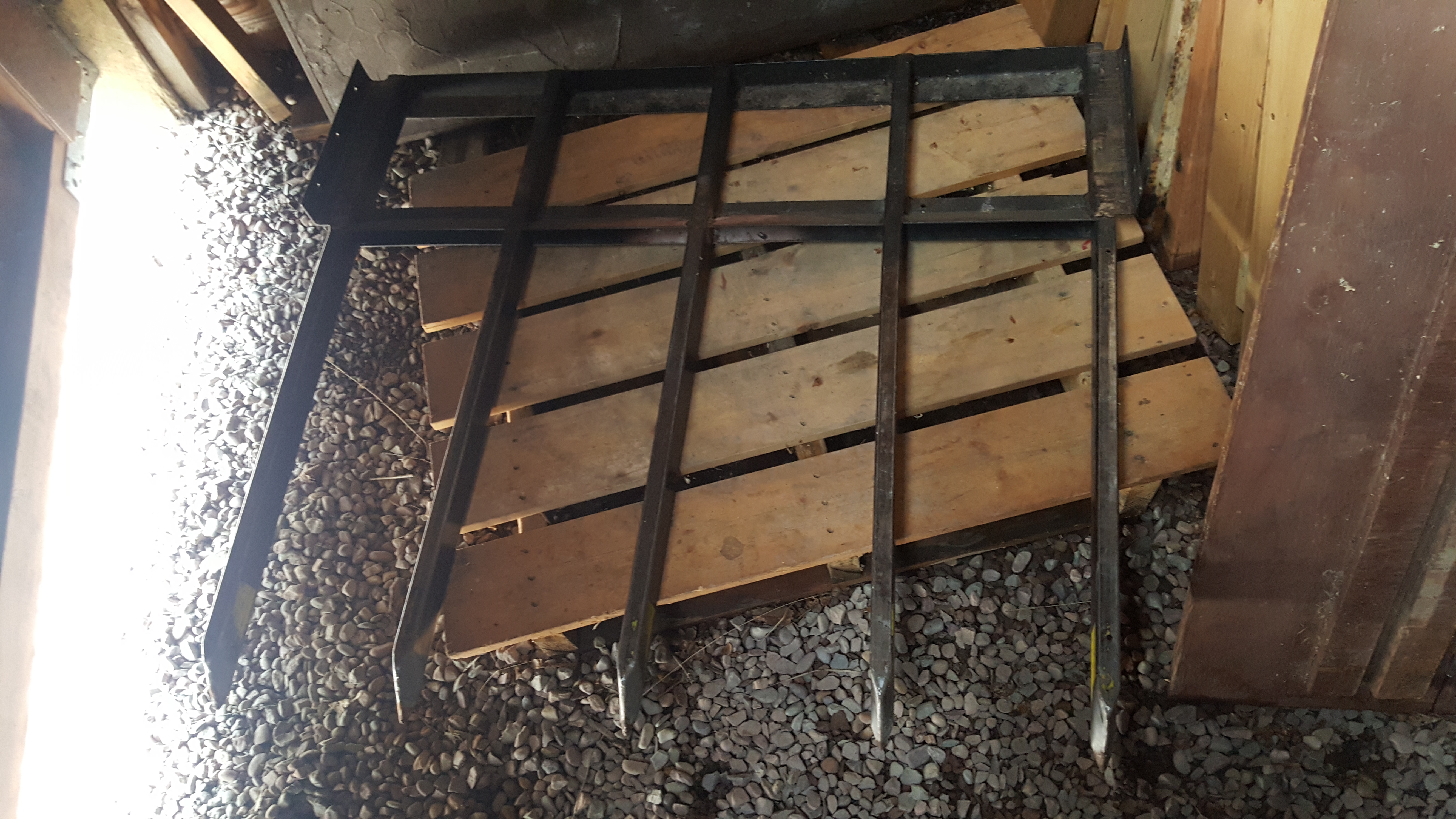

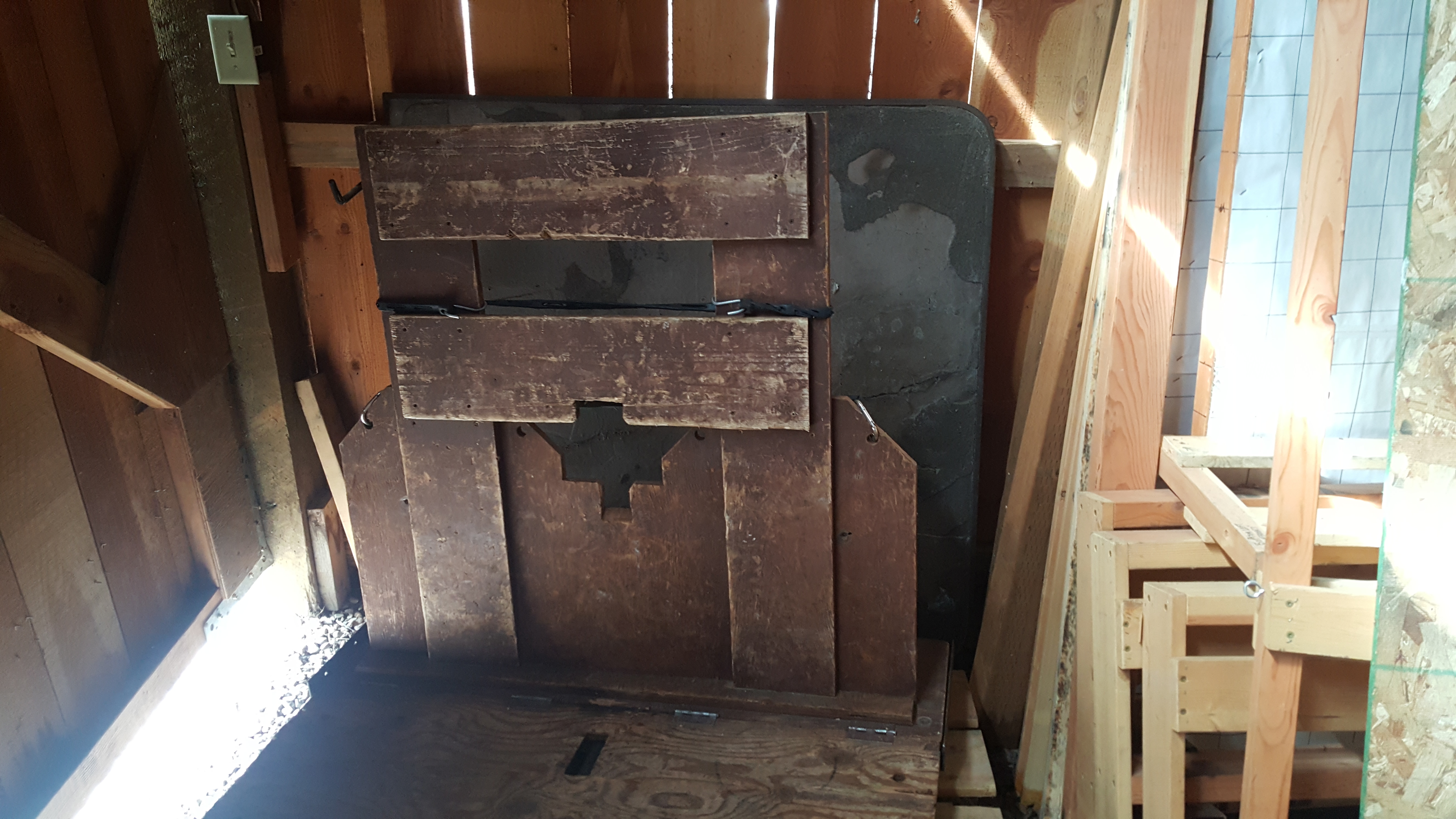

I hope you get the idea how I built my brush forks from these pictures, I'm embarrassed to show mine next to what chim built...
I think I used 1" x 3" x 1/8" rectangular tubing, 1.5" x 1.5" x 1/8" angle iron, and 3" x 1/8" flat bar for the brush forks and the tooth bar, and the angle iron connections are about 1/8" smaller then the length of the FEL bucket..
I also built a jib that works with both the tooth bar and the brush forks, and used it to set the wife's greenhouse walls that I framed on the garage floor years ago.
The plywood platform on top of the brush forks hinge up and can be bungee to the vertical headache rack.
I used two 1/4" - 20 welded eye bolts to secure the plywood to the top of the brush forks, and used the same fasteners to secure the headache rack to the upper edge of the FEL bucket in order to slide into the bucket easy.
The plywood hinged platform has sure worked out good for me to use as a work platform, etc... and I just flip it up and out of the way to pick up a pile of tree branches.
All of the fasteners are installed in holes that are tapped.

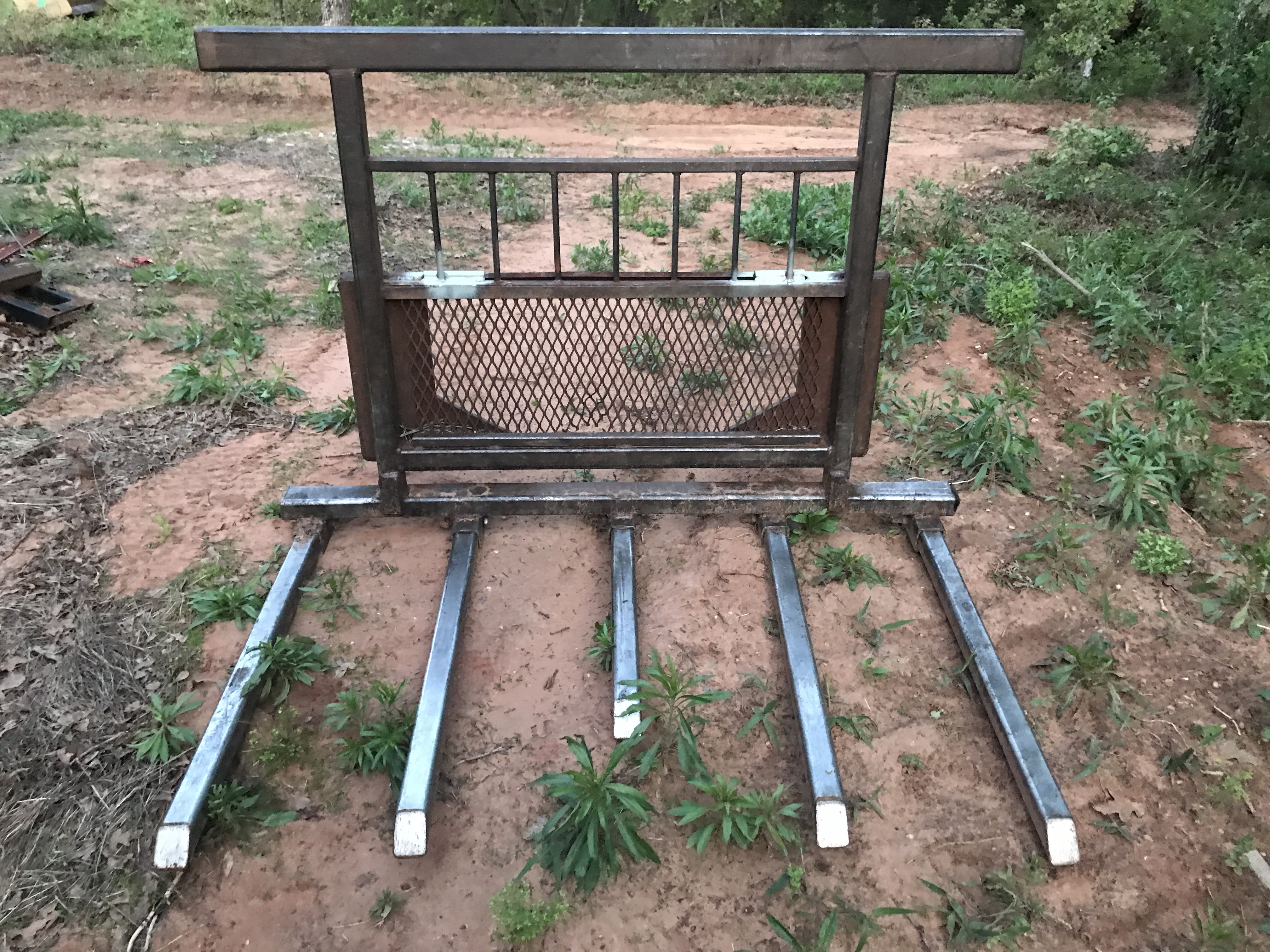

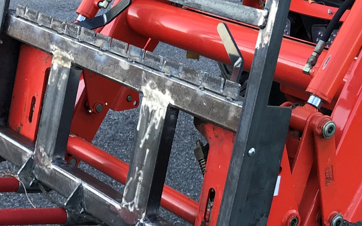

I would add some metal to protect your QA levers. If I built another, I would use a solid back plate. This one I built uses removable 2" x 1/4" square tube for the forks, due t me inevitably bending them.
The picture was snapped just before removing the forks and putting the bucket back on. It was posted before I noticed the levers were in the up position. When the levers are in the down / locked position they hide behind the top member of the QA frame. The slotted angle adds a bit more protection. Here's a cropped closeup of the levers while up.
It looks great BTW, I love how you built your own QA plate. I have been very rough on mine to the point of twisting the 2 x 3 x 1/4 bottom tubing near one end.
/ Brush Forks - Second Attempt
#18
Thanks but I can't take credit for the SSQA frame. Only reinforced it and used it for the starting point of the build. Bought it from a guy near York who has a lot of equipment he uses in his business. He bought a package deal and had one left over when he was done fabbing attachments for his skid steers. The frame was just a rectangular picture frame with the tabs on the tractor side for connecting to it. Not sure what the wall thickness is on the square tube but the frame itself was very heavy. I added the two pieces of 4" channel between the top and bottom members to make sure it was stiff. The frame seemed a lot more robust than the 3/8" solid plate I bought to make my snow plow mount.
