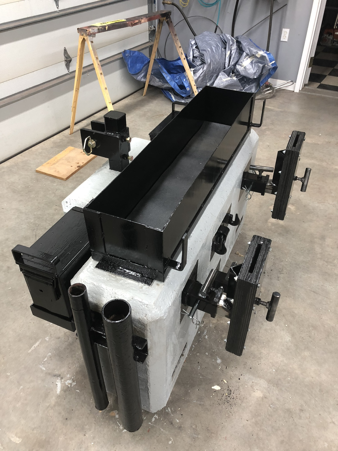

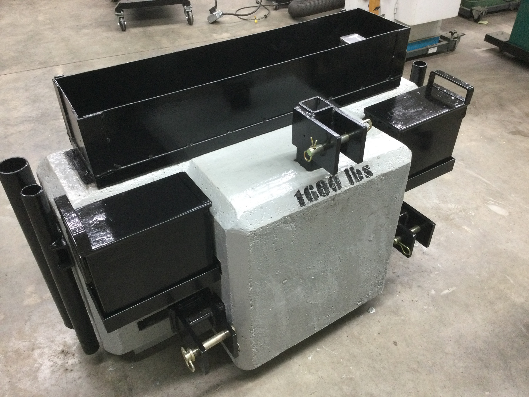

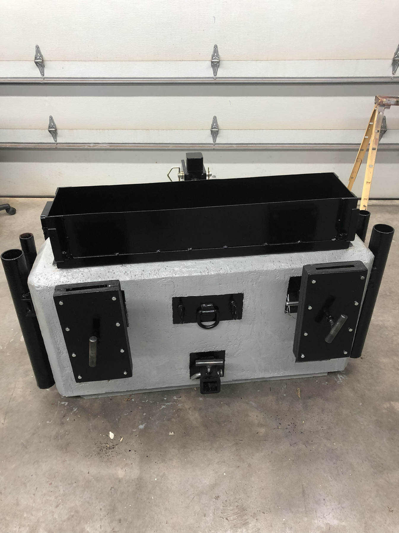

Here it is with the ammo cans and chainsaw mounts installed. I reworked the ammo can lid handles by cutting off the center handles and welded on a section of 4x6 square tubing cut to the appropriate size. The chainsaw mounts were fabricated from plywood sandwiched between some 14ga sheet metal. The pinch bolts were installed to keep things from ratting around when moving.View attachment 733133View attachment 733134View attachment 733135
Wow. That is slick. Well done.
