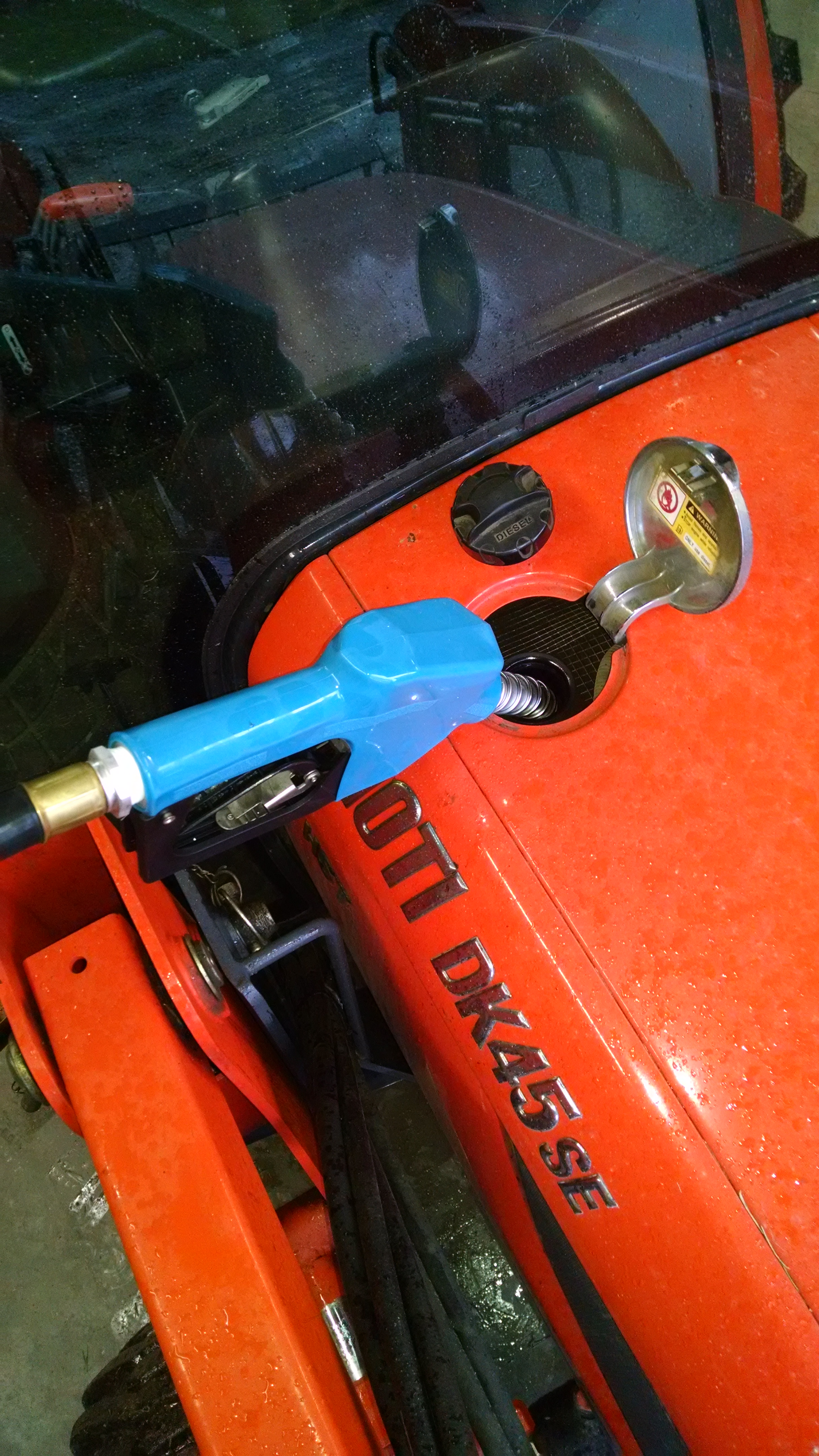

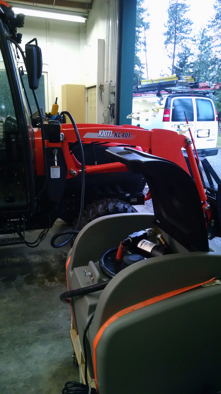

i do love my new fueling storage tank. took 1 minute to refuel the tractor..and i didnt have to climb on the tires to do it. IMG_20160310_090225244.jpg IMG_20160310_090232473.jpg IMG_20160310_090320326.jpg
