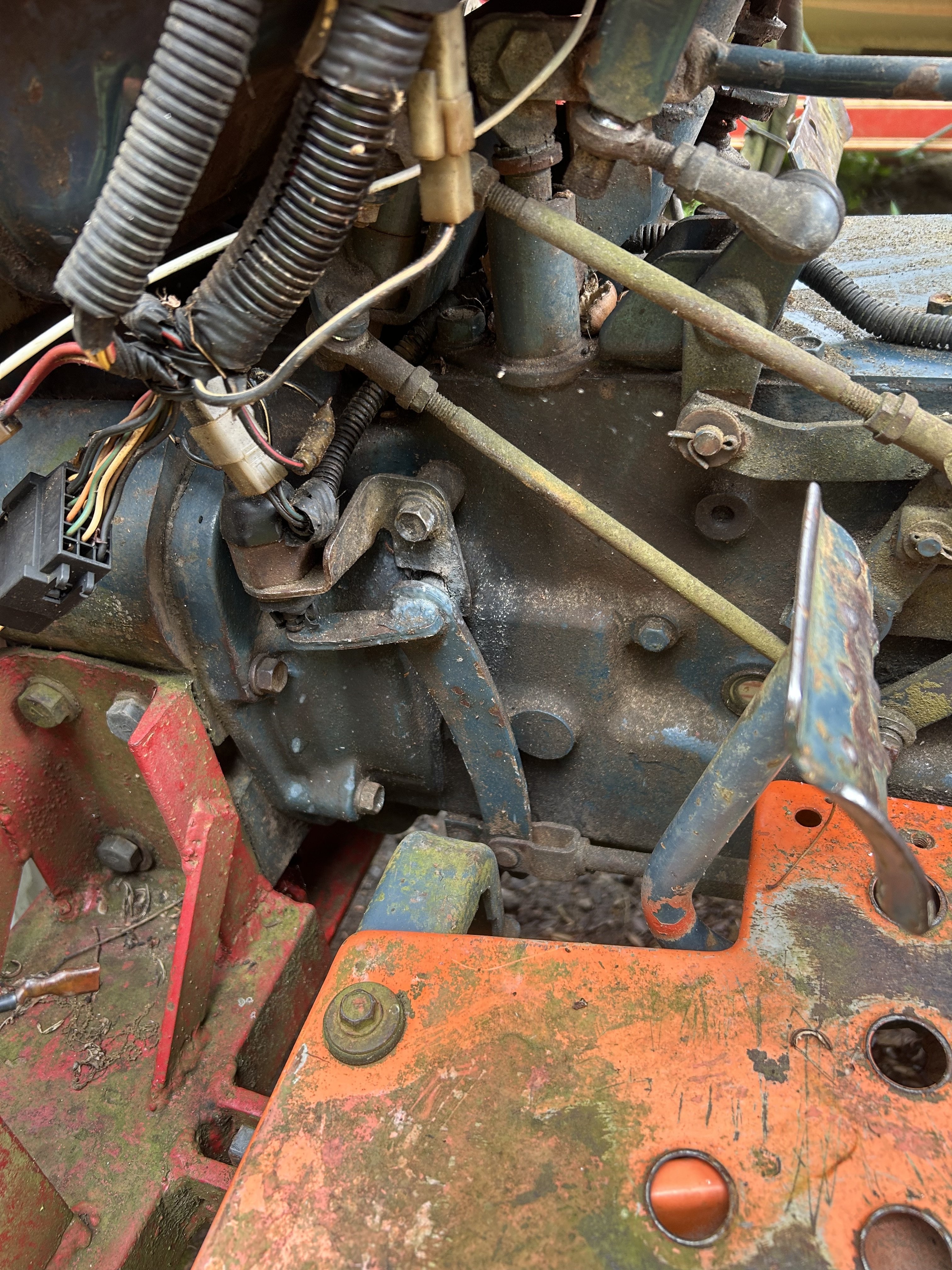

The clutch pedal does not depress, and the shaft that the pedal connects too, does not turn, that is the shaft that you refer to in the 6560 image, the shaft is connected to the lever in the image, that shaft has the fork attached to it internally , that it turn moves the throughout bearing,
I think the release bearing is frozen,
I will have more to say after hopefully get a look inside,
thanks

All good, but full descriptive info, several posts back, indicates that the bearing wont slide as needed to operate the pressure plate. The clutch pedal cannot be depressed. The lever in pic 6560 will not move.
The clutch plate may be stuck to the flywheel some too, but our actuation inputs are blocked prior to the point we could determine that.

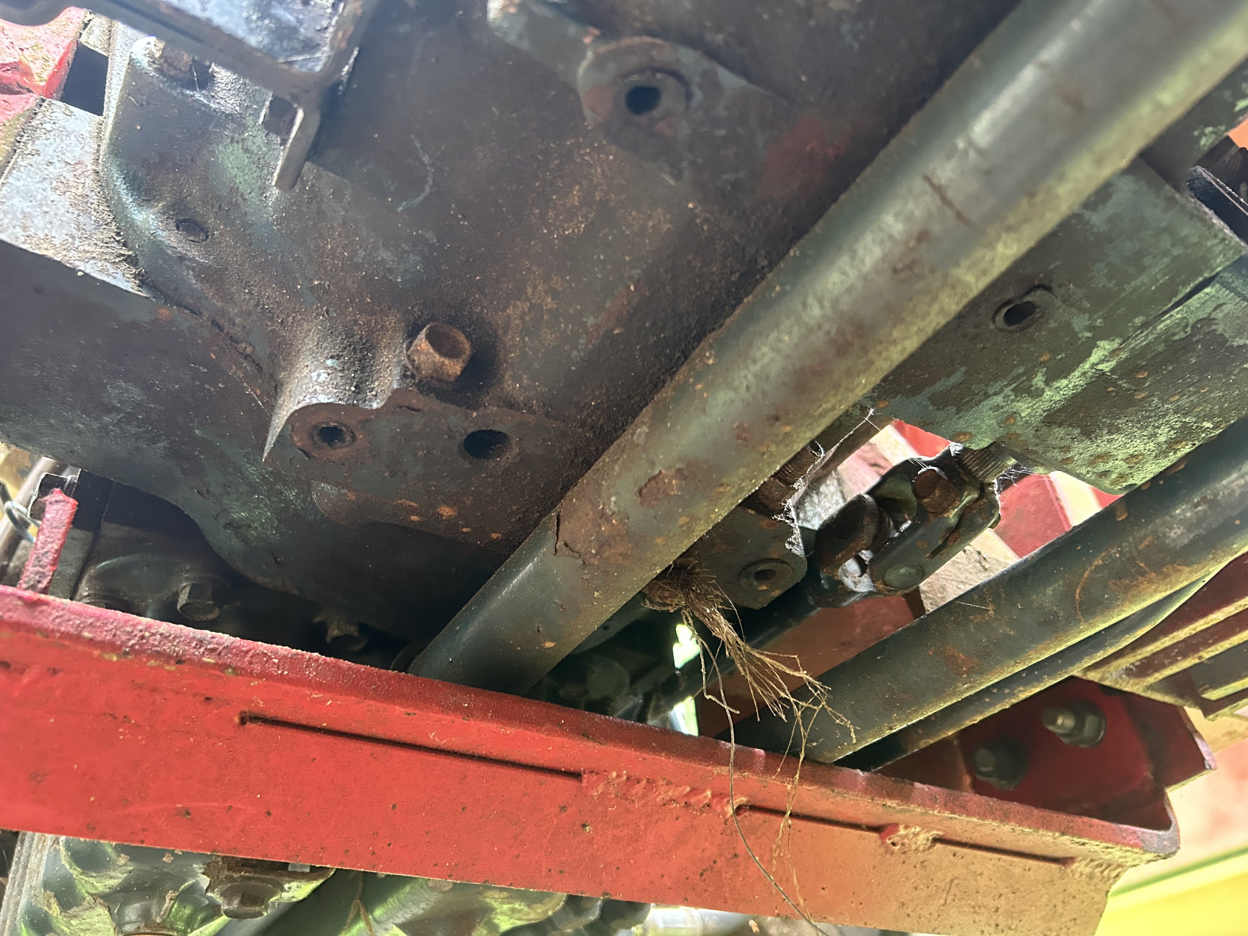

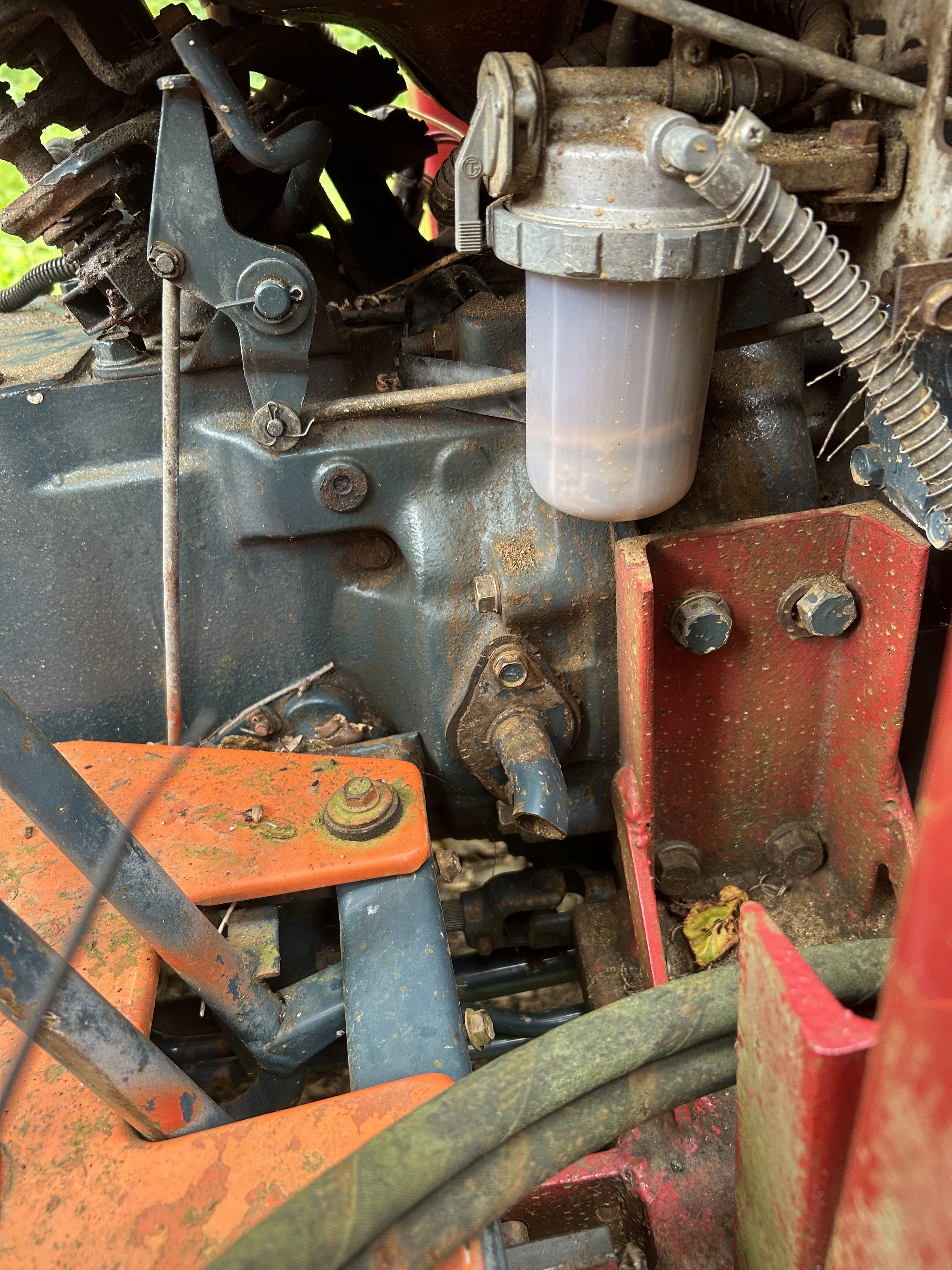

Well I did get a look inside, It doesn't look good:eek:, Apparently last summer when we had a big rain in Aug at that property, it must have gotten water into the clutch housing , because it is just rusted terribly,So I guess it needs to be split,I'll put a few pictures up,
I'm Sorry to have wasted y'all's time, with this issue, I might need some insight into the splitting job, but it seems straight forward, That is not happening till after the summer ,All the suggestions were Great, Thanks,

Sad situation. That is like flood damage.
Good pics of the t/o. I was able to make a tool to regrease the t/o in our L3450 through that breather port. It was dry and you could hear it spin.
Glad you are able to move the tractor. -- Not that it will rejuvenate it, but notice that you can spray the t/o lavishly w/o danger of contaminating the clutch itself. The clutch is a couple inches forward of the t/o and any spinoff is going to be strictly radial tangent -- no axial. Also, look for a drain/vented bolt drain in the bottom of that bell housing. It may be stopped up. It will at least prevent a further worsening situation if you can introduce some appropriate juice repeatedly and be assured that runoff will drip out, not puddle in the bottom.
