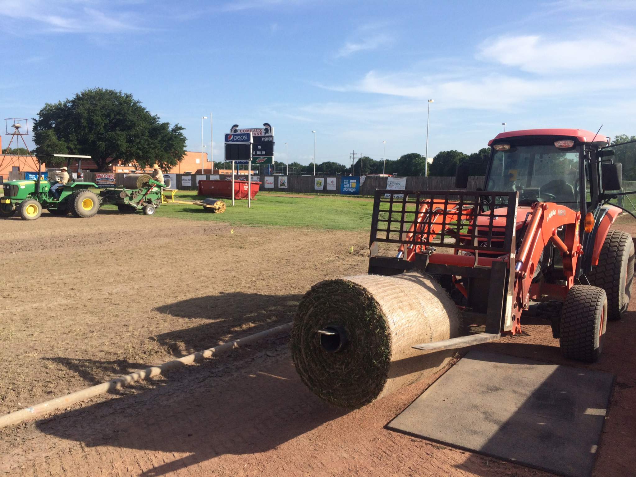

I spent all day loading big rolls of sod into the planter. I estimate these rolls weigh about 1000-1200 lbs each. Hopefully, I didn't break any more bearings.
I did seem to feel a 'chatter' from time to time. I'm thinking that may be the gears that were chewed up pretty good on the first side that I changed.
Well, more work for the tractor today.....I hope it holds up.

The gears will be fine. ... Just raise the fronts and feel for play occasionally. You dont want any more bearing parts running around loose in there.
