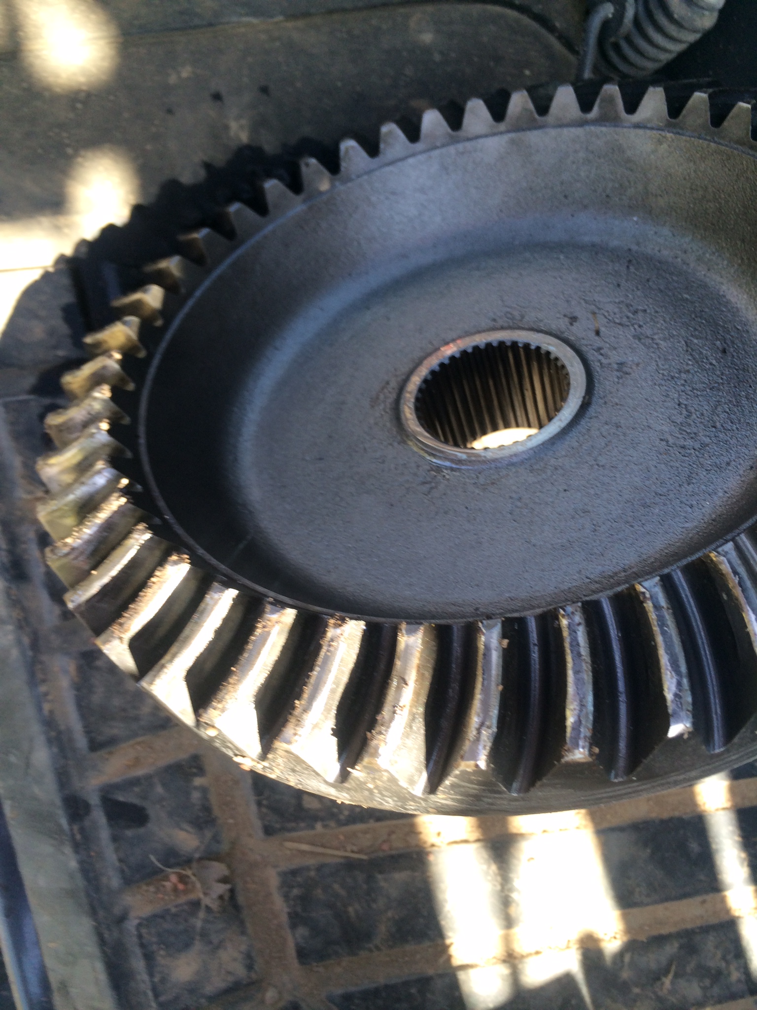

Got it all back together last night. Total cost for parts was about $400 including 3 gallons of UDT2 oil. It took my brother (a professional tractor mechanic) about 2 hours to get it all back together.
I'm not sure how long it will last since the gear was in pretty bad shape, and we didn't change it.
A couple things to keep in mind if you ever have to do this....1. The 'collar' is 2 pieces. I thought it was 1 piece that had broken, but it's actually 2. Make sure the parts person orders 2. My guy ordered 1, but luckily I found one more at another dealer about 30 miles in the opposite direction.
2. The 'shims' are of different thickness and the right one to order is based on your tractor serial number. This dealer ordered the wrong one because he never asked me for my serial number. We were able to use the old ones. (There were 2 in one place and one in another place).
This would have taken me at least half a day to put back together with the tools and equipment I have. Luckily my brother's truck is very well equipped and he has experience doing this sort of thing. If I would have had to pay a mechanic to do this, I could see it getting to $1000 pretty easily as I had expected it would.

That's good you're back at it and nice to have someone like your brother to lend the expertise. What's your brothers thoughts on the gear? When I zoom in on it I don't think it looks too bad but it's hard to tell from a picture.
/ Front wheel bearings failed L5740
#32
He thinks it won't last long.

I had a bearing go on my dozer while I was deep in the woods. I had no way of getting it out of the woods other than very slowly and carefully driving it. The bull gear looked in worse shape than that and has lasted at least 6 years now without issue. I wouldn't worry about it but I would drain out the fluid. If you can find a place to put a magnet to catch the filings.

Barring further incident it will last thousands of hrs. If the same happens every 500 hrs then maybe a thousand hrs more..
I hope you guys are right. I have not been able to use it yet because of all the rain we've been getting. We did drain the fluid and cleaned everything out. You can see in one of the pics pouring diesel in the gear to clean it. It was dirty.
