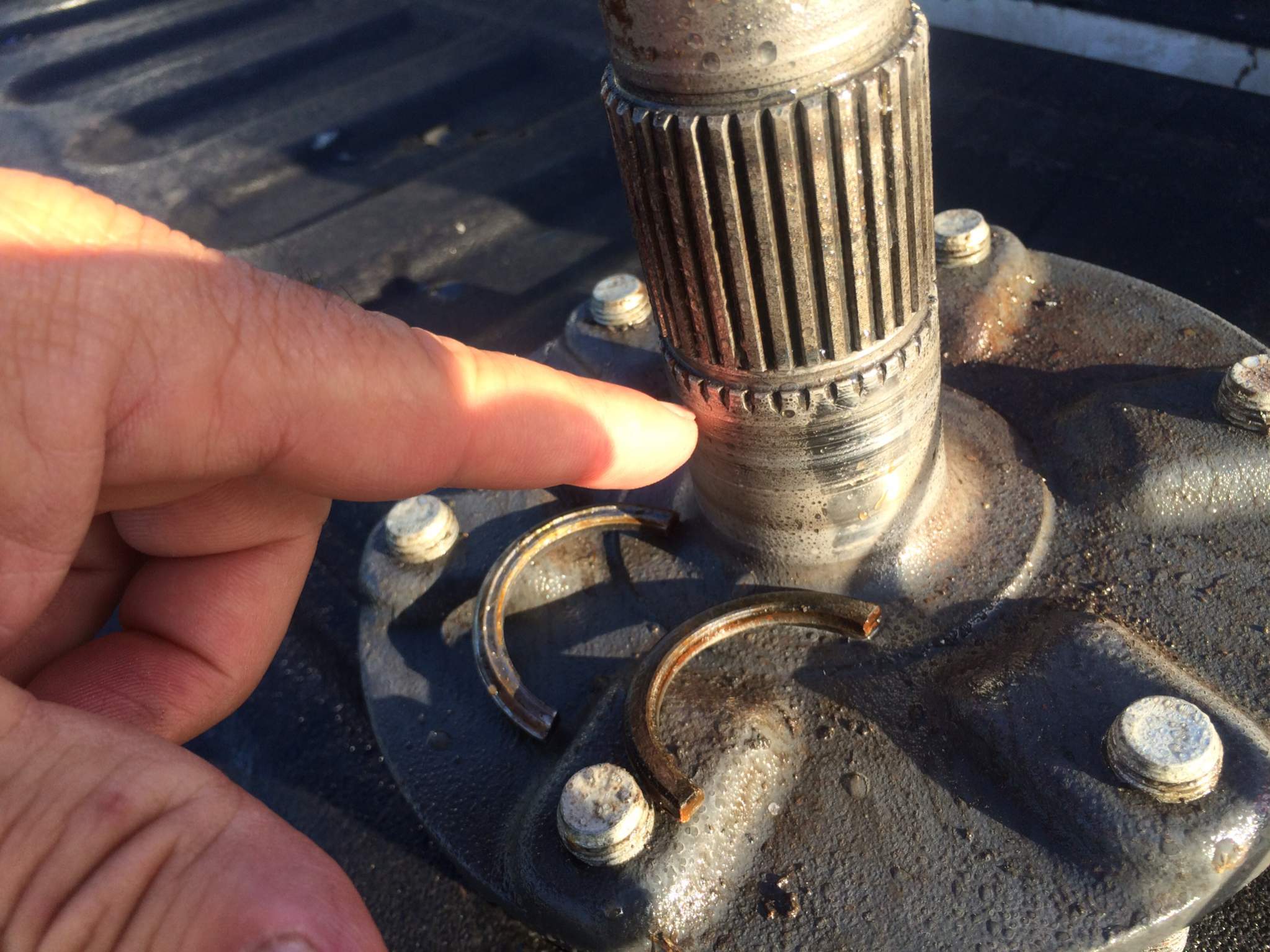

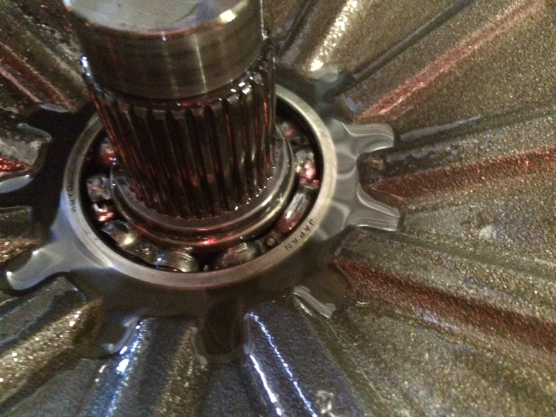

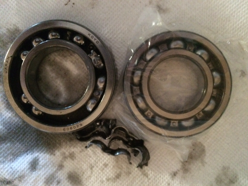

My L5740 failed in January but gave me warning. One day after plowing snow I noticed the left front was wet. I thought it was just that I had been working hard and it was snow melting. Next time I plowed I checked it and found the left to be wetter yet. This time I engaged my brain after putting the tractor in the garage, raised the front end using the loader and sure enough there was free play in the wheel. I had my dealer ship me both bearings and the seal. When I took it apart I found the retainer broken but the balls and races still looking good. There was light rubbing from the drive gear hitting the case. New bearings, seal, and oil and it's running fine. Having read about the number of people having front bearing failures makes me wonder if I should keep a spare set. Cost was about $90 plus shipping. That included a new o-ring housing seal. My tractor had 650 hours at failure.

Koyo bearings too, not some off brand. Glad I have a large frame under my loader. That looks to be possibly expensive if it completely failed.

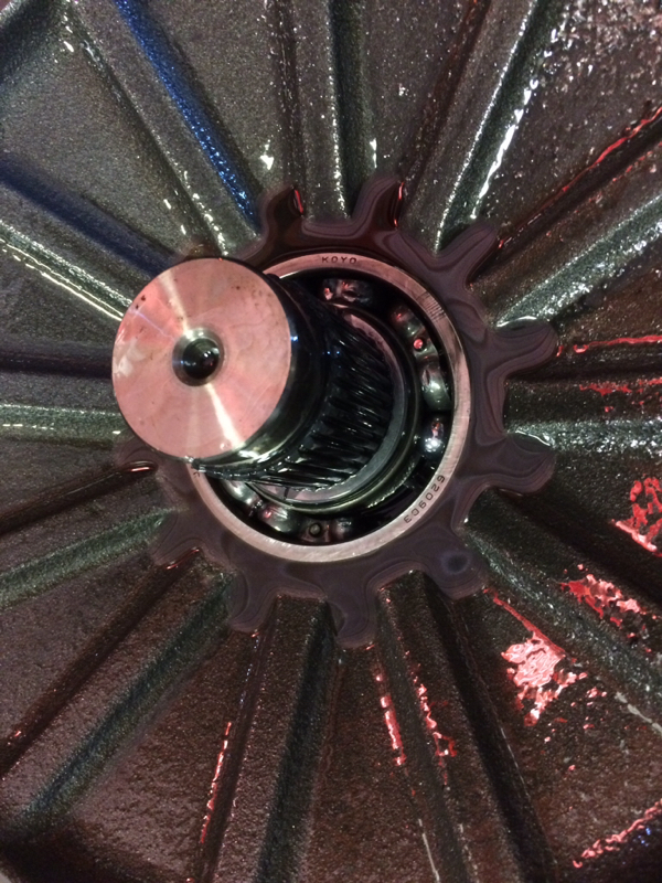

There is a good bit of scars on the shaft where the bearing sits, and my mechanic (my brother) thinks that the new bearing will not seat on the old shaft, so I'll order a new shaft. Also, you can see the retaining ring is broken. I'll get pics of the gear later today. I'm thinking this is going to end up around $1000.

There is a good bit of scars on the shaft where the bearing sits, and my mechanic (my brother) thinks that the new bearing will not seat on the old shaft, so I'll order a new shaft. Also, you can see the retaining ring is broken. I'll get pics of the gear later today. I'm thinking this is going to end up around $1000. <img src="http://www.tractorbynet.com/forums/files/kubota-owning-operating/426368-front-wheel-bearings-failed-l5740-014d8dc861c5c97f9f0fff20d4a545532a33d45218-jpg"/>
Wow, does the wear feel worse than it looks? I would assume the shaft was fine.
Now the part that worries me, if this went, will the other side go?

Got the parts ordered this morning. They should be in Wednesday morning because today is a holiday. About $280 plus freight, and 2.5 gal. of oil. Not as bad as I was expecting.
The gear teeth are chewed up a good bit, but I decided not to change it now, because I would have to change the other gear that drives this one too, and that would be a lot more work.
I also lifted the other front wheel and could not detect anything being loose. Hopefully it holds up for a while.
