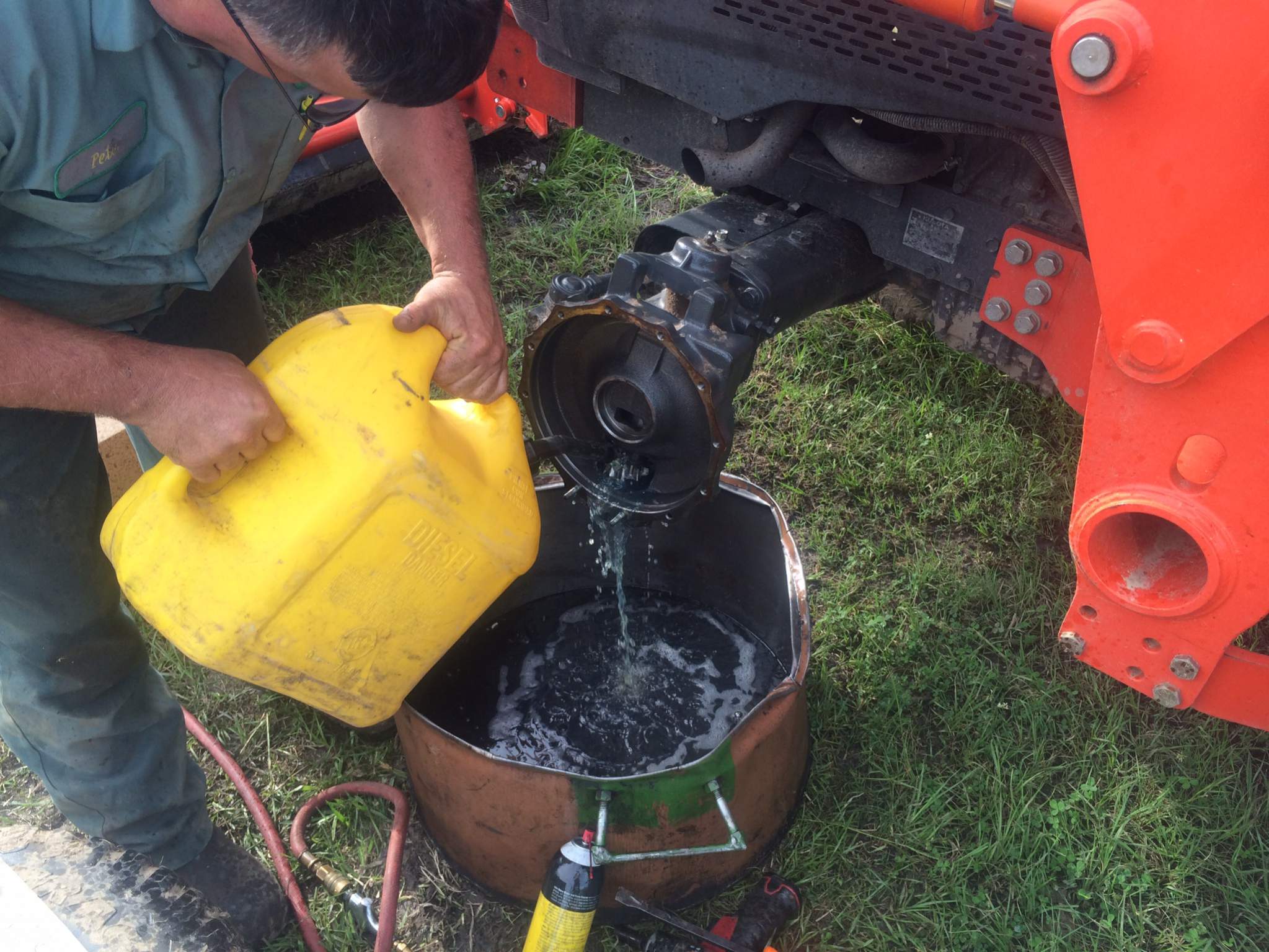

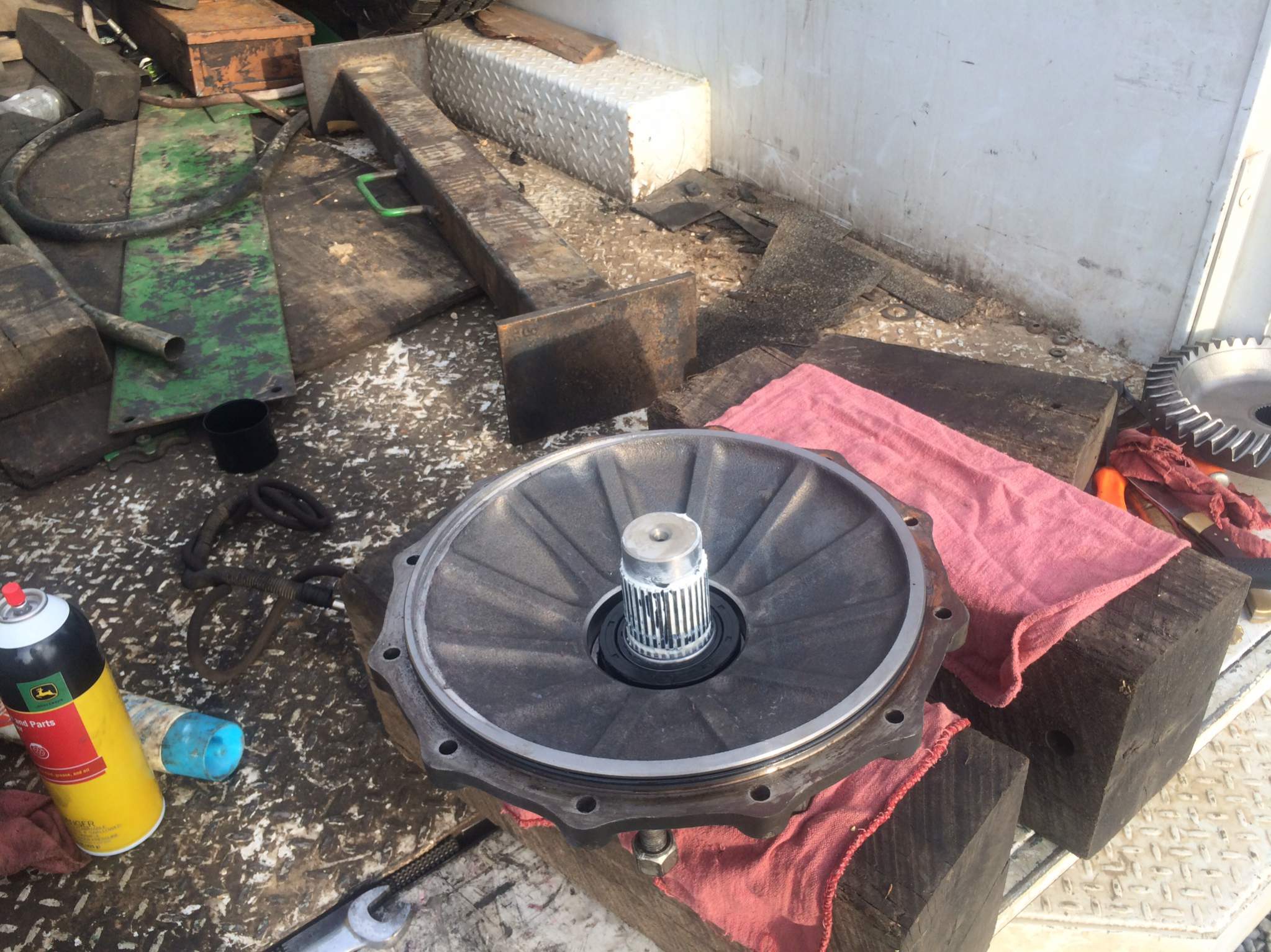

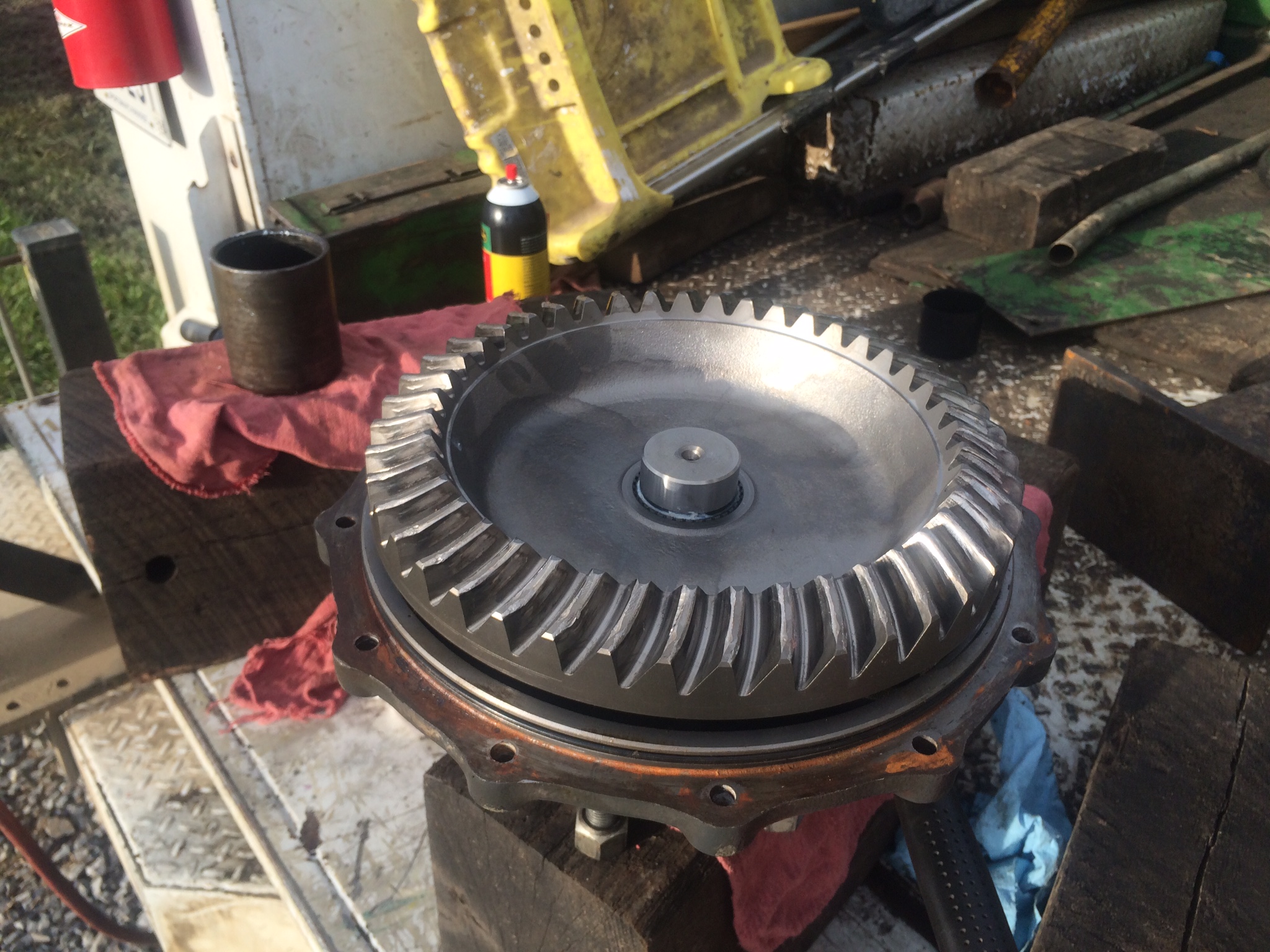

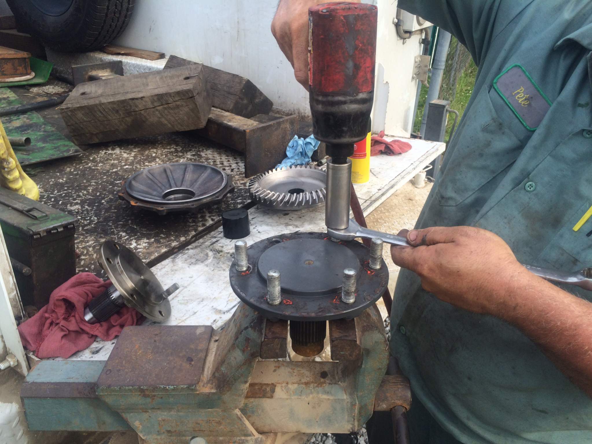

Well, I got it back together today by myself. I only changed the 2 bearings and the seal on this side. It seems that I caught it before as much damage as the other side. I was able to pick up one bearing and the seal from a local Kubota dealer, and the other bearing I found at a shop that specializes in bearings.
It looks like the outer bearing just broke into pieces instead of slowly wearing out. The balls didn't seem to have much wear or damage on them. The other side had so much damage, it was hard to tell what had happened.
