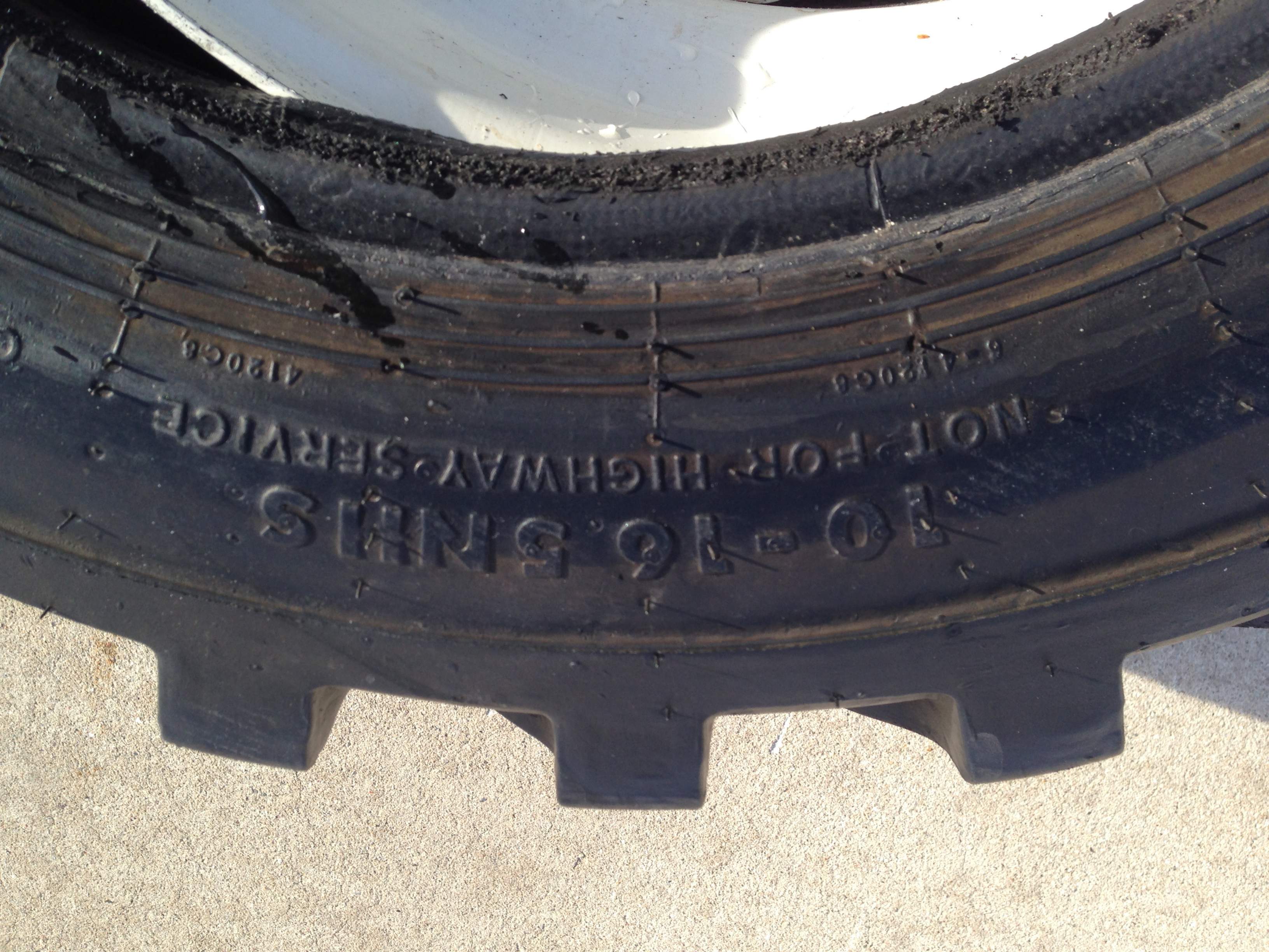

IMG_0225.jpgLast month during one of our cold snaps, I took my Boomer 3045 out of the shed to clear some snow and unfortunately in my attempt to get the left front tire back on the driveway, the tire slipped off the rim. Once recognized, I drove the tractor back into the shed slowly, jacked it up and removed the rim and tire. The tire is a Titan 10-16.5 NHS 6PR Trac Loader R4 (tubeless). I brought it to the local tire shop to see if they could put it back on, but they determined that the bead was too damaged to hold a seal and suggested brand new tire. Asking all of you if other options exist. Dealer cost of new tire is $300 on the Titan site. Would placing a tube be an option or are there lower cost tire options.

Hard to tell for sure how bad it is by the photo.
But I would try a tube. Looks like it would be fine with a tube.
Worth a try.
I put a 1" cut in the sidewall of one of my front R-4 tires. Installed a tube several years ago. It is holding up fine.

I think I would just put it back on the rim. I blew the photo up and except for the end of the one cut that has protruded into the rim area by a small amount it looks like it would still work. I would try it any way.

Pomp's Tire Service in Green Bay took care of repairing my tire. They identified a hole in the tread which they plugged and also installed a 10R/12R16.5 Tube ($20) to hopefully prevent further issues. The bead was not as bad as the first mechanic I had taken it to had indicated; they did apply bead sealer so the combination of tube and sealer should serve me well for hours on end. Thank you all for your comments, insight and options. Lesson learned. The next -15 degree day I may heed my wife's advice and stay inside stoking the fire waiting for the temps to rise a little bit before going out to play.
