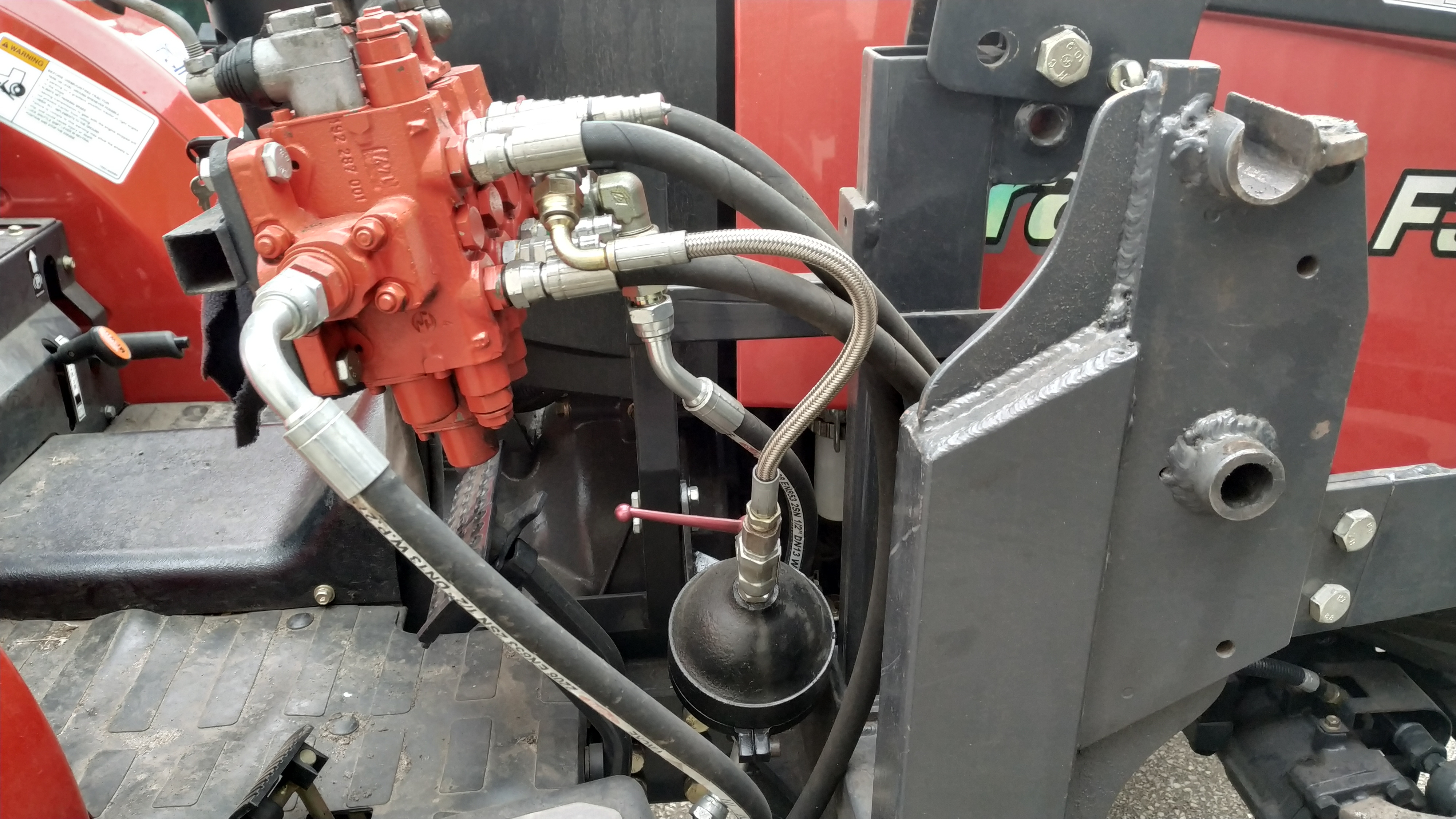

Most any retailer like Motion Industries for instance will have accumulators of various sizes and capacities in stock. Use your search engine to find them.
Thanks for the name to look for. However, Motion Industries shares a common theme with accumulator big dollars.
   / Kubota B2710HSD front axel sheared off. #31
   / Kubota B2710HSD front axel sheared off. #32
Do you think one that’s just 0.5L work rather than the 0.75L?
Most kits offered use the 0.5L. Should be plenty for the cylinders on these compacts.
