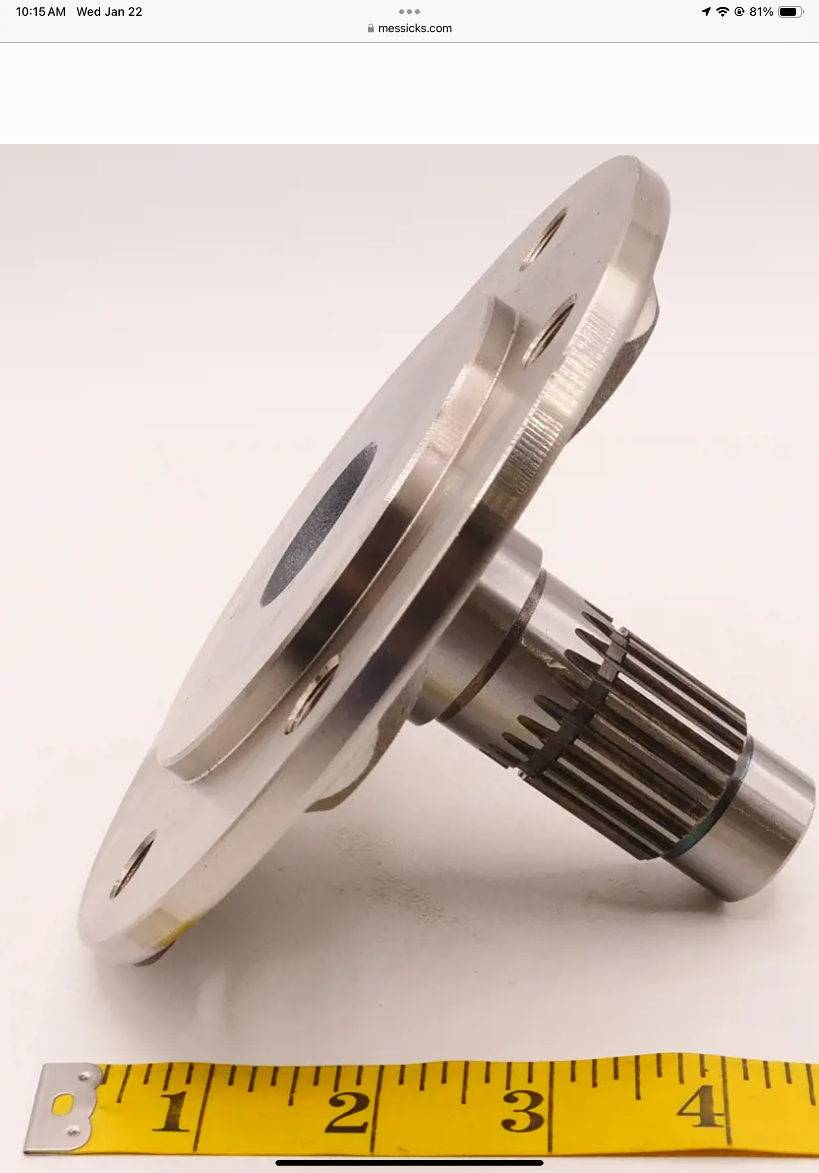

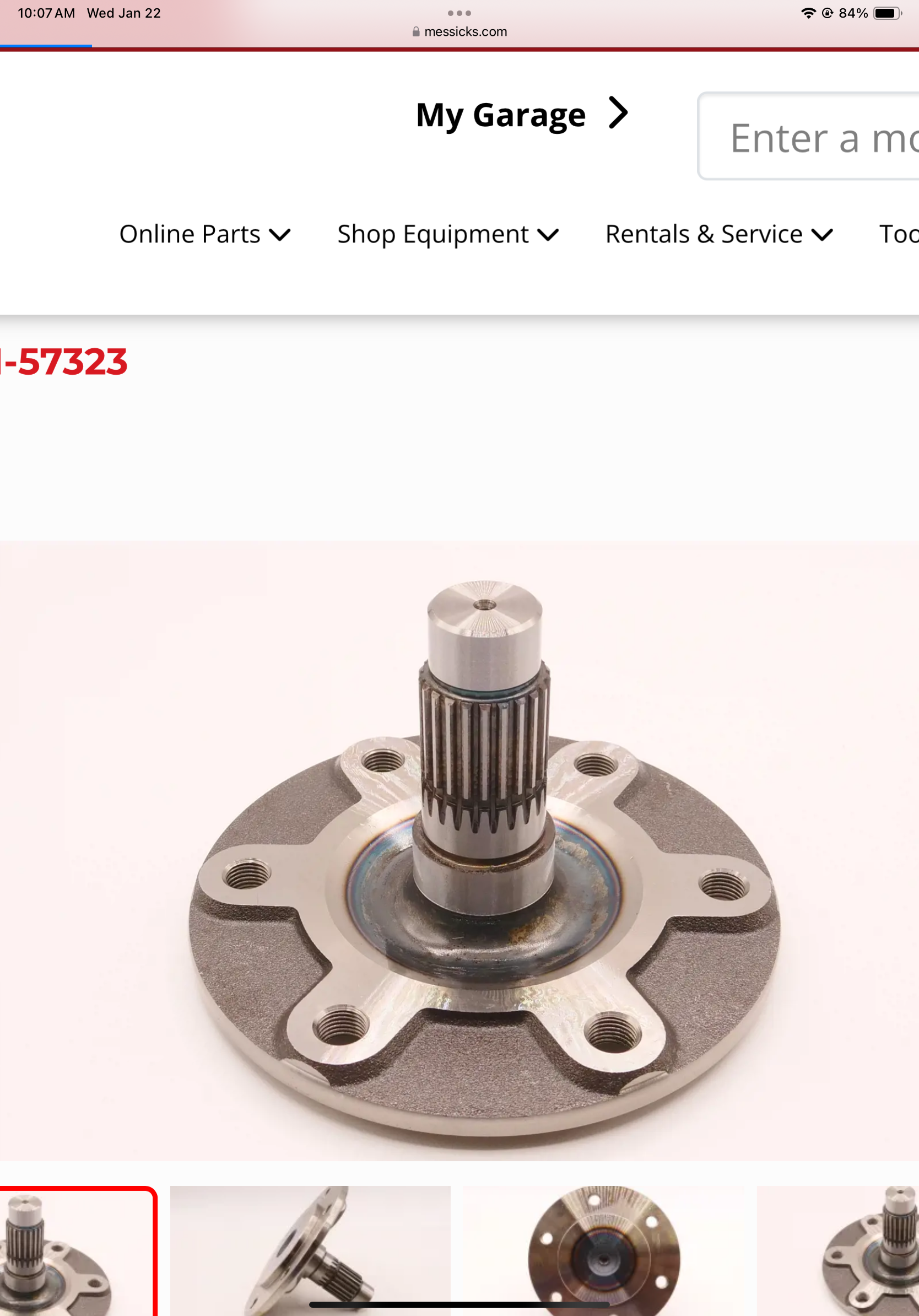

You are correct on the newer version of the front axels (see pictures); however, the older B series can't use the newer version of the front axel. Axel type is based on tractor serial number. You've got to dance with the one that brung you.View attachment 2307203View attachment 2307206
There may be no visible physical changes, but they might have changed/improved the steel type, heat treatment and tempering.
That's called wishful thinking..
I'll bet you, Kubota figures the steel ect.. is good enough, IF you aren't overloading the front end!

   / Kubota B2710HSD front axel sheared off. #54
Looks like cast metal in the axle, not at all good material for that application. Extra caution to stay under the load range.
