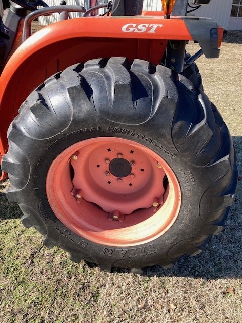

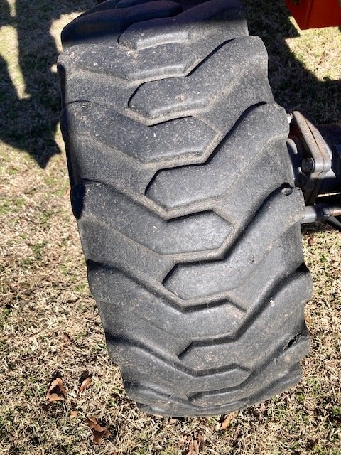

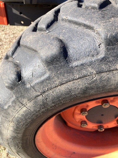

Photos of front and rear

Well worn set of R4’s. Like I said before you got your money’s worth. If you are spinning wheels/ loosing traction replace them. If not and they are holding air just keep running them. They look solid just worn. You can tube them if you have a leak.

To me it looks like still lots of life left in those tires, I would keep running them.
Yup! For more wear on the outside edges, I'd drop them 2psi, this also allows the tires to flex more when running over a larger rock, thus reducing potential brusing/ tire damage.

Those sidewall cracks are nothing. I had a 1957 ford tractor with far deeper cracks. It did have tubes but I also think the tire chains where keeping the tires together.

Keep in mind rubber hardnesses and life is far greater on tractor tires than car tires. Unless they are checked with cracks your pinky will fit in they are good for long time. If you run nail or other sharp edge. They can be tubed and patched. I have seen on one of tractor guy shows a rubber kit to fix cracks. He made it look simple.
