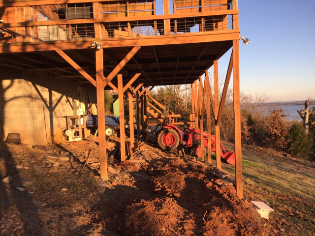

I am using my Kubota L3301 to dig into a wooded clay bank below my house bucket by bucket and bring it up to where I am filling in an area under my deck for parking.
The trip is about 300 ft one way up a 15 degree slope.
Rather than bucket by bucket, should I just stack up a pile of loose dirt then bring it up a scoop at a time or even load it on a trailer or my old flat bed pickup but that means unloading it at the other end also.
This is virgin dirt so I have to work at it to get a scoop full for the trip each time.
I'm thinking of getting a subsoiler to break it up or a toothed bar also.
The box blade doesn't raise high enough to get into it with the scarifiers.
I am going to put the grapple back on and see if it'll loosen up a load a little easier also.
You guys that move a lot of dirt, any tips are appreciated!View attachment 457774
If you are indeed able to get a full bucket of virgin/compact dirt you will make fewer trips. Loose dirt is "expanded". ... With HST it should be possible - no clutch to worry with. Put on lots of weight, push and wiggle the bucket to penetrate.

You need to make sure you are correctly building your retaining wall
The wall will need a foundation and drainage for the water that is behind the wall.
These are two of the biggest reasons for walls failing.
What are you planning to store under the deck?
Due to confined area there is not a good method to dump and compact the soil

lenny
How high do you plan on making your wall
What do you plan to park there
It appears that the wall has no foundation. If so it will move from lateral force and frost heave
Ps nice views

It will only go up about to where the top of the dirt is now leveling from the bottom of left post(side view holding up center of the deck) 3 ft is the normal limit for dry stacked rocks. In the photos, I have pushed the dirt back uphill off the wall in prep of laying another course. This will be a "tie back" course with the long sides oriented up and down the hill and level. Then more dirt compacted on that. I figure one more course after that one.
The "foundation" is unseen. I dug back into the hill on the bottom sloping back slightly and laid sand and about 3 inches gravel for a bed. Then laid BIG flat rocks on that.
I'm in southeast Oklahoma. Our frost upheaval isn't a concern here mostly. The temps rarely get below freezing. I learned how to stack rocks in Vermont from an older gentleman who had done it for years. I remember some of those footings were four feet deep for a three foot wall showing.
I enjoy rock work. Here's my fireplace. ImageUploadedByTapatalk1456131452.406618.jpgBut I hate mixing mortar in the old wheelbarrow and put rock projects off or halfass them. Trying to talk myself into getting a proper mixer.
I plan on parking the implements there mostly but wanted it relatively level and smooth for hooking up to them. ( and it's a nice shady area to kick back and look at the lake and the tractor under there with a cold one!)ImageUploadedByTapatalk1456132009.534901.jpg
