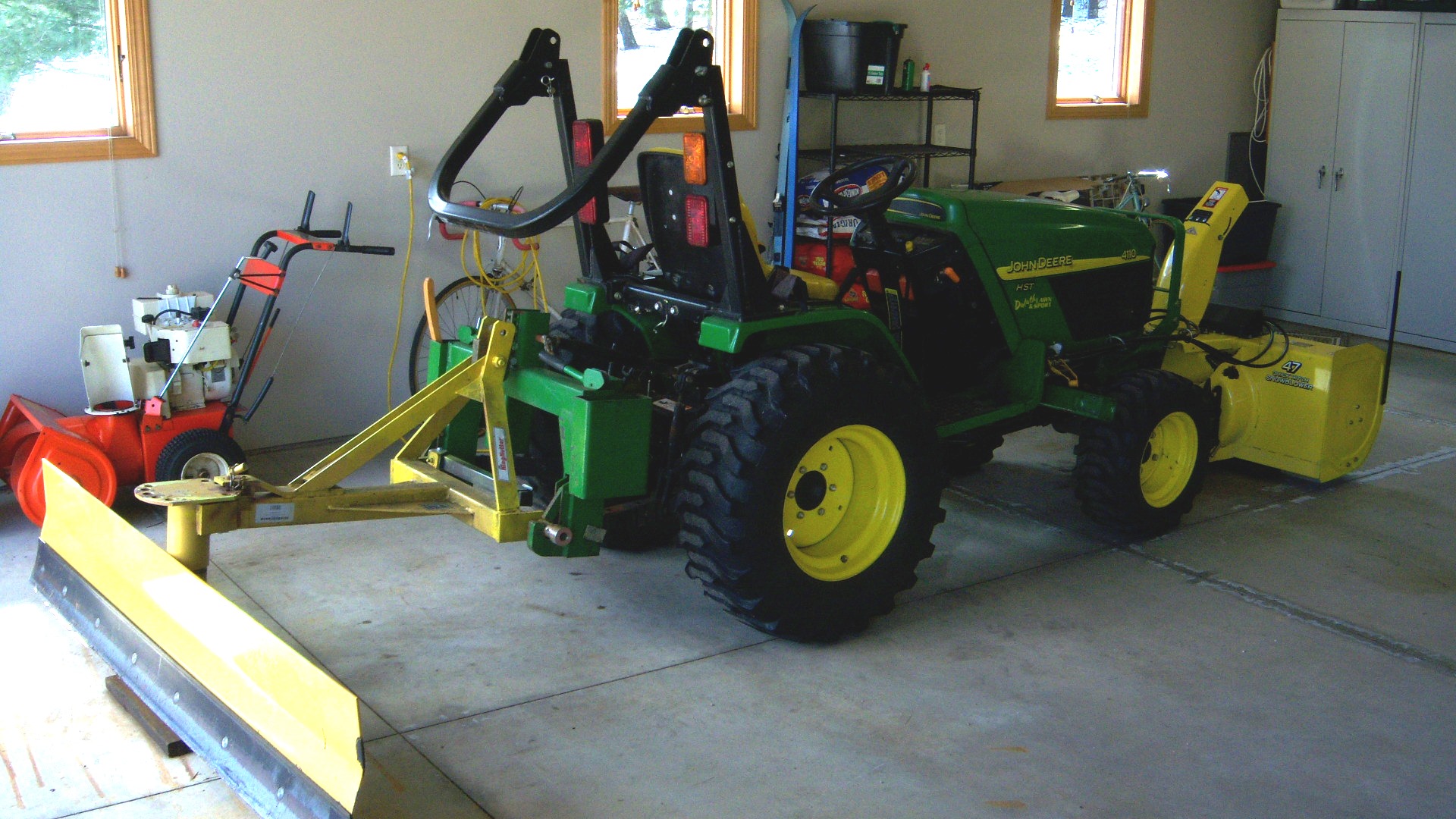

When my blower was unused I had a 7' rear blade attached. Great for pulling snow away from garage doors, mailboxes, etc. and weight.

Well I recently bought a new Meteor 72 inch rear mount 3 point hitch type blower, never used a tractor blower before so obviously I have a lot to learn.
My gravel driveway is about 300 feet long with a pretty good sized yard. For the past 30 years have been plowing with a 8n Ford tractor and a rear mounted plow, it worked pretty well but took 2 or more hours. The new blower will be mounted on a LS XR4155 tractor.
The reason I decided against a front mount blower was because I prefer not to remove the front mount loader and the rear three point hitch system seems like a lot simpler way to mount or dismount the blower.
