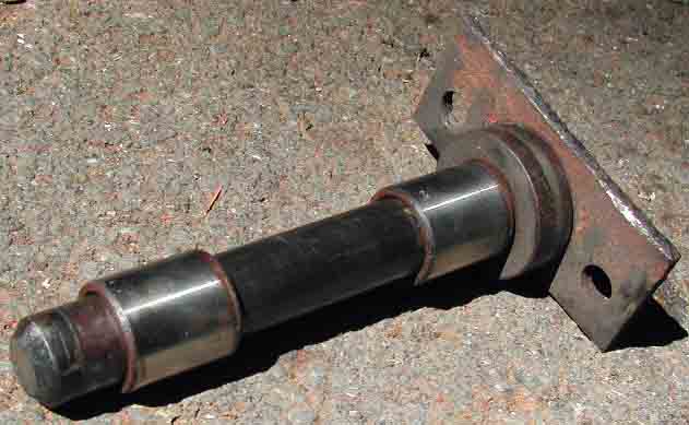

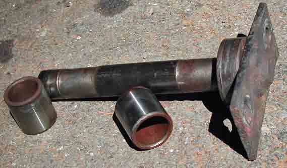

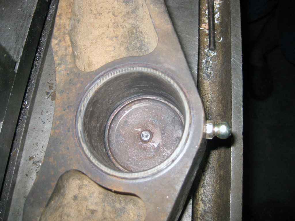

An interesting development in the axle pivot bushings......
I started drilling the pivot and was expecting it to get real painful real quick when all of a sudden I had a hole all the way through. And it took less than twenty seconds. Hmm, strange. Then I noticed this grey-ish dust. Hmm, stranger still.
See if you can figure it out from the pictures before reading the next post.

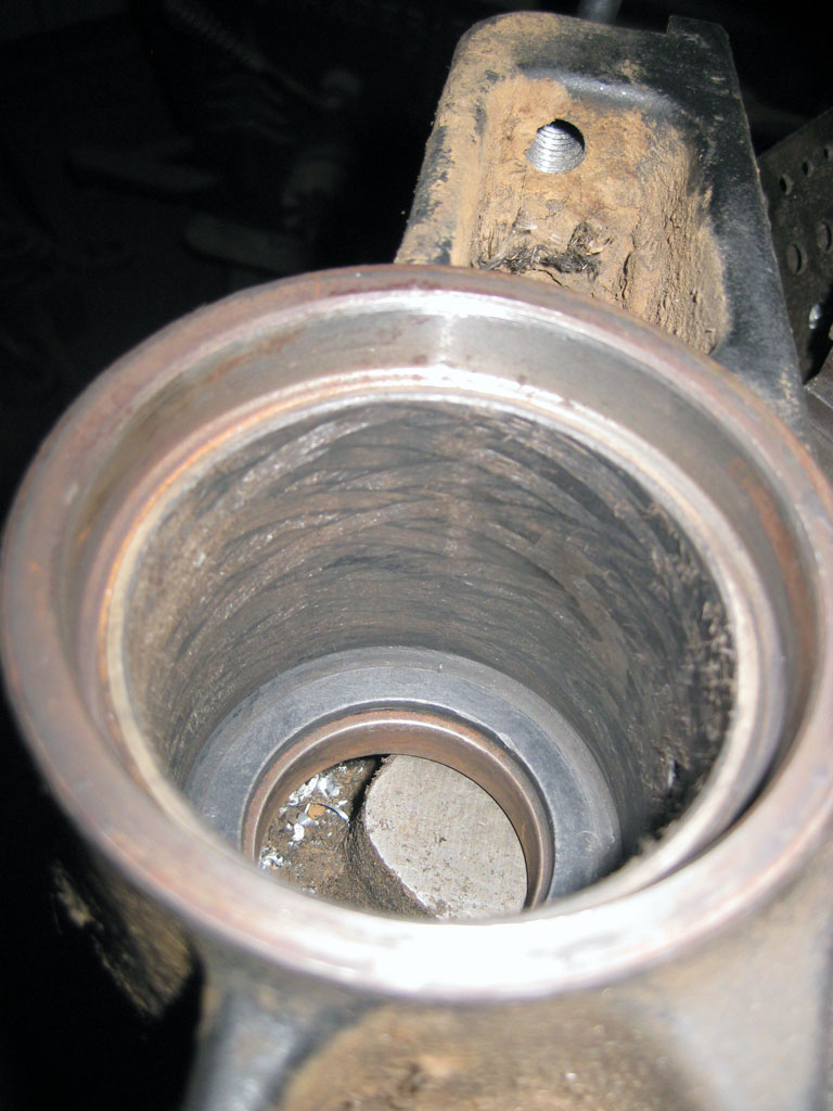

The bushing isn't hardened steel at all!!!! Must be carbon fiber or kevlar! Didn't see that coming... did you?
So how come I couldn't tell before? You can see the petrified grease I removed with every swipe of the towel for ten to twelve swipes per bushing. There was no sign of the fiber pattern until the muck was gone.
You can also see the burrs lefts by drilling. I used my el cheapo $5.99 HF rotary tool to clean it up and chamfer the hole. (I finally found something this thing is actually capable of doing without bogging down under mild pressure.)

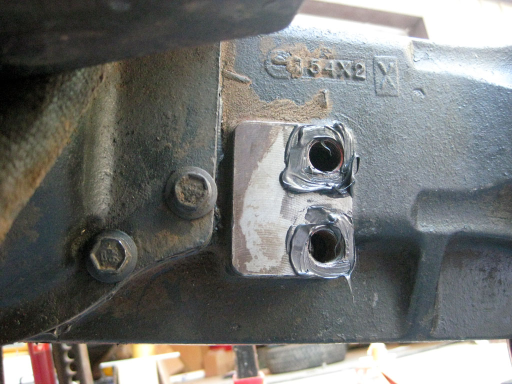

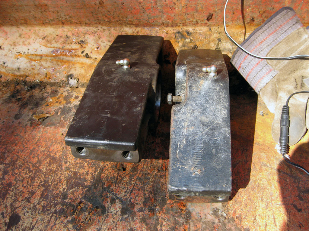

At this point I was debating whether or not I even wanted to add a grease fitting to the other pivot. But in the end my thought process went like this: I don't know how fiber bushings wear in comparison to steel ones, Deere greased it from the factory, Deere added seals intending for the grease to stay there, and it would still be easier to grease via a fitting then the alternative.
The pictures are of the installed fittings. They came out very well, I think.

/ Front Axle Pumpkin Vent #45
[And yes, that is an orange tractor bucket there. Had to use the neighbor's tractor to carry all the stuff to his shop and back. Wowsers.... the fit, finish, NHV, and ergonomics are terrible in comparison to my 4200.]
Looks good!

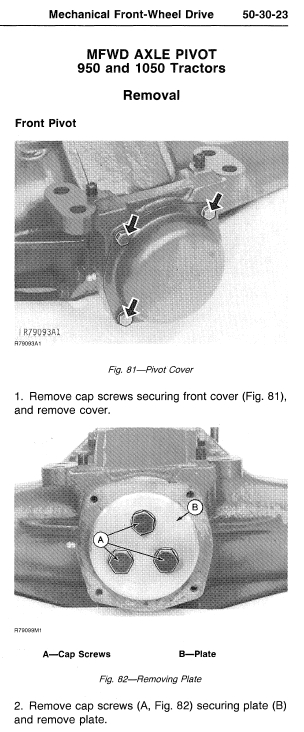

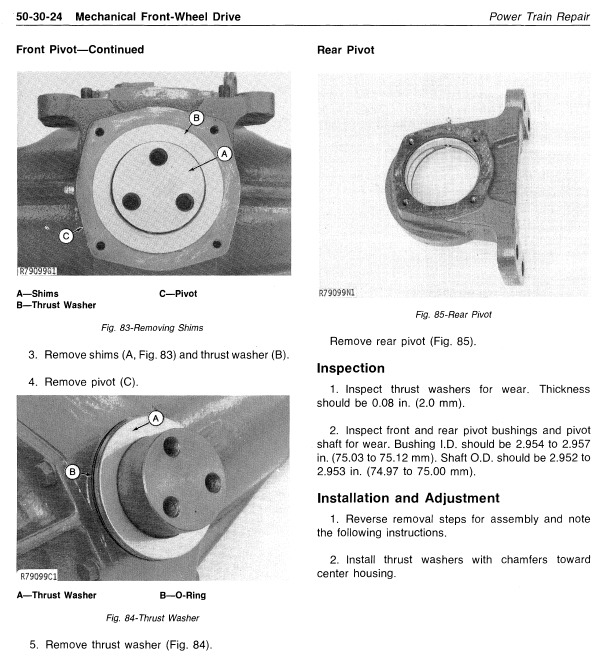

I'd like to see the Deere parts exploded view. Are those fiber bushing replaceable?
Rob

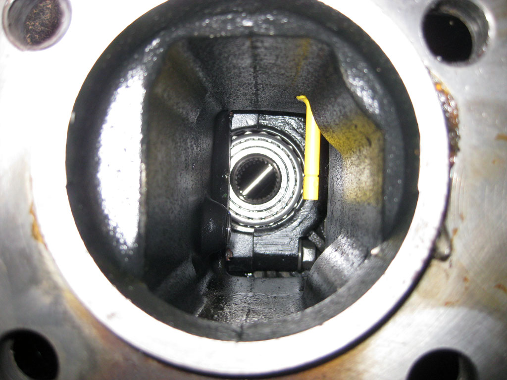

#46
Rob, the parts breakdown is the PDF on page two. I'll have to investigate whether the bushings are inside the pivots or on the axle housing. I'm guessing its the pivots as they look replaceable (middle picture in post #44). I'll clean the axle in the next day or two and know for sure.

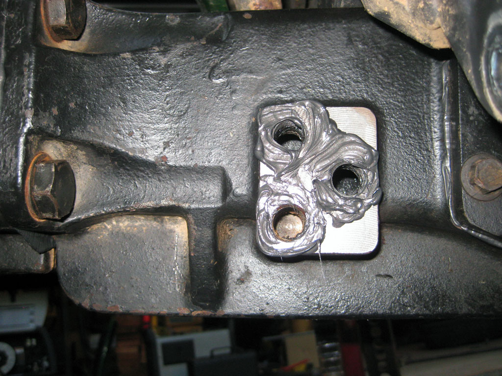

There is no torque spec for the axle pivot bracket bolts. I should have searched better as there are 22 of these bolts installed on the frame. I'm sure the rest have torque specs. So I stupidly chose 215 ft-lbs based on the stronger bolts holding the spindle housing to the axle housing. Unrelated parts, unrelated bolts, unrelated problem created.
The first one torqued to 215 ft-lbs. The second one was taking an awful long time to get there. As I was thinking, "wow this is taking way too long," the bolt snapped in half.
Turning it out with a screw extractor wasn't working well because of the Loctite but it was slowly coming out. My neighbor wanted me to try his "new style" extractors. So I did. Those didn't have any elasticity at all and wham, a little too much torque and it broke off in the hole. So out came the axle pivot. Grrr.
I cut a slit in the bolt and welded a flat-head screwdriver bit into the slit. Then I ratcheted out the broken bolt.
Those bolts happen to be $4.57 each at Deere. At least they stock them. I chose 120 ft-lbs as the new torque spec. No problem there.
Lesson learned: Black & Decker isn't better quality than Harbor Freight.

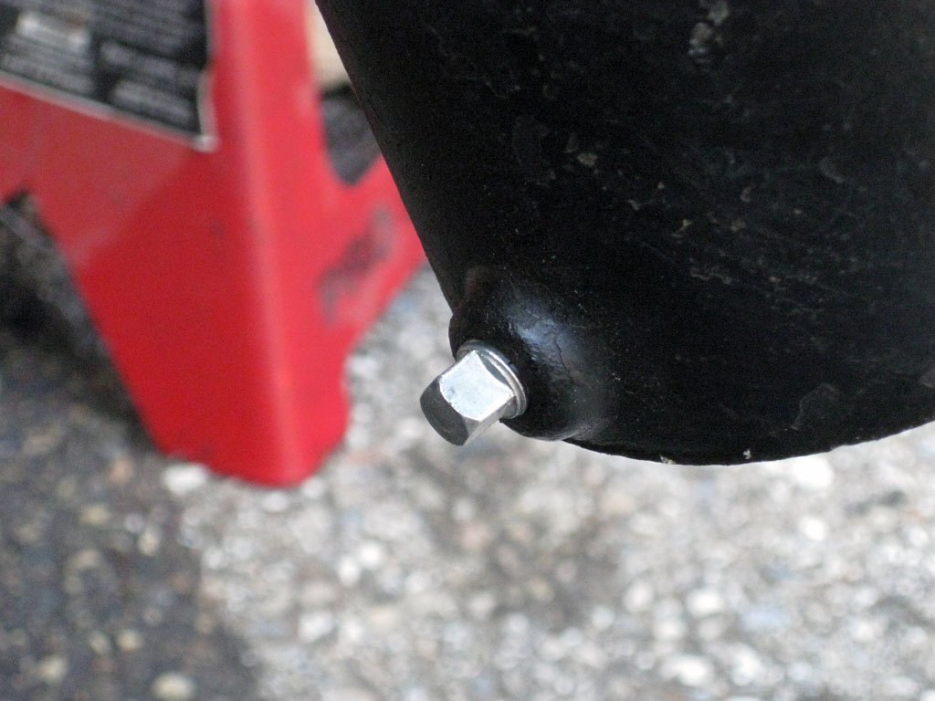

Next a pic of the new square end spindle housing drain plugs. Easier to destroy, but also easier to removed when destroyed.

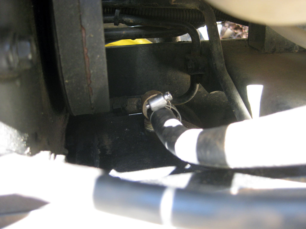

I'll have pictures of the vent hose and it all sewn up shortly.

/ Front Axle Pumpkin Vent #53
Nice pivot zerks, ARRABIL!
I would have used a square-headed drain plug like you did, but I had
already bought a replacement. Yours is superior to the OEM socket-
headed plug because even if you hit it with a rock, you can still grab
it to remove it.

Thats no joke. With 1000 hours on mine, the pivots were just at the wrong end of shot. The fiber was fraying, the lube was gone, the seals were useless. Another couple hundred hours and it would have been loose and then the problems start at the driveshaft, the pinion shaft, the pinion bearings, the tie rods, etc. And who knows how much side force the driveshaft connection in the rear of the tractor can take.
For anyone who is concerned.... the seals tell the tale. Get a flashlight and some kind of poker that isn't sharp and see what the seals look like. One on each side, they'll be the rubber pieces closest to the axle housing. Post #49 has one good picture and (kind of) one installed picture of the rear side. If they're cracked or frayed all around, dry-rotted, missing, etc., I'd be concerned enough to do something about it. You can remove the axle pivot slack bolt at the front of the forward pivot to give yourself some room (but only if you lift the front off the ground so the axle can move freely). If you don't move the locking nut touching the pivot bracket, you can put it back exactly how you found it.

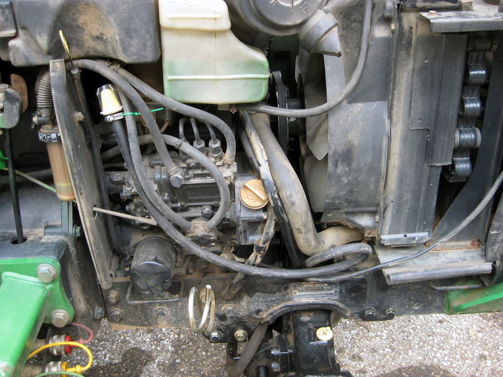

And the final installation pictures....

/ Front Axle Pumpkin Vent #60
Looks good!
I noticed a couple things in your last photo.
Is that an add-on device to hold the FEL hoses (A in the photo)? I have
not seen one on any 4300, and it would come in handy.
B in the photo looks like your fuel overflow drain tube. I hope it is not
getting pinched between the valve cover and the intake hose....that's
what destroyed my engine.
