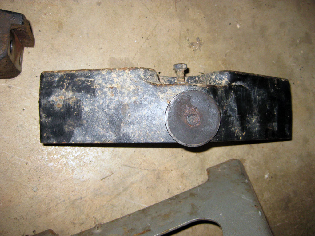

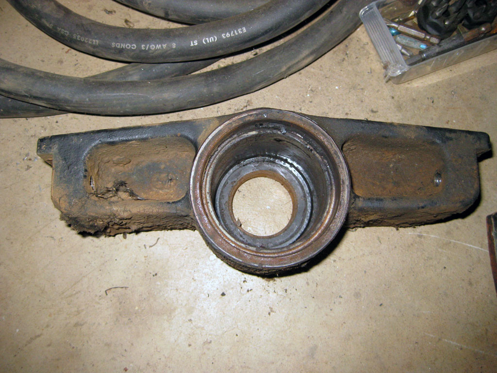

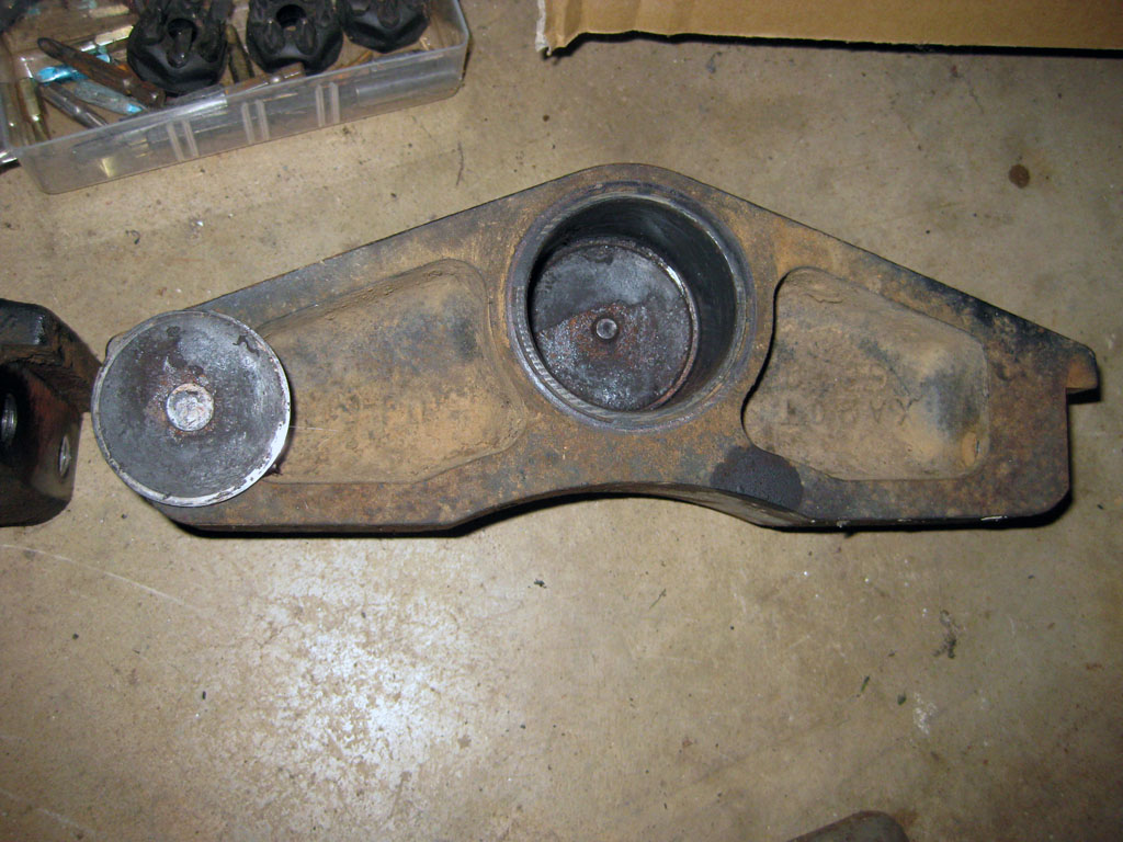

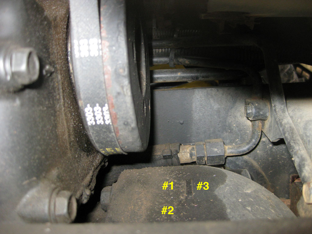

Some pictures of the axle pivots on the axle. They're hardened sleeves. They don't look good in my opinion. I think something needs to be done here. At the very least a good greasing.
This is what I wanted to see most. I debated long about taking mine
apart to inspect the pivots since they were very accessible with my
whole engine subframe off. But there was no wiggle in them at all and
both seals were in place. They are large diameter pivots, too. What
would you say their diameter is?
These are nothing like the axle pivot on my 955; it was only a single 25mm
shaft, and tough to remove. Mine had failed because it takes a LOT of
grease to properly fill the cavity in there. It is bizarre that that the
4x00s are not greasable.

And the seal was an interesting bit.... The dry rot is currently at the lip which contacts the bracket. It didn't look bad until I removed the bracket. You might have the same problem.
Good description.... bizarre. I've decided not to replace the bushings. Too much pain involved. Haven't looked at the thrust washer in detail yet. But I'm definitely adding a grease fitting to each bracket. This whole exercise may have started out under dubious pretenses but what I've learned about the pivots makes the whole thing exceedingly worthwhile. I think anyway.
The pivots look to be at least 1.5" in diameter. That is confidence-inspiring.
Also, the fact that they did not slide off the two supports easily means they
have not developed a lot of clearance (wear). That is also good, unless
rust has built up to keep it tight. The inner and outer wear surfaces are
hardened sleeves...another good thing. I will post a photo of my failed
955 pivot when I take one. It had hardened sleeves acting on a
not-so-hard shaft. Even without zerks, the 4x00 pivot looks like
a big improvement. I wonder how the budget CUTs of that era did it
(JD950, JD970).

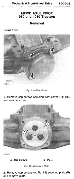

(JD950, JD970).
The 950/1050 used a similar pivot to the 4x00, but did have grease fittings on both ends. (You might be able to see the bright object on the sides in the pictures.) The 670/1070 used the hanging type pivot similar to the x55 and also had a grease fitting, although done differently than the x55. The 850 used the hanging type pivot but I have not yet found a grease fitting on it. It may not have one since the 650/750 also use the hanging type and did not have a grease fitting.
