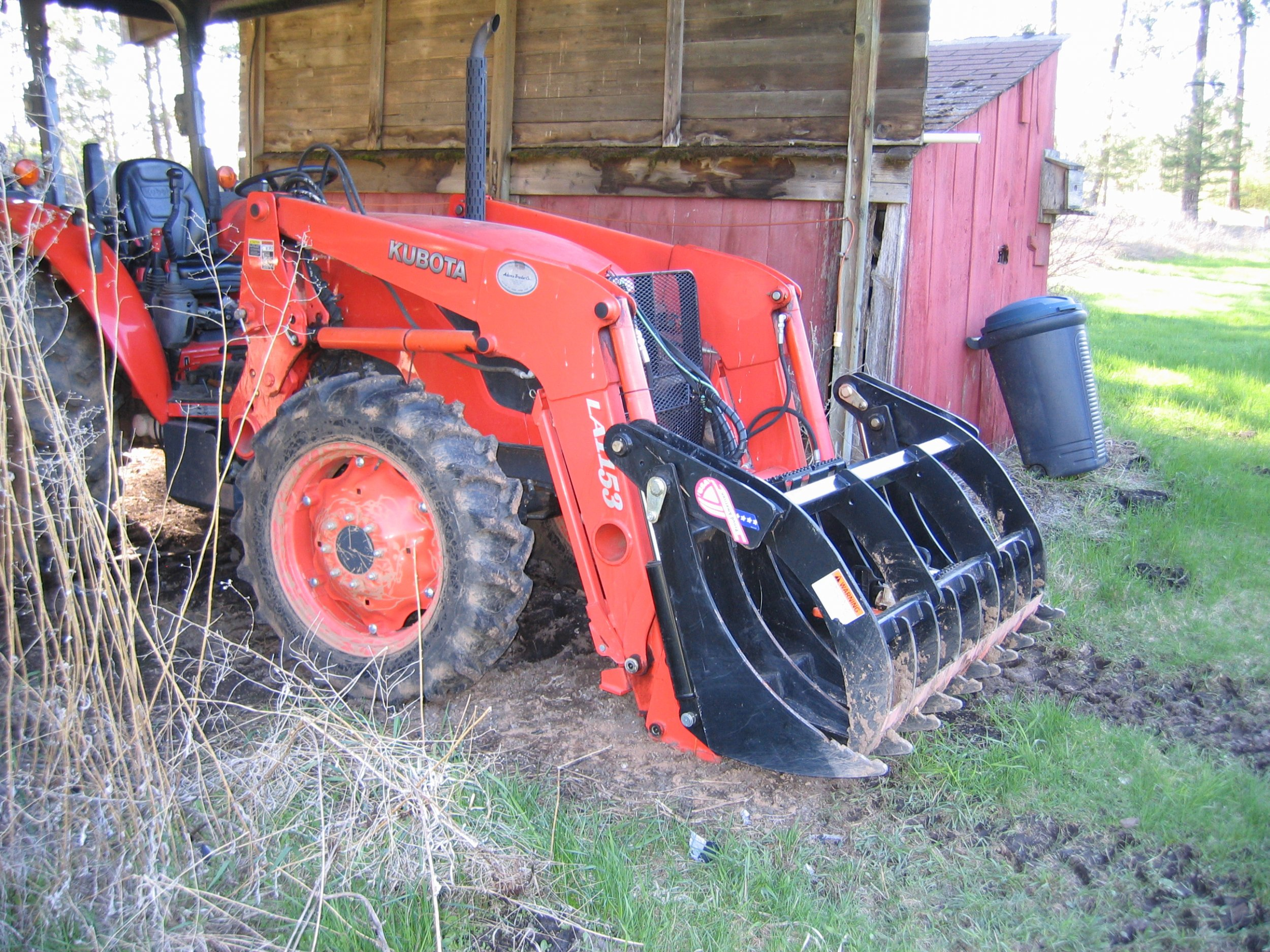

I have a forward pointing vertical exhaust on my open station Kubota M6040. Never bothers me. Sorry - just noticed you are asking about horizontal exhausts. I would guess they are not a problem either. But take a look at the picture of mine. Vertical with a tip that directs the exhaust gasses horizontally. Whatever - in use the exhaust gasses are never noticeable. View attachment 694001

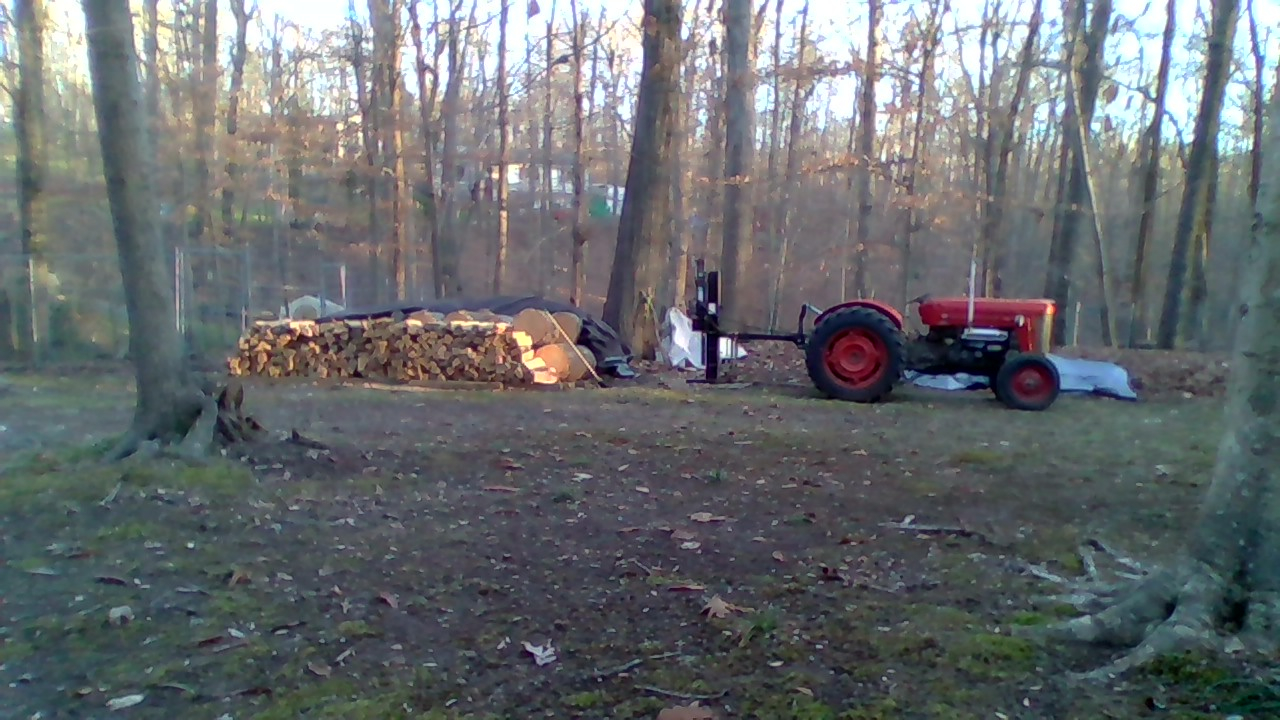

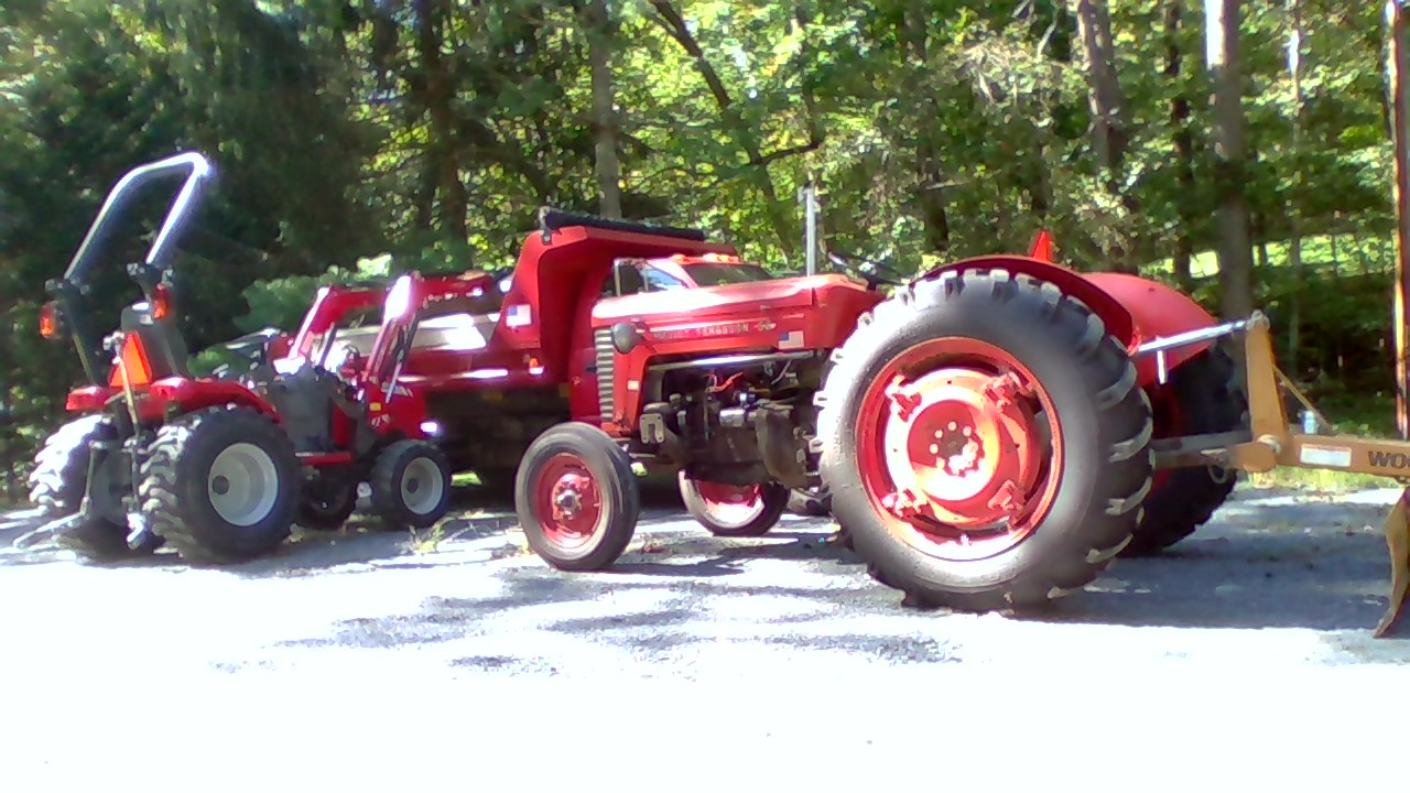

I own a 1959 M-F 50 gasoline that came with a horizontal exha
ust & I converted to vertical do to exhaust fumes using my log splitter & I'm glad I did! If your not using a aft mounted implement that requires to stay at the rear of the tractor while it's running than your okay going horizontal
   / Forward Exit Horizontal Exhaust?? #40
I own a 1959 M-F 50 gasoline that came with a horizontal exhaView attachment 694441View attachment 694442ust & I converted to vertical do to exhaust fumes using my log splitter & I'm glad I did! If your not using a aft mounted implement that requires to stay at the rear of the tractor while it's running than your okay going horizontal
Also on my newer 2018 M-F 1526 it has a mid mount forward exhaust horizontal that there is no problem with exhaust fumes ( diesel )
