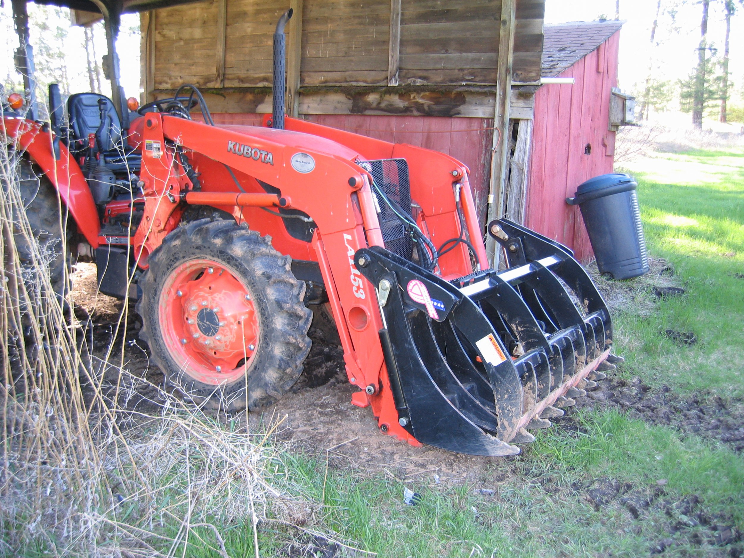

I have a forward pointing vertical exhaust on my open station Kubota M6040. Never bothers me. Sorry - just noticed you are asking about horizontal exhausts. I would guess they are not a problem either. But take a look at the picture of mine. Vertical with a tip that directs the exhaust gasses horizontally. Whatever - in use the exhaust gasses are never noticeable.
