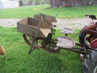

My dad had an old one row 3 pt tobacco transplanter we used to set out tomato plants. Talk about getting gassed by the rear diesel exhaust. He claimed I couldn’t drive a straight row so I always got transplanter duty. He was no dummy. :sneaky:
Similar to this:

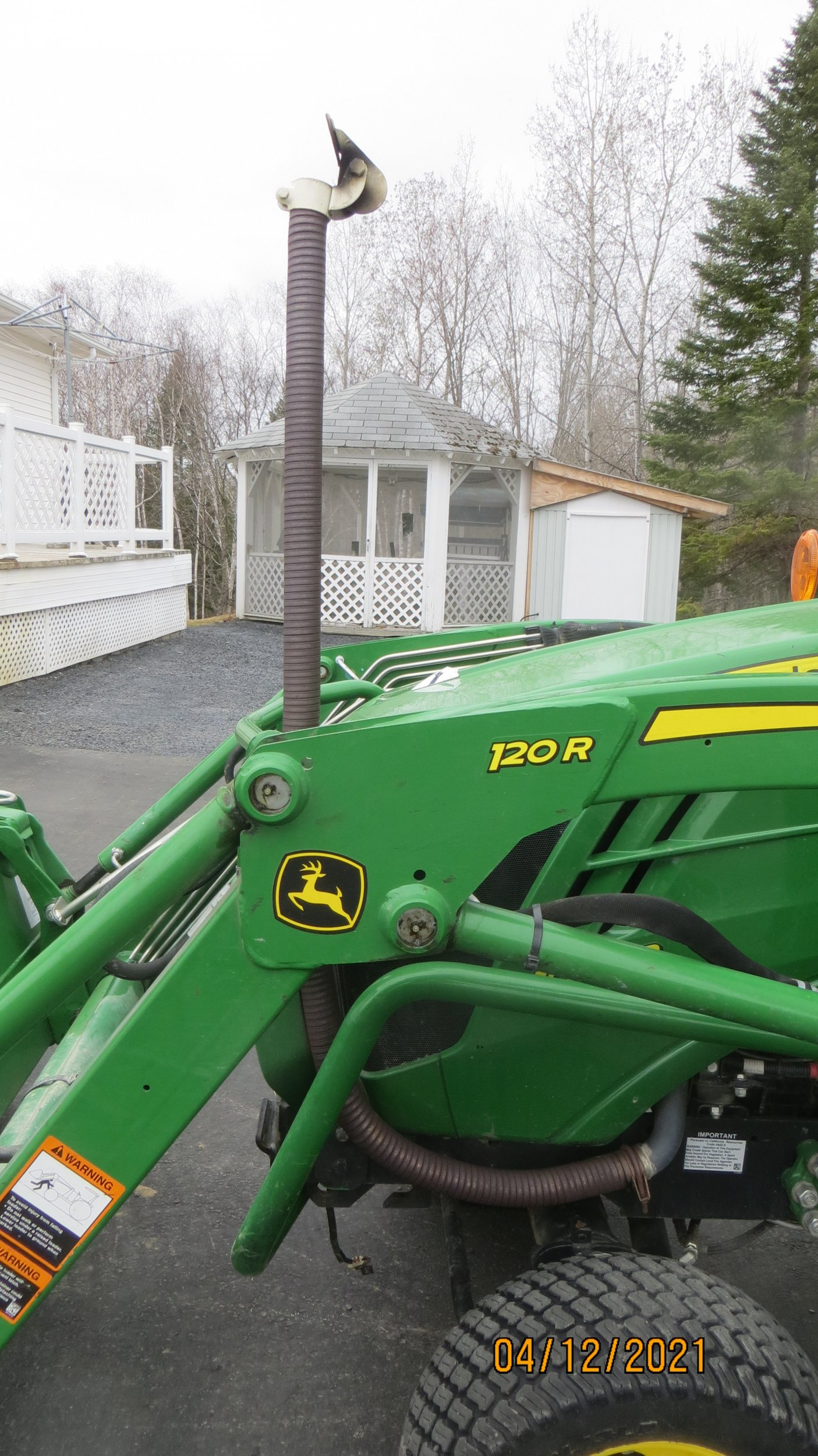

I have a John Deere 1025R that I put an upright pipe on with a flex cap on top and I do have the surround cabin. Before I fixed it up - the exhaust would be down and forward - which heated up the front snowblower in the winter and made quite a mess of re-frozn snow packed in the blower. During the summer with the doors off - I have no problems with the exhaust coming to me.

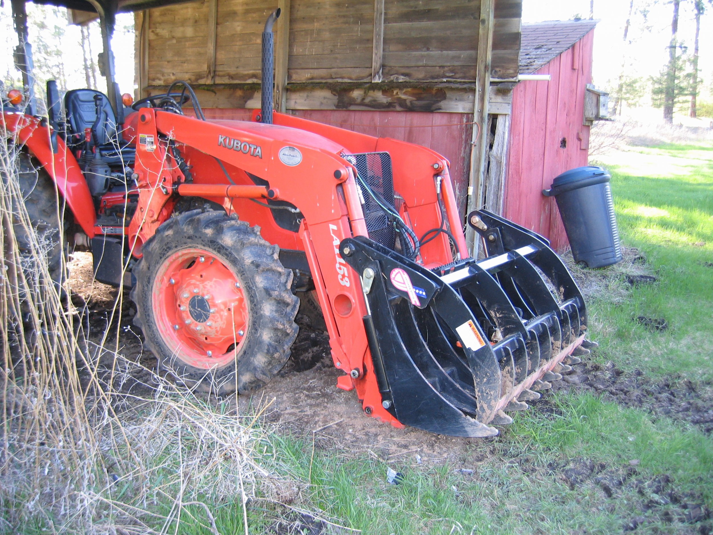

I have a forward pointing vertical exhaust on my open station Kubota M6040. Never bothers me. Sorry - just noticed you are asking about horizontal exhausts. I would guess they are not a problem either. But take a look at the picture of mine. Vertical with a tip that directs the exhaust gasses horizontally. Whatever - in use the exhaust gasses are never noticeable. View attachment 694001

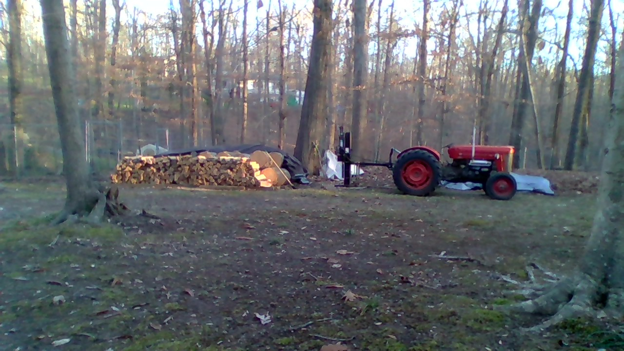

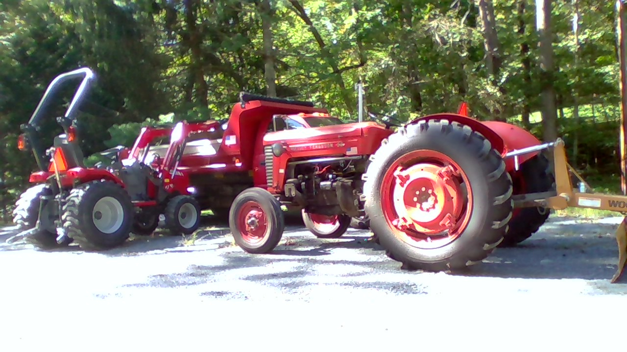

I own a 1959 M-F 50 gasoline that came with a horizontal exha
ust & I converted to vertical do to exhaust fumes using my log splitter & I'm glad I did! If your not using a aft mounted implement that requires to stay at the rear of the tractor while it's running than your okay going horizontal
/ Forward Exit Horizontal Exhaust?? #40
I own a 1959 M-F 50 gasoline that came with a horizontal exhaView attachment 694441View attachment 694442ust & I converted to vertical do to exhaust fumes using my log splitter & I'm glad I did! If your not using a aft mounted implement that requires to stay at the rear of the tractor while it's running than your okay going horizontal
Also on my newer 2018 M-F 1526 it has a mid mount forward exhaust horizontal that there is no problem with exhaust fumes ( diesel )
