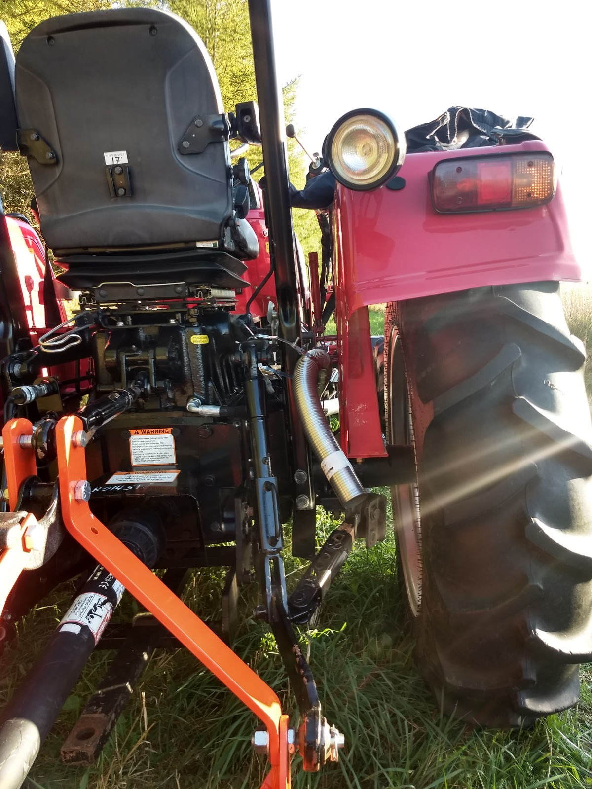

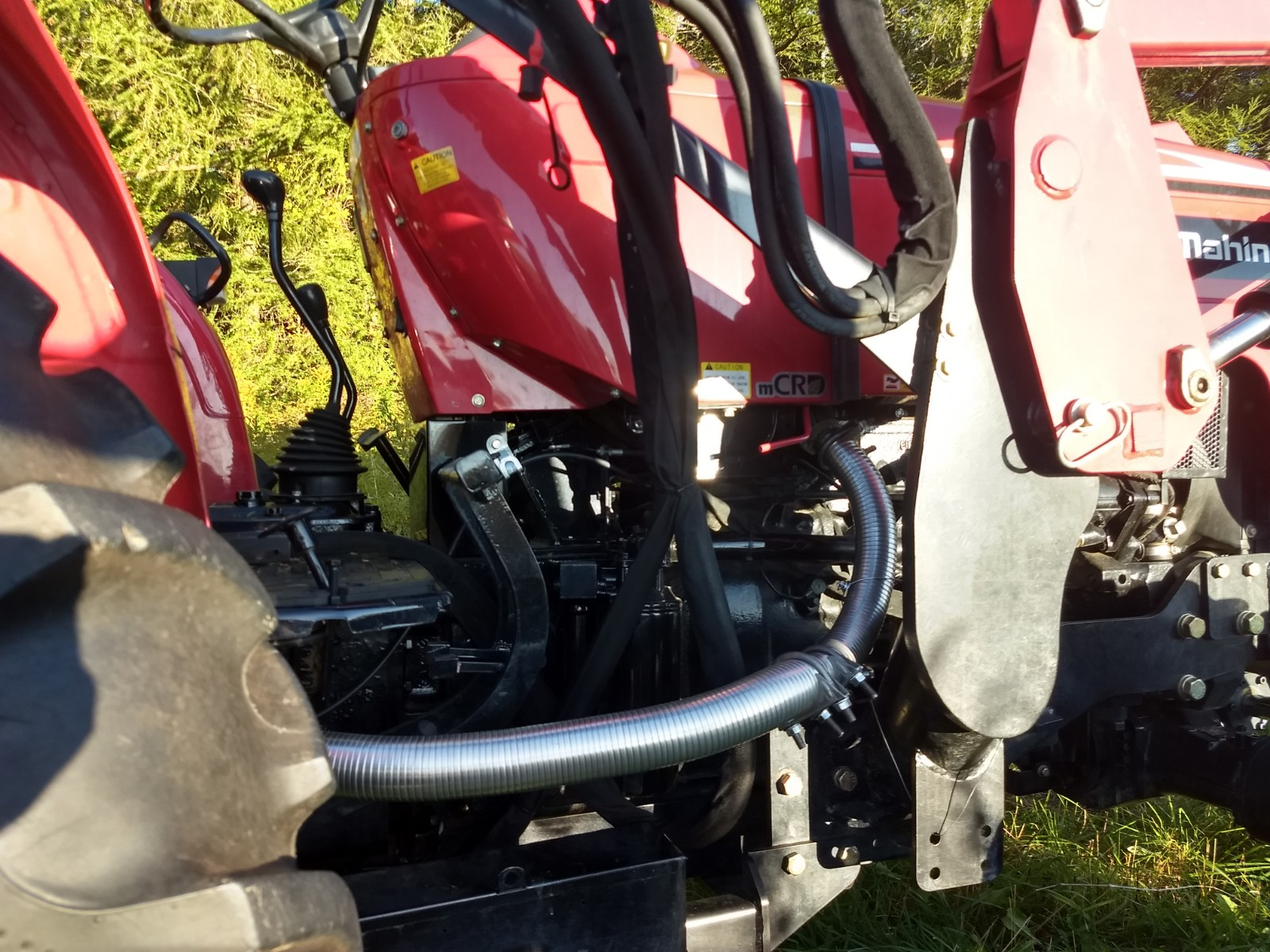

The exhaust on my Mahindra 4550 side vents about 2.5 ft forward of the brake pedal, well placed for fumes to waft across the driver. A Hamiltonville Farm video on youtube gave me the idea of using an 18" flexpipe to point the fumes lower. That didn't make much difference, so I took a 6' flexpipe to the lower front of the tractor along a path with few obstacles, but the fumes still managed to make their way back to the driver.
Finally I found a path for 7' of pipe exiting behind the driver's seat and that worked great.

   / Forward Exit Horizontal Exhaust?? #55
That is a crazy OEM exhaust location. Doesn't make sense, almost like they forgot to install the exhaust system!
Good job fixing it.
   / Forward Exit Horizontal Exhaust?? #56
I have to agree, it looks like they didn't finish assembling the tractor, you've done a better job of engineering it than Mahindra did.
