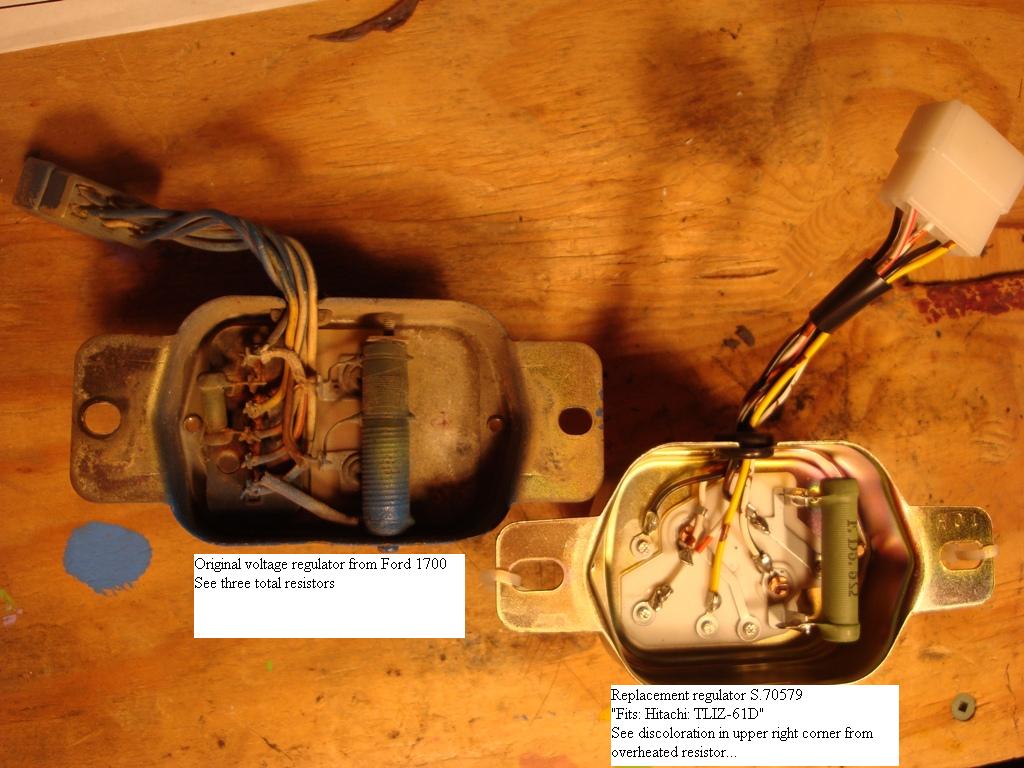

After replacing the alternator I found that the voltage was not being regulated. I took readings of over 15.5v at the battery. The voltage kept increasing as I increased engine RPM. I determined that my dad was right - the regulator was bad. I searched online for a regulator (PN SBA185516030) and found several sites selling an aftermarket one, PN S.70579 made by Sparex. Upon receipt of the new VR I noticed that its construction was different from my old one. It had only one resistor, while the old one had 3.
OK. We're almost there. So I installed the new regulator, cranked up the tractor, and took voltage readings. Everything seemed great. I was happy to see readings from 14 to 14.5 volts even at around 2500 RPM. Just as I was patting myself on the back, I noticed little wisps of smoke from behind the fuel tank. I groaned and shut off the engine. Pulled the tank and looked at the regulator. I could see some discoloration in the metal near the resistor, but nothing else that looked burned. I mulled it over for a while. I talked myself into thinking that maybe it was just some manufacturing coating that was burning off. Maybe it was normal? So I pulled the regulator out and secured it to the top of the instrument panel so I could get a closer look at it with the engine running. Cranked it back up and measured the voltage. Still all good. I expected to see the relays on top of the VR chattering as they maintained the appropriate voltage, but I could not see them move at all. About a minute later I saw and smelled the smoke again. The resistor was indeed very hot.

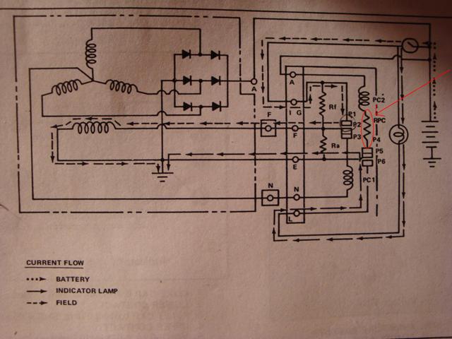

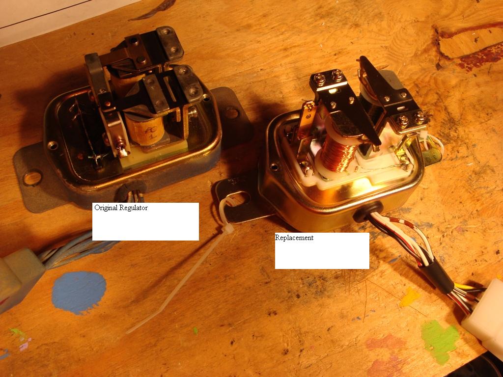

I began to inspect the regulator more closely. On the outside it actually more closely resembles the VR for a Ford 1300 (according to my shop manual). Now, my shop manual also has the wiring schematic for the VR. My original VR matches it exactly. But the replacement one is far from the same.
1. Is it possible that the replacement regulator is supposed to be so different from the original? That they changed the internal wiring so much?

Pics below of the old vs new regulators...

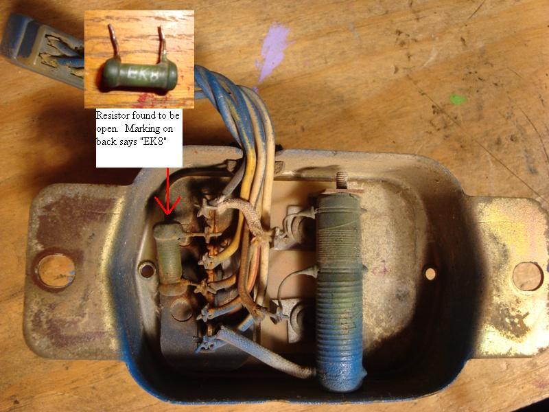

Caliche, I looked through the documentation that came with the alternator. There is no schematic, but there was a tech help web site listed, www.onlinetechhelp.com that allowed me to search for the PN 14105. Several models came up, and I picked the one I have. It states that it's a Hitachi alternator, has an external regulator, and is rated at 35 Amps. I believe it is a nearly perfect match for the original equipment, except that I think the original was only 20 Amps.
JC, you're probably right... it would have been easier to just get a combo unit... But I'm not ready to do that just yet. I just don't get why the new VR that supposedly replaced the original is so different. I went ahead and had the NH shop order one they recommend so I can look at it.
In the mean time, I figured out the component that is bad on my original regulator. There's an "open" resistor in series with the sensing coil. That's not allowing the relay to chatter to maintain the appropriate charging voltage.
I plan to replace it, but I don't know what the resistance is. There's a marking on the bottom that says "EK8". I figure it's a low resistance and only there to drop the current a bit. Unless some other adventurous 1700 owner wants to open up their regulator and measure the resistor for me :laughing: I'll probably just try a 10 Ohm 1W or something to see if it works.

I measured 31 ohms for this resistor on my VR. I have the same 1700 with an external regulator. I hooked my battery up backwards, and started the tractor. It seemed to run just fine, but zapped the rectifier diodes. VR looks fine.

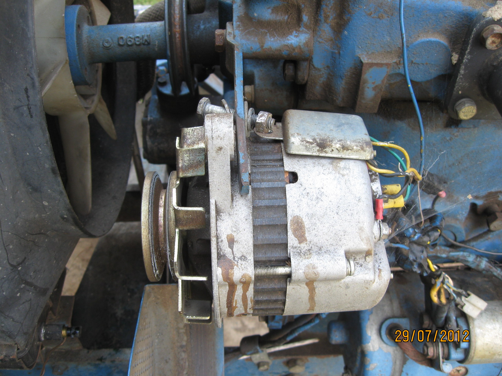

I had a local alternator shop install a new alternator a couple of years ago and they installed the external regulator shown here attached to the alternator. Haven't had a minutes trouble with it. Tractor is down now while I am waiting for a new water pump to arrive. Jerel

Yes, solid state regulator. Alternator is:
WPS
Model: 1-1111-01HI-2/1405
Serial: 218L1
12 volt
35 amp

I took a look at the old one, and it seems to be ok. The small resistor is measuring 32 ohms, and the large one is measuring 42 ohms to the middle tap and 0.4 ohms from the middle tap to the other end. I guess I'll try to clean the relay contacts to see if that will help?
