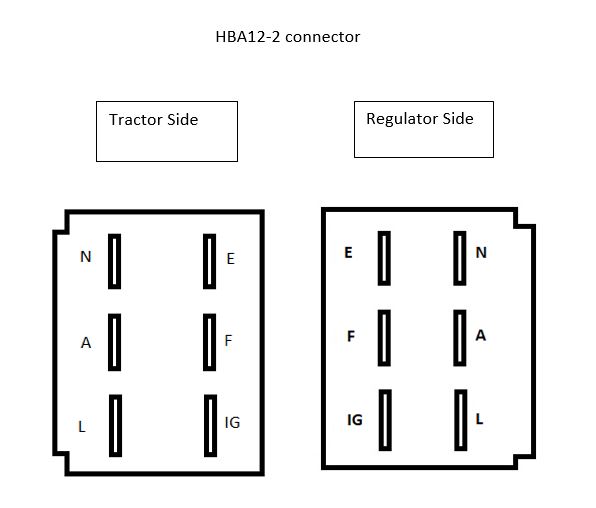

I still have not gotten my alternator / external regular working, and now that spring is here, I need to get it sorted out.
I went ahead and ordered a Hitachi LR135 alternator. This one is used on '78 and later Datsun 620 trucks and are internally regulated.
I came to this place:
And the wiring looks dead simple:
$70 from Advance Auto with a $20 core:
So hopefully I'll be back in business soon.
/ Ford 1700 - Voltage Regulator replacement #31
Swapping in an alternator with an internal regular fixed it!
Here's external vs. internal:
They are virtually identical. Even the little booklets are clearly from the same place:
There is no need to change the wiring on that little T-connector on the alternator.
The N terminal (labeled S for Sensor on the new alternator), goes to 12V from the ignition.
The F terminal (labeled L for Lamp on the new alternator), goes to the Charge Light.
To accomplish both of the above, all you have to do is to cut the connector off the old regulator and then jumper a couple of the pins together like this:
N is jumped to IG to provide 12V to the Sensor input on the new alternator.
F is jumped to L which allows the Lamp signal from the new alternator to control the charge lamp in the dashboard.
Works like a champ now. When the ignition on and engine not running both the low pressure and charge lights are on. Once engine is running, the charge light goes out and I get around 14.6 volts across the battery terminals.
Just waiting on my new T-connector pigtail to come in, and I'll swap out the original one and complete the wire loom.
Hope some will find this useful in the future. Oh and the alternator came with unlimited lifetime warranty.

pclausen, you didn't have to wait too long; I found it very useful. This was my exact problem on a Ford 1700 I'm bringing back to life. Thanks for sharing everything! Links were all very helpful, as well as your guide to the pigtail for the voltage regulator. I thought I'd be done with the swap tonight but I bent the old top mount bolt pulling the old alternator off - next time I'm at the shop I'll be able to check everything.
To offer even more help to the next guy, I found the alternator pclausen ID'd on rockauto by looking up a Nissan 620. No warranty on their website, but you can get the alternator for $35-$45. I tried the PureEnergy offering.
RockAuto 14231 Alternator for 1978 Nissan 620 Pickup
Seems like a $45 alternator upgrade is the ideal fix for a bad $65 external voltage regulator.
