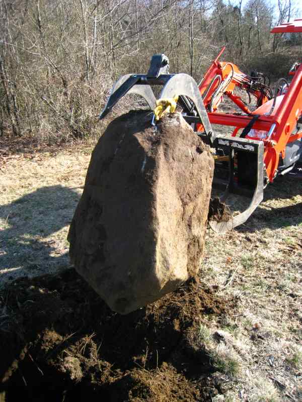

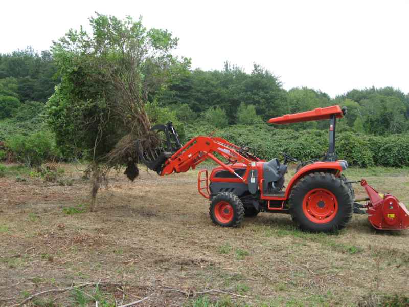

With a strong loader and heavy tractor it is possible to do a good deal of what a BH does but not nearly as efficiently. I have a Kioti DK40se with both a BH and some FEL attachments like a grapple, real forks, a tree boom, 4n1 and the Quickspade in addition to the standard bucket so I have tried various tasks with different implements.
For digging trenches up to 42 inches or so the quick spade will work but it is very slow compared to the BH mostly because you need to constantly move the tractor to dump spoils. The quickspade does work well though and I've even used it to undermine some monster stumps that even the BH was having trouble with. I have the quickspade mounted on beefy skidsteer forks and that is much more flexible than just the bucket mount version.
I don't own a stump bucket (yet) but if I did not own a BH I'd have one for sure. Being able to concentrate force as well as minimize disruption of soil is a big advantage over the standard bucket. In fact, I rarely have my standard bucket mounted for anything. The grapple versions are quite expensive and limited to stump removal. I'd just budget a bit more and get separate stump bucket ($350-500) and light duty grapple ($1000) as a much more flexible combo. Easy enough to chain a stump or bush once you've dug it out with a stump bucket so unless you are digging out lots of stumps (in which case the BH really makes more sense) then the stump bucket seems a very useful partner to a strong FEL.
For taking down trees, I have almost stopped using a chainsaw at all and use my BH with a ripper blade. I've posted a bunch on this last fall. One thing that occurred to me while using the ripper/BH is that it would not be hard to rig a ripper blade for the FEL that could cut tree roots just like the BH ripper does. That allows you to push over the tree (again with a reasonably heavy tractor like the Kioti) and the benefit is that there is virtually no hole to fill after the stump pops out by itself. I haven't used a ripper/FEL nor have I seen that anyone has done it but with a strong loader and heavy 4wd tractor it should work. I have a QA attachment plate that has a 2x2 hitch mount and it would not take more than a few hours of cutting, grinding and welding to produce a ripper claw to fit the hitch mount. My BH ripper is about 24 inches deep but a shorter one would work too. I don't know whether it would be better to rip up by plunge and curl or rip back by plunge and reverse drive but with a hitch mounted ripper you could reverse it easily to see which was most efficient. The ripper also works very well to prepare shrubs for transplant or removal.
I will mention just quickly that a grapple can also accomplish some of the tasks associated with a BH. A narrow 48 inch grapple can dig under moderate size stump roots. It is not as fast or efficient as the BH but I removed quite a number of stumps with the grapple when I did not have my BH mounted. Easy to pop out rotten stumps and usually any stump less than about 8 inches across was removable with 15 minutes work. Make sure to have something heavy like a BB or mower as rear ballast as otherwise you'll just be lifting the rear of the tractor. A grapple is also very good at getting out rocks.
I'll finish by saying that I have never regretted getting the BH (Woods BH90x) but if I didn't have it, I could do most of the tasks with a combination of FEL implements and a strong loader. The Kioti loader lifts 2700lbs and you'd want something like that to do the BH replacing work.
