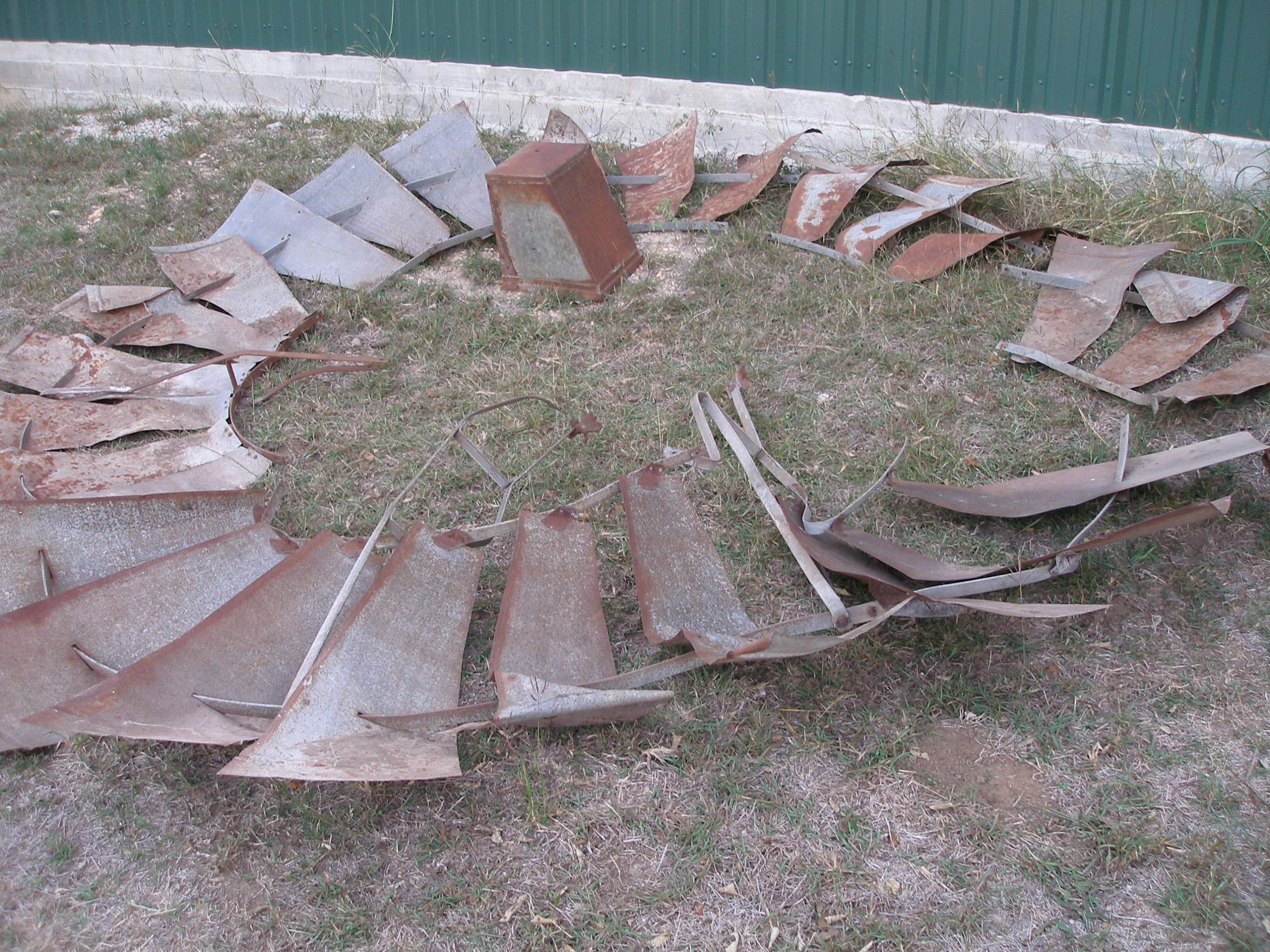

Ok now that I've seen the blades here's my take on your project. Initially you need to determine what's good and what's bad concerning the metal. I see some that are salvageable and some that are not. Is this to be a working windmill or yard art? Depending on what your intentions is how far you are going to have to take this project. If it's yard art then straigthening, cleaning and painting will all that's needed. If it's to be functioning then you will need to determine what's good metal and what's bad. Some of those blade look pretty bad to me. After carefully removing all blades from the rings determine which blades are just to far rusted/corroded to work with and set those aside for now. The better looking blades will probably just need some minor work with the dolly and hammer. The metal looks to be about 18 gauge so it will be relatively easy to work with. After disassembly first clean everything up with a wire wheel on a drill or if you have a compressor a 90 deg. angle grinder. Once you have everything cleaned then you can move on to shaping/straigtening. Use the blades that are the worst for you practice (that's why I said set them aside). You will need to purchase at least one sheet of steel the same gauge as the blades (my area 18 gauge 4x10=$112). Now you can use metal shears or if you know someone with a plasma cutter (nice toy, I don't know how I got along without one:) ) you can use one of the blades as a template and cut the number of blades you need. You will also need to find someone with a bead roller to create the the bead at the top of the blade (again strength).
That's just starting. Maybe those $20 blades aren't so exepensive after all. You have quite a project and will be looking forward to how you accomplish it. As I've said earlier I do metal fabrication as a hobby and am only just beginning to get "adiquate" in it. What I've found so far is that to do the job right it takes alot of patience and the right tools. I have found bargains in tools that has made it much easier such as a plasma cutter I got through Northern tools for under $700 (on special). But you can do the job with basic hand tools also.

Removing rivets, drill to just below the head, with one size smaller bit, say 3/16 rivets use a #11 or 12 bit. Anyway, center, (with a punch if needed) then drill down so you are just below the lower surface of the rivet head, then take a pin punch the diameter of the rivet, put it in the hole and wiggle it around, if you have done your drilling correctly, this will break off the head of the rivet. Then put the shop head or tail, or whatever you want to call the other side of the rivet over a draw bar or rivet removing bar, or plate or whatever, basicly a bucking bar with a hole in it that you put the tail in the hole and it has a way to drop the tails out clear, then punch out the rivet with your pin punch and hammer. That said, they also make a special tool for drilling off rivet heads, If yours are 3/16 or smaller contact me on PM and I will lend you one for the job. It is basicly a guide to center on the rivet head and then you drill down through it.
They look like this. Rivet Removal Tool
The other thing I would add is take your best blade and set it somewhere safe, then take your second best blade and work it into a pattern then make the others match that one. Don't do your learning on that blade, AS HE SAID, make sure you practice with a toast blade first.
If I were doing it, I would get them sandblasted, but a wire brush will do too, it is all about a time vs money decision that only you can make. Check with your local monument (headstone) shops and it may be cheap if you can work on their schedule. I think those would blast amazingly quickly.
I did not catch the bead rolled edge, but if you need a bead done, I have a roller, if you blank them and mark them I can probably help, or you could use the roller but for the price of shipping you could probably get them done locally.
That gentle curve in them is the forte of the english wheel by the way, but imo by the time you got to the point of doing those on a wheel, you may as well have bought new ones, unless it is a skill you want and plan to use more.
Press forming or hammerforming into a die would work fine for what it is, and probably how they were originally made.
If it were mine, and I was trying to do it cheap, I would do the following.
Buy that HF cheap hammer and dolly set.
Find a big log section to use as an anvil, prefer hardwood, get set up so you are comfortable working by either getting a chair the right height or raising the wood up to comfortable working height.
Get a heat dragon propane torch, they are available form HF as well, I forget the right name but basicly a weed burner, get that one that you can turn on and off easy.
Set the weed burner up so that it is fixed, and easy to light right beside the stump.
Set up a slack tub.
Nail a couple of RR spikes into your stump a little a way from each one (varying distances)
Clean the blades in whatever manner you decide.
Carve a bit of a recess into the stump to somewhat mimic the blade shape (nothing precise needed.
The procedure would then go heat blade, bend kind of to shape on the pins (especially those that are curved / rolled around) You will find that both where and how much heat (how it is glowing) and where you place it in the pins, and how far apart the pins are, will give you different results, each blade will be a bit different, you will just have to play at it.
After you get them basicly too shape, then work it to final shape using the depression in the stump, heat from the torch and lots of patience, remember that working the metal less is usually better.
As too tempering and stretching, I think you will be fine on those so long as you don't get too carried away beating them, and I don't think you will.
Good luck, looks like a neat project.

If you make all new blades, you have Carte blanche. This makes a lot more sense because you have to replace a lot of them anyway, they are scrap. You can then make them the way you want, with what tools, and ability you have.
If your going to suggest the beads are absolutely necessary, (I doubt it), there are lots of easier ways to stiffen the blades, if your hand making them. A simple applied strip, of hand curved metal, at the point of the bead, 2 or 3 rivets, and your good to go.
Or, how about folding over the end of the blade 1/2", before forming? The shop you get the scrap from, can be enlisted to fold over some edges, but this can be done by hand, with a simple seaming tool.
Or, how about using 1 gauge heavier steel?
Or, If your really gonna get fussy, have someone roll the beads after you cut them out, and simply reform them as necessary.
There are also lots of simple ways to make the holes too, IF your making all new blades.
You really want to worry about something, I would be more worried about how he's going to get those rings that hold this all together, round and true, Without a lot of help.

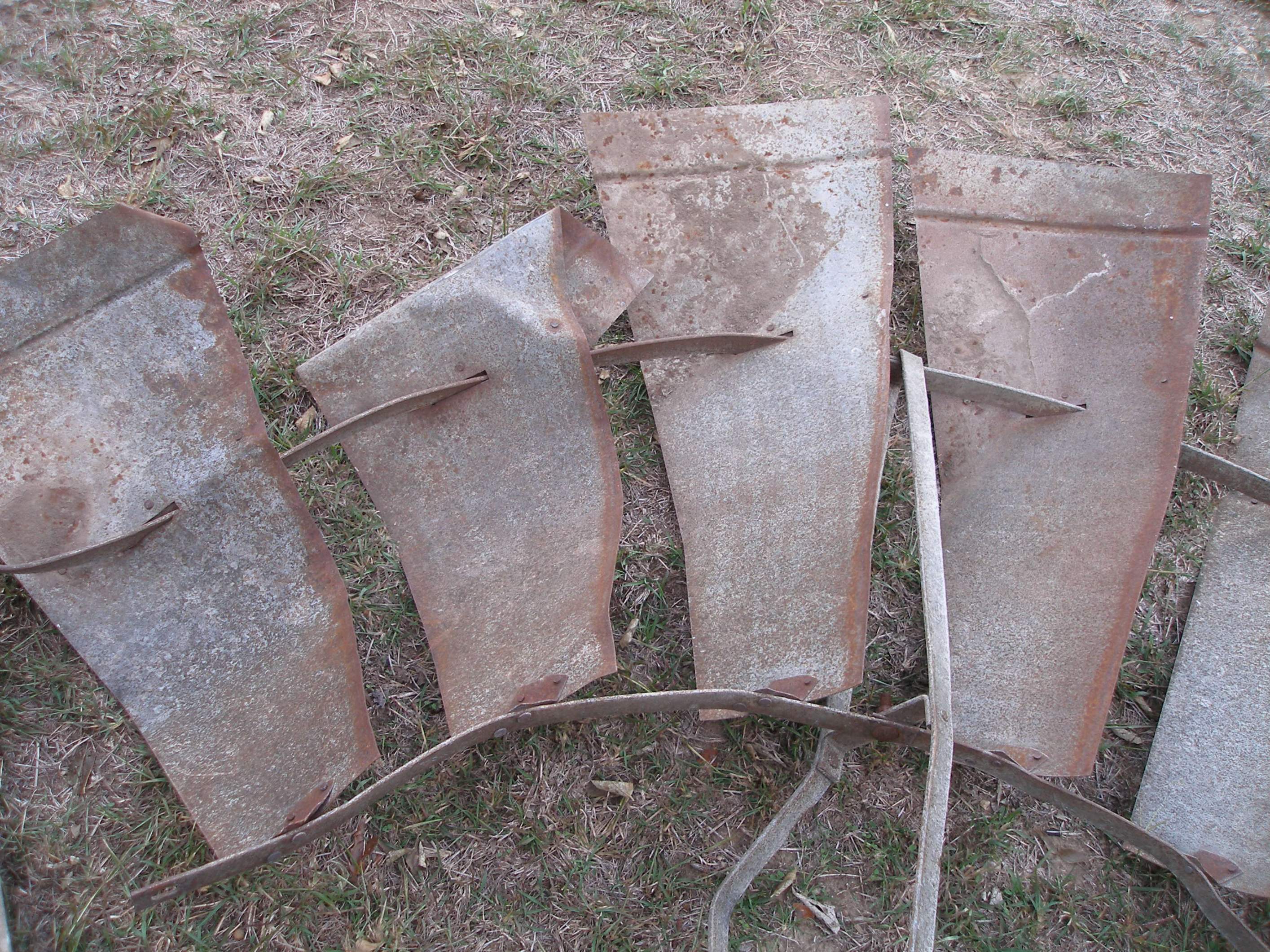

If you felt the beads are necessary, then you could put a simple stiffener on them.
These were stamped on a press, no time was really spent on the bead, except for the making of the die. The bead was no doubt used to help them hold their shape. However; it is not very substantial, suggesting it was not a major issue. I believe it is more to retain the shape during transport and assembly. If you careful working with them, or use heavier metal, I would bet, they are not absolutely necessary.
We still don't even know if this thing is ever going to spin, or just be a static display.
After seeing my neighbors modern wind mill, blow out all the bearings from very minor damage to the blades, I can tell you what I expect to happen if this thing ever spins.
Update: I checked my neighbors windmill when I went out for lunch, It has very similar blades, about the same dimensions, same amount of extension on the ends, with no bead.
/ Flattening sheet metal #32
the bead could be simulated with 1/4" or 3/8" square bent and tack welded in place

Thanks again to all for the continuing suggestions. I have some reading and thinking to do. By the way, would a 20 ton shop press and some stiff 1/2 inch plates with a fan blade in between and then squashing the sandwich with the press do any good ?
I removed one of the blades and started playing with reshaping it (just purchased a shrinking hammer/dolly set from HF I'll be playing with) and rust removal. Got side tracked on getting a home made abrasive cabinet since it appears that is the way to go rather than wire brushes/grinder etc. Picked up a used 40 lb. HF abrasive blaster for cheap (thanks again, Craig's List) and will be kludging the cabinet together. Some really ingenious ideas on the internet for a homemade sand blasting cabinet from Rubber Maid plastic storage tubs, discarded dishwashers and stoves (which have a built in view window !), etc., using shop vac for dust evacuation, etc. Figured I would eventually be sandblasting the windmill motor parts, so might as well get sandblasting capability now and use it on the fan blades to speed things up.
I may have to fab some or all the blades but one reason I wanted to do what I could to save as many as possible is the windmill (a Model 12 Dempster) was made the year I was born, 1947, so I want to keep as much original as I can. And there's something satisfying about keeping costs down even if time IS money...

i find the most straight org blade i could.
it should have some natural curve to it.
I would make a wooden dolley to fit that patter so the blade layed in it nicely.
then take the bent up ones and use the wooden dolly to beat them back into the correct shape. They may not be perfect, but they will be a lot better than what you got now.

Maybe looking at the picture, I am getting a distorted view.
The blades look like they have a gentle round curve in them, I would not want to put them, "flat" and then try and bring them back to curved. (referring to your press comment)
The press could well be used if you were willing to make up the forms, to press out new blades, bead and all, but that would defeat the saving the old parts idea.
The less you work the metal to get it too position, the better off you will be.
