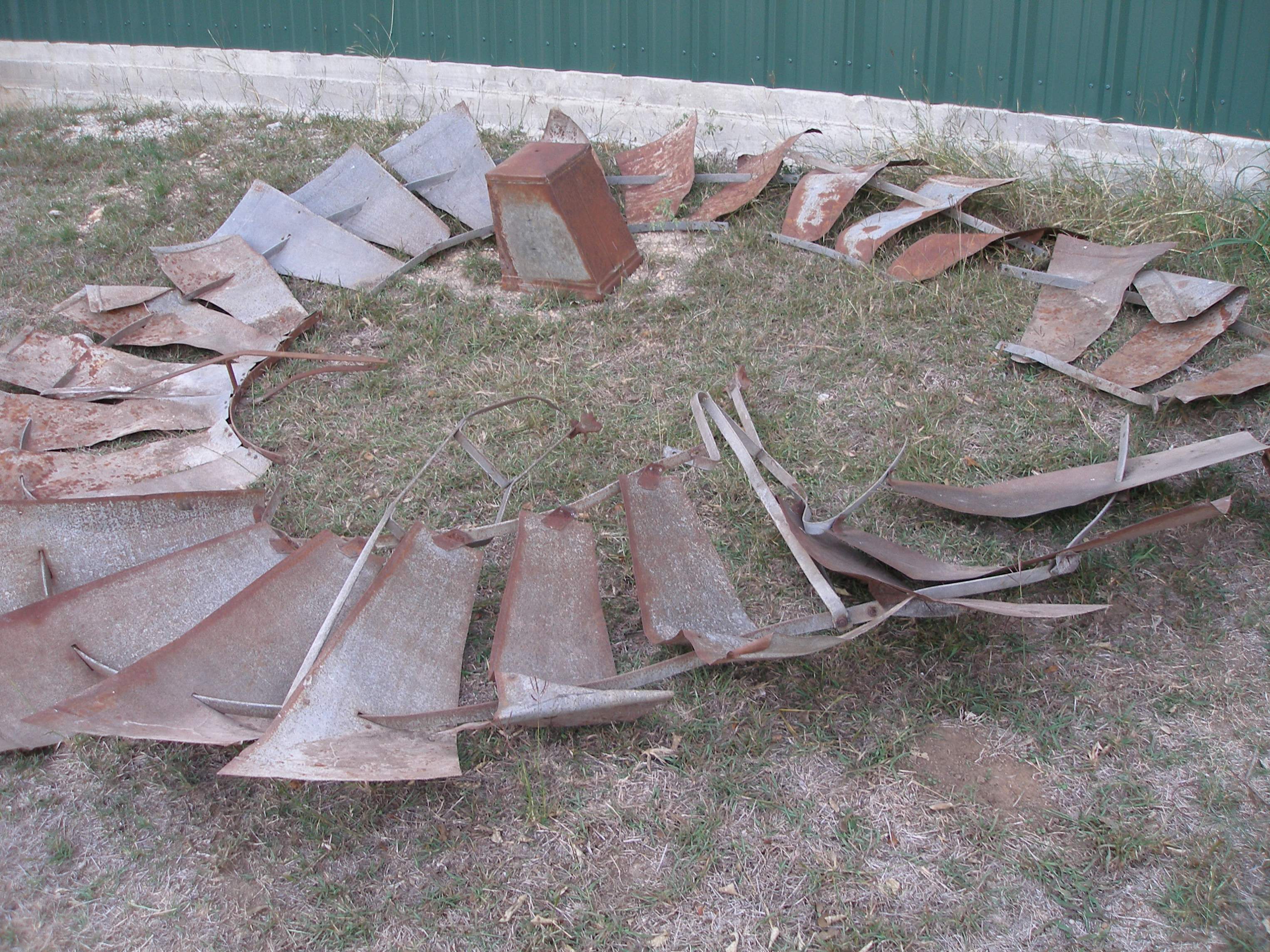

Hi folks,
I just got an antique 10 foot Dempster windmill I am going to rebuild. There are 15 fan blades which are variously bent up and dented quite a bit.
Could someone suggest some techniques for getting the dents out and getting them flat and straight again.
First (and call me stubborn), I do not want to take them to a metal working shop to be rolled but want to do it myself. Second, the most obvious thing is to get a rubber mallet and start pounding away. And third, I am aware that you can purchase replacements for maybe $20 each but don't want to do that unless necessary
But are there some better home techniques ? For example, does heating them with a brush torch first help ? Or is there some clever jig I can fashion using a hyraulic shop press ? Or are there some tools I should get used by auto body repair men. Can I rent a mini-steam roller for 1/2 hour and roll over them in a parking lot (partly serious, partly in jest).
And and all suggestions or pointers to websites/forums are welcomed.

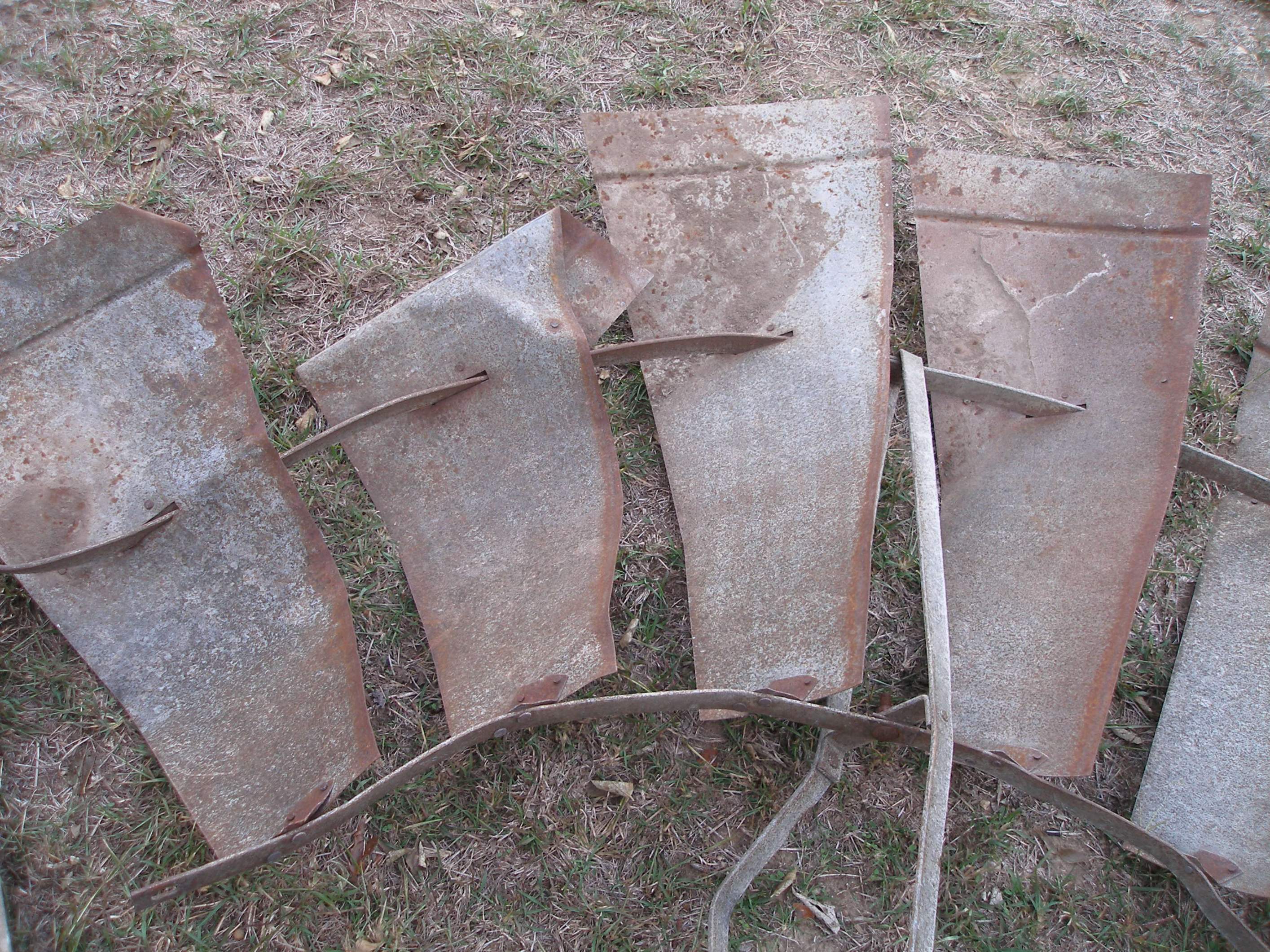

Thanks to all for replying with all your suggestions. I hope the pics of the windmill uploaded, if not I'll try again.
Many focused on the metal stretching if I pound and I don't quite understand why I'd care. The fan blades are not high precision with precise joints so who cares if the blades stretch out a bit ?

As a complete amateur in this kind of stuff, it looks like many of those blades will need replacement. If you can get all new ones, they will at least all look the same.
/ Flattening sheet metal #16
It would be better to just make new blades, than to try to fix most of these.
If you have a HVAC contractor that fabricates in your area, you could possibly buy some sheet metal scraps for a good price.
You could possibly make it look decent as a stationary unit, though I doubt if it will ever look good unless you start over with new parts.
If this thing is actually going to spin at any kind of speed, that looks out of the question right now. If you don't have the disc in a good, balanced alignment, it is going to shake and vibrate until the bearings give out, and it comes apart.

Those blade look too corroded to me to bother. Just get yourself some galvanized steel sheet stock, a handful of cutoff blades for a 4-1/2 angle grinder, lay out the blade pattern and cut new ones. A waste of time to salvage that rusty junk.
