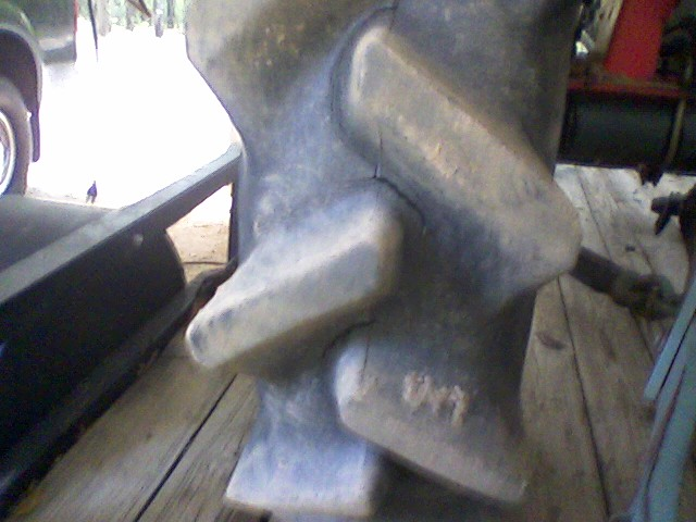

Seems like we're running neck to neck on our tractor repairs, :cool: , I have some brush cutting needing to do myself but been putting it off until I get the other badly dry rotted tire replace, while bush-hogging last year I apparently puncturing the tire/tube I wound up replacing it with a used tire and now it is even showing signs of cracking, the other old and I believe to be the original tire, if inflated all the way will force the inner tube to squeeze through some of the cracks, I've let as much air out as possible to prevent the tube from coming on through so I can at least use the tractor for other tasks,
I've found a few suppliers who has used tires but they also have cracks as well, though not quite as bad as what the tire I'm running, I believe it is a wast of money to buy these and ultimately need to buy more in the near future,
I'm trying to hold out to find a pair of 1-size larger (9.5 x 24 ) tires to go back on rather than spending another 50.00-75.00 on a used tire that is just a LITTLE better condition then what I already have, ... Patching the tire is a good idea if it only has a few cracks, This may get us by for a while, but if they're like my tires I'd have to completely line the inside with patches to do any good,:D

Carey, I have to say your 30 year old tires certainly look to be in better condition than the ones on my tractor, the 1st pix is of the used one I replace last year, and the 2nd pix shows how bad the remainder original tire is and explains why I feel I'm running them on borrowed time,
