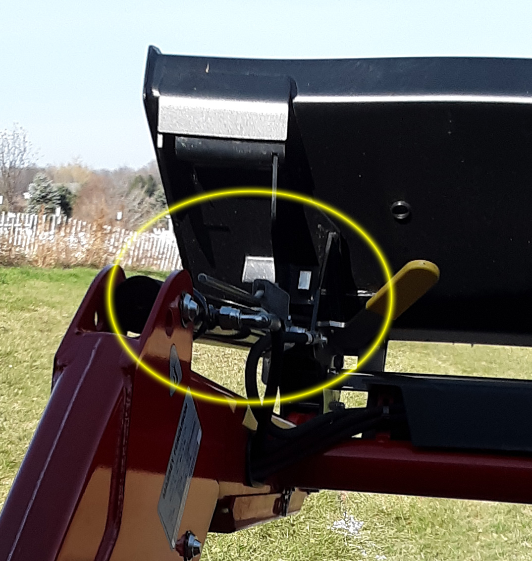

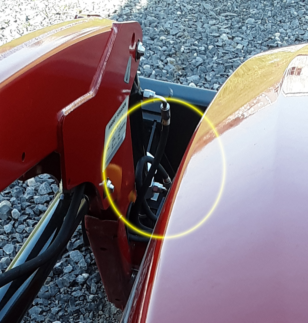

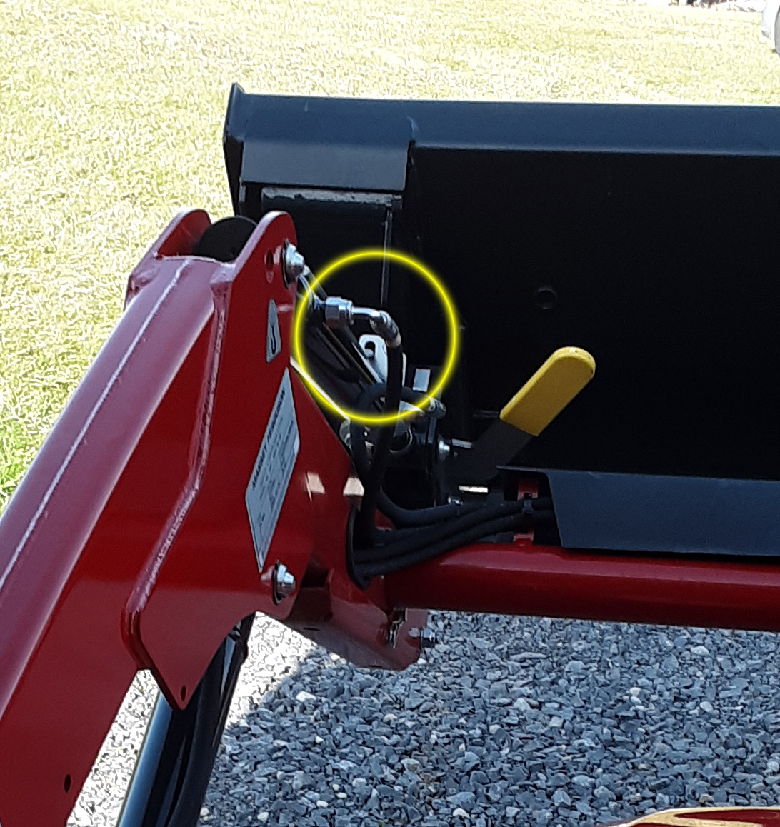

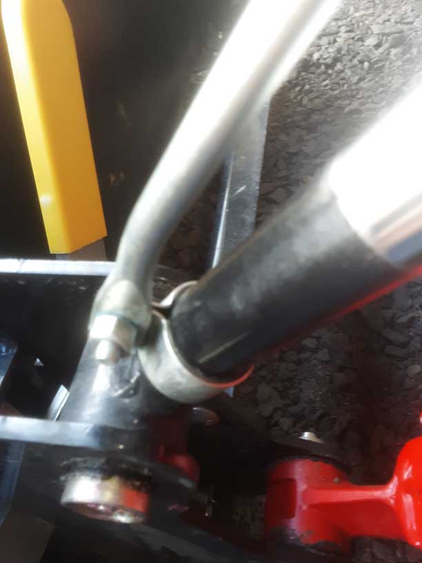

Here is a picture of how this one is attached just in case you did not watch the video.
It clamps at the bottom of the piston rod so it is independent of the attachment on the FEL. There is a bushing that allows the rod to move with the clamp tight. The clamp can be move up and down to adjust.
