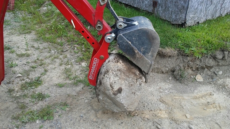

I do not have the BXpanded thumb, but kinda wish I did; I got the factory thumb thrown in with the purchase. Either thumb is a PITA without a hydraulic cylinder (which I added) though. The reason I think the BXpanded one might be better than the factory one is that it is concave while the factory one is convex, and it sometimes it slips off a log.
   / Pimp my Massey: New GC1723EB #24
Convexed???....... What were the engineers thinking....
And I should have mentioned that it is even worse on rocks than logs!

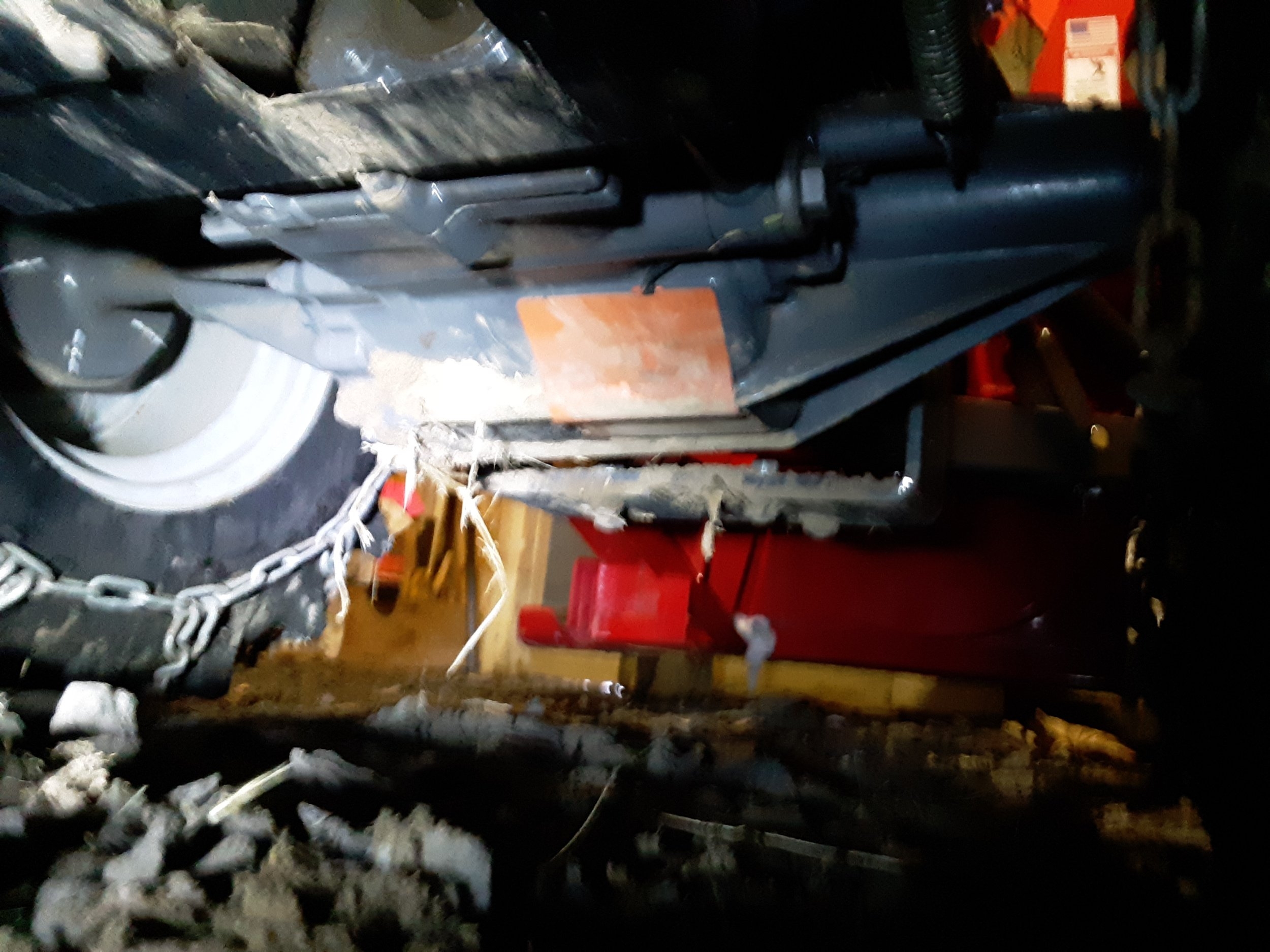

I had to look up electrolysis... unless you get a lot of salt on the aluminum or you live near a salty ocean where there'd be a lot of salt in the air, I don't see where this would something to worry about. But I can't really say, I haven't had my wheels off since I put the spacers on in the fall of 2020. I think about taking the wheels off every spring to check that the bolts are still tight, but then I look at the painted marks on the back of the hub and see that nothing has moved, I used loctite and I don't see a reason to deal with taking filled wheels off. I inspect the marks and what I can see of the spacers every spring and I have not noticed any corrosion.
I wasn't really concerned with the cost, I spent more to have custom skid shoes made for my blower than I spent on the spacers.
This is a picture of the underside where you can see the lines painted on the back of the hub and bolts.
20231212_152800-jpg.837837
   / Pimp my Massey: New GC1723EB #29
I missed a point in my last comment.
3) Because of the other two points I made the weight of the tractor is on the hub and the spacer rather than being on the bolts and lugs that them on. Flat spacers that are not made to fit over the hub and into the wheel cause the weight of the tractor to be on the bolts.
