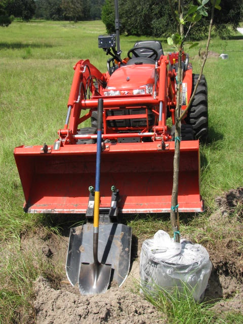

Bucket Spade FEL bucket attachment. Photo #1
VENDERS: Quick Spade Combo - Skid Steer Tractor Trencher Loader Bucket / Fork Attachment | eBay
XL Chain-On Quick Spade
Tractor and Skidsteer bucket spade shovel

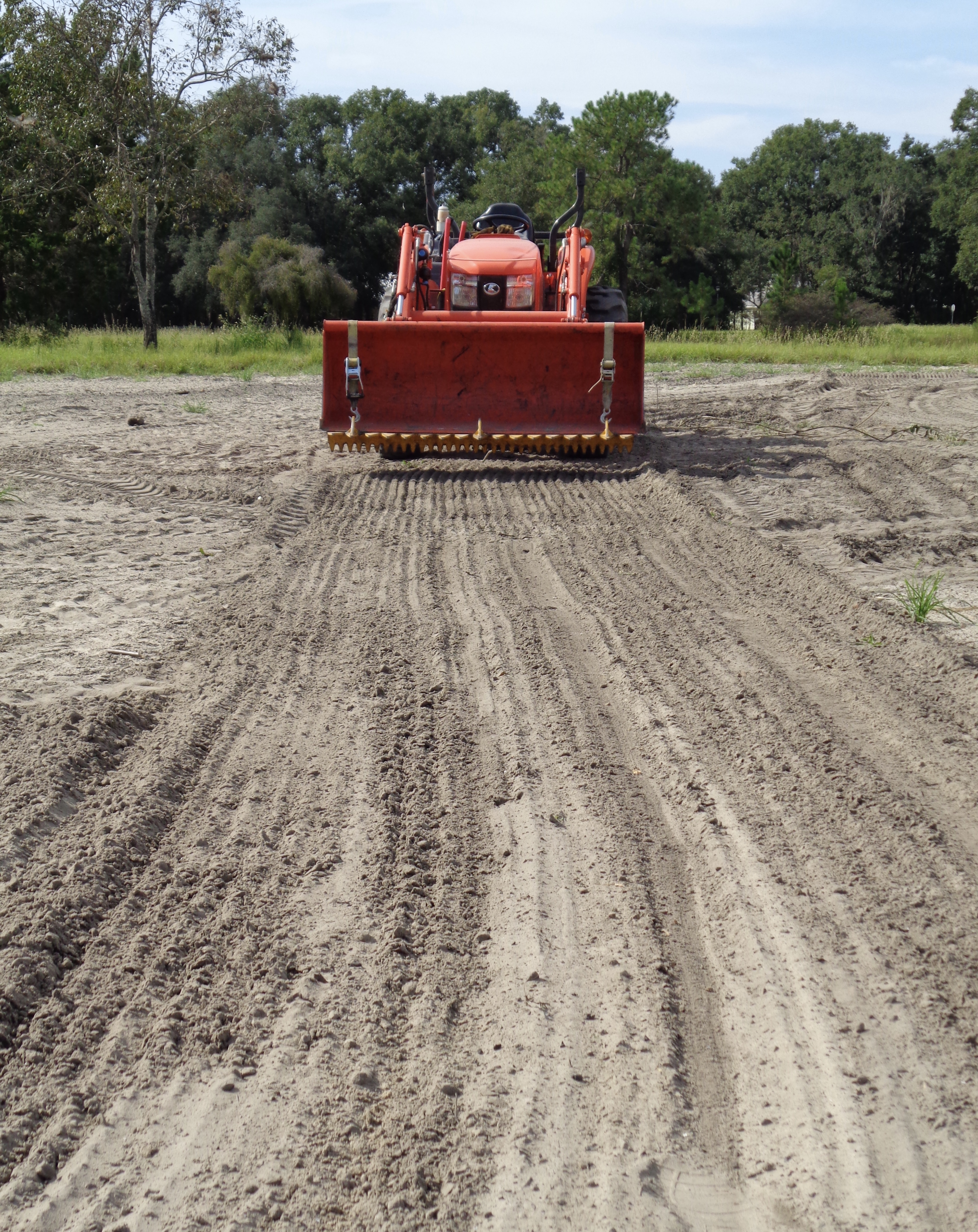

-level and fix areas near retention pond

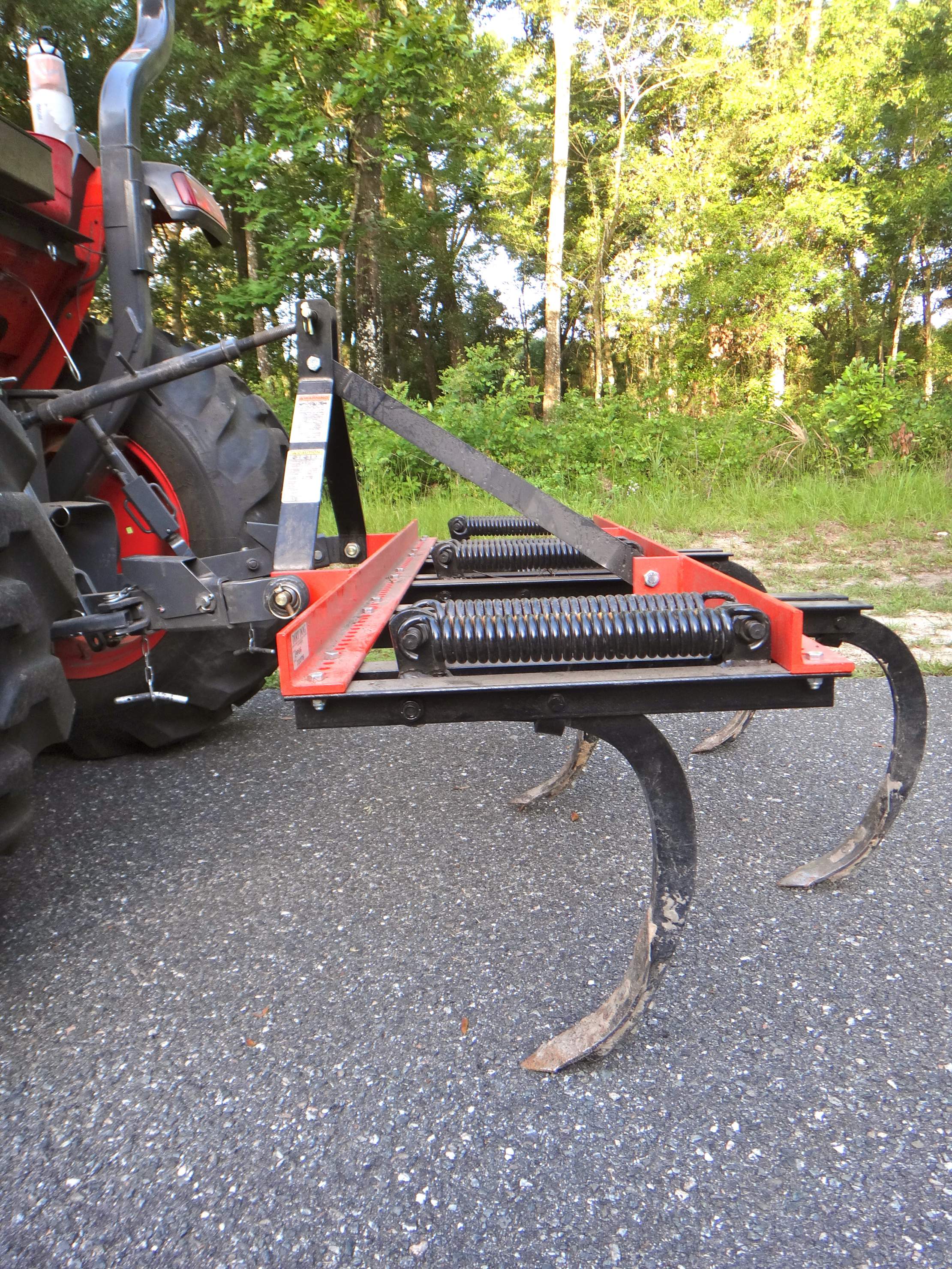

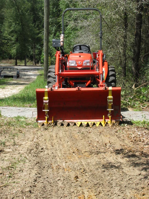

FEL bucket with Ratchet Rake attachment. Photo #2, #3
-Maybe be used in a small garden but it would be very small

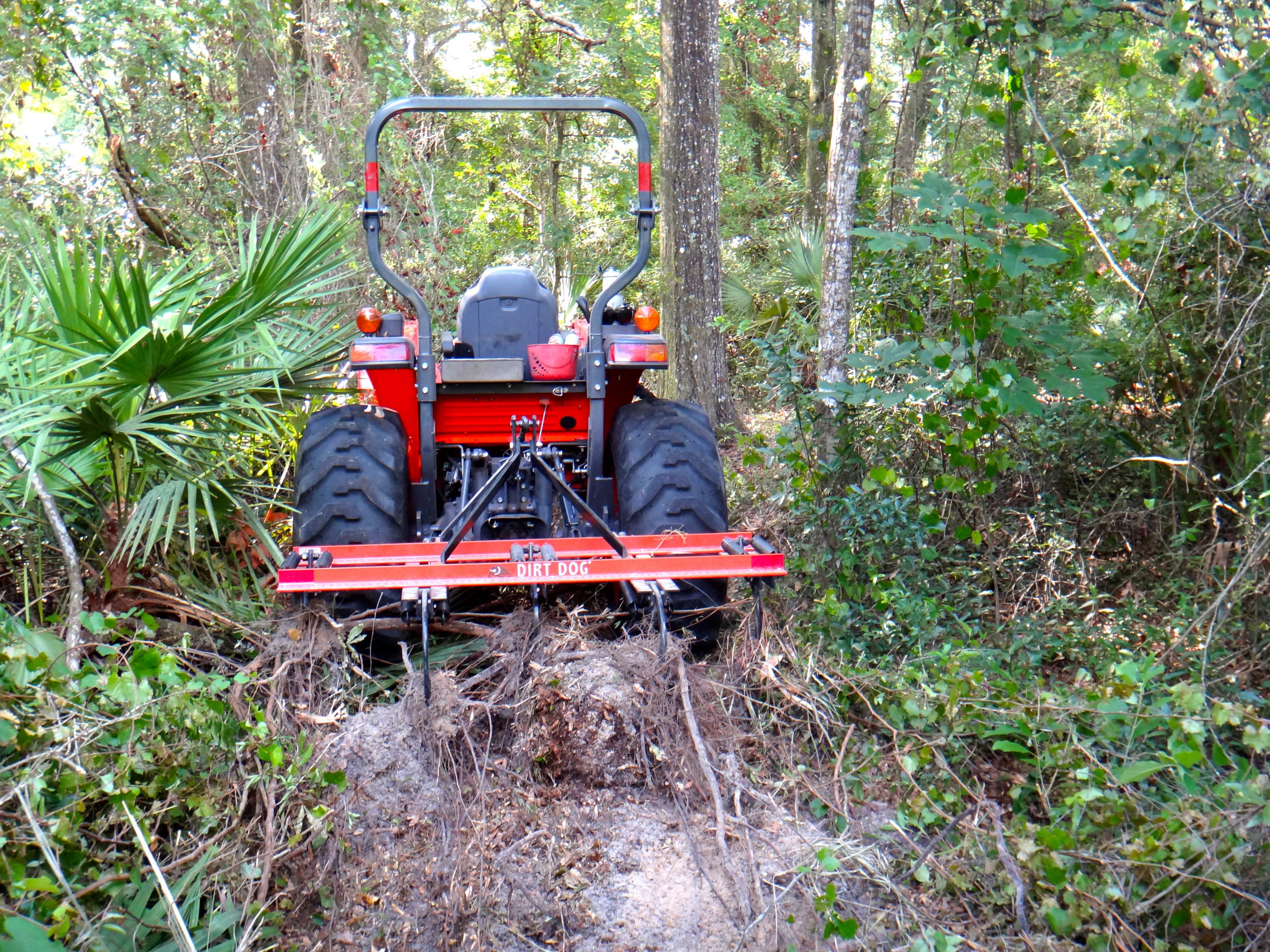

-build trails in the wooods
Rotary Cutter plus Ratchet Rake bucket attachment. Or Rotary Cutter plus three shank Field Cultivator AKA All Purpose Plow. Photo #4, #5
