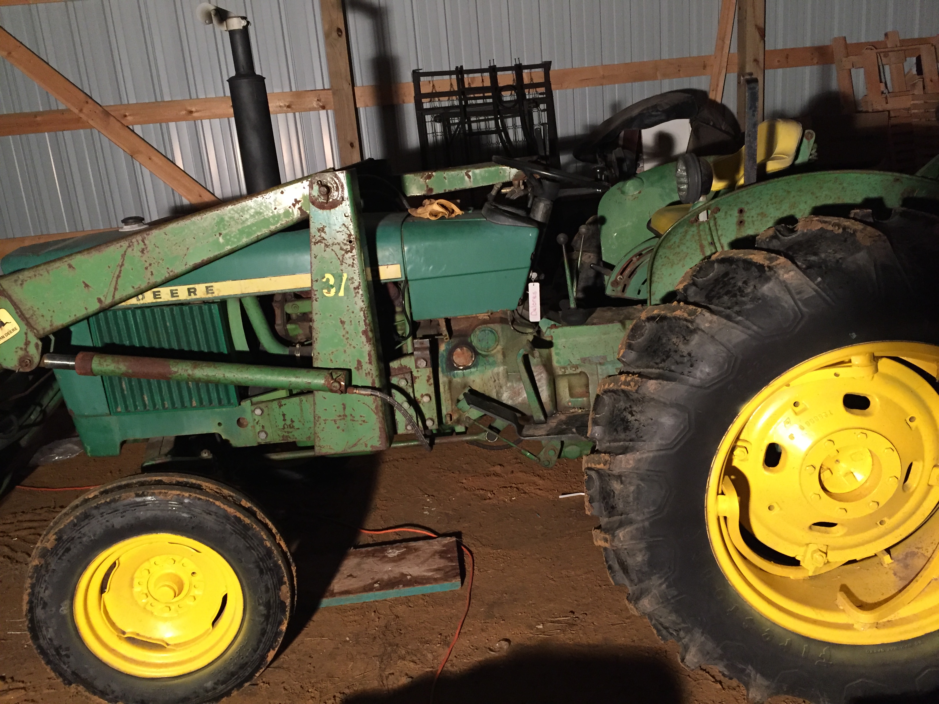

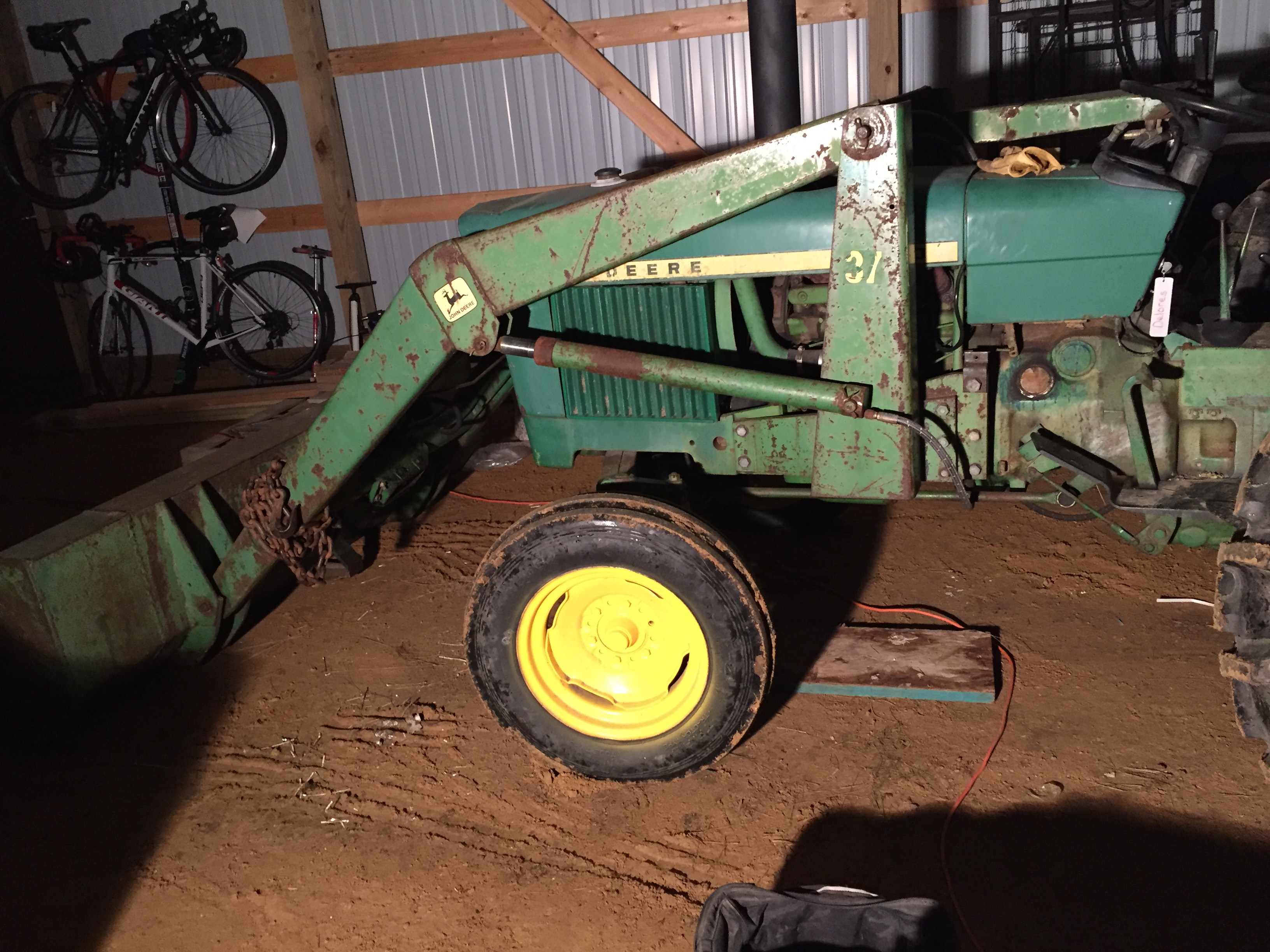

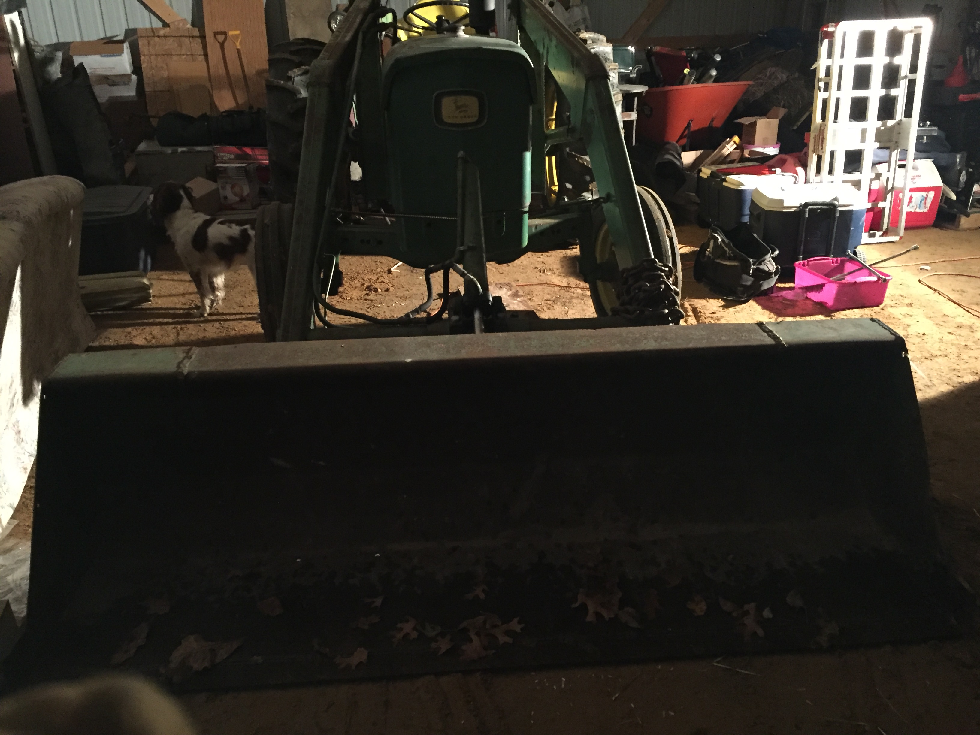

Your tractor caught my eye once before. I was admiring your platform connected to your three point. I have a lot of wood cutting in my future and loved the versatility that it provides you. My loader is a single cylinder like you would see with the manure bucket option that the model 37 had. There is down pressure with the bucket, but not on the boom. Mine no longer has a manure bucket, but a 84" loader type bucket. It's huge. I plan to retrofit a snow plow blade to it for winter plowing in the coming weeks.

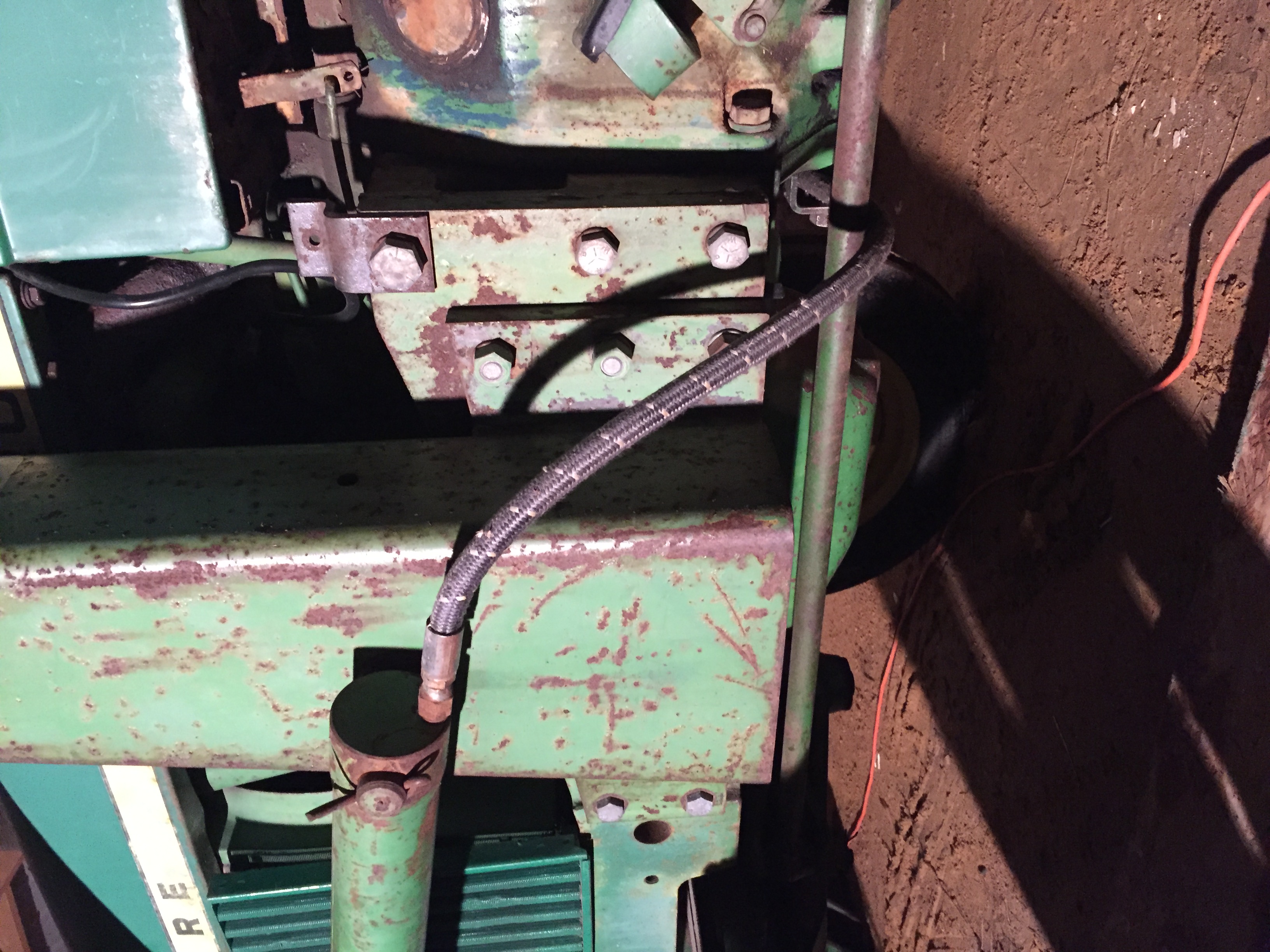

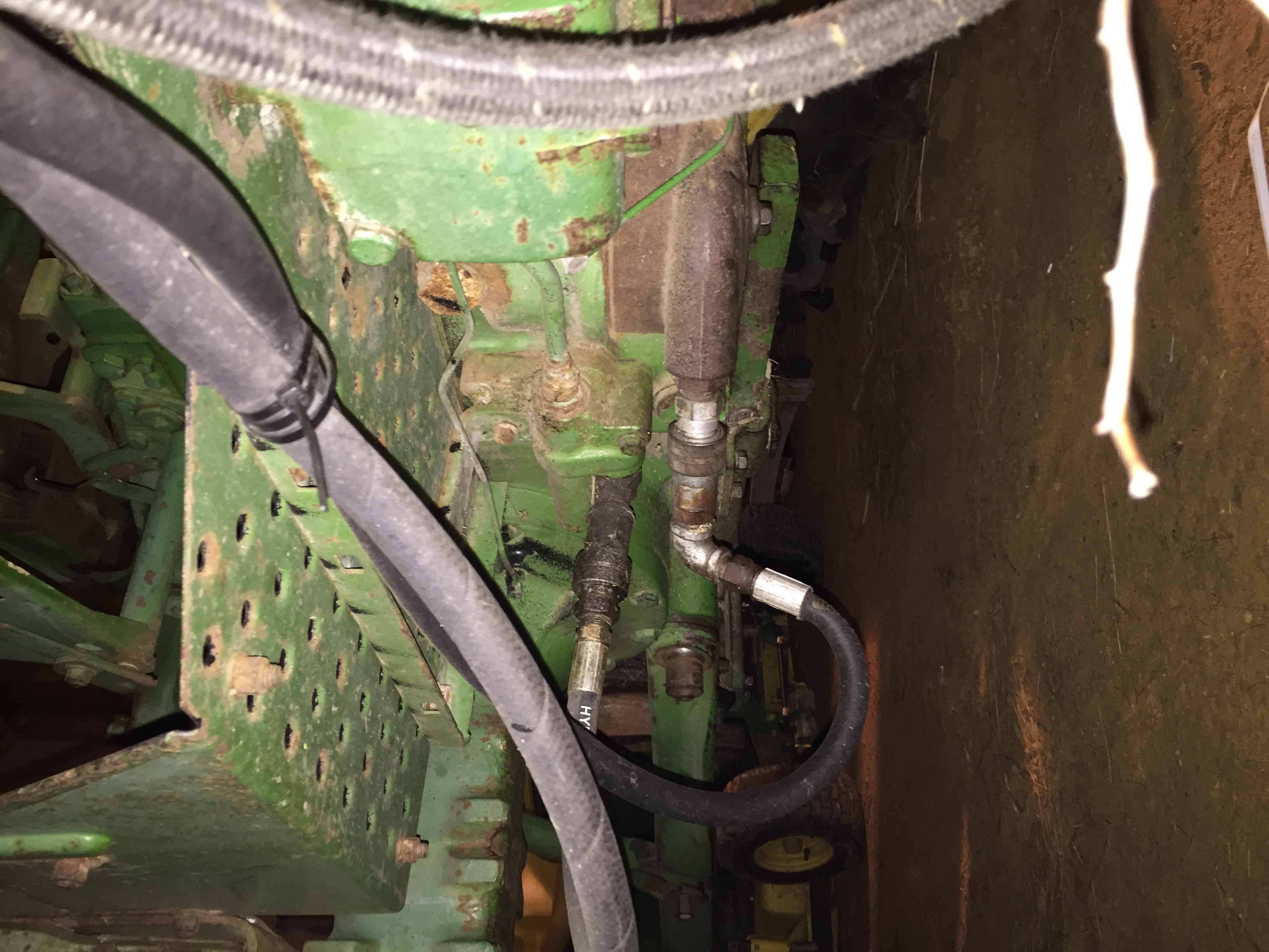

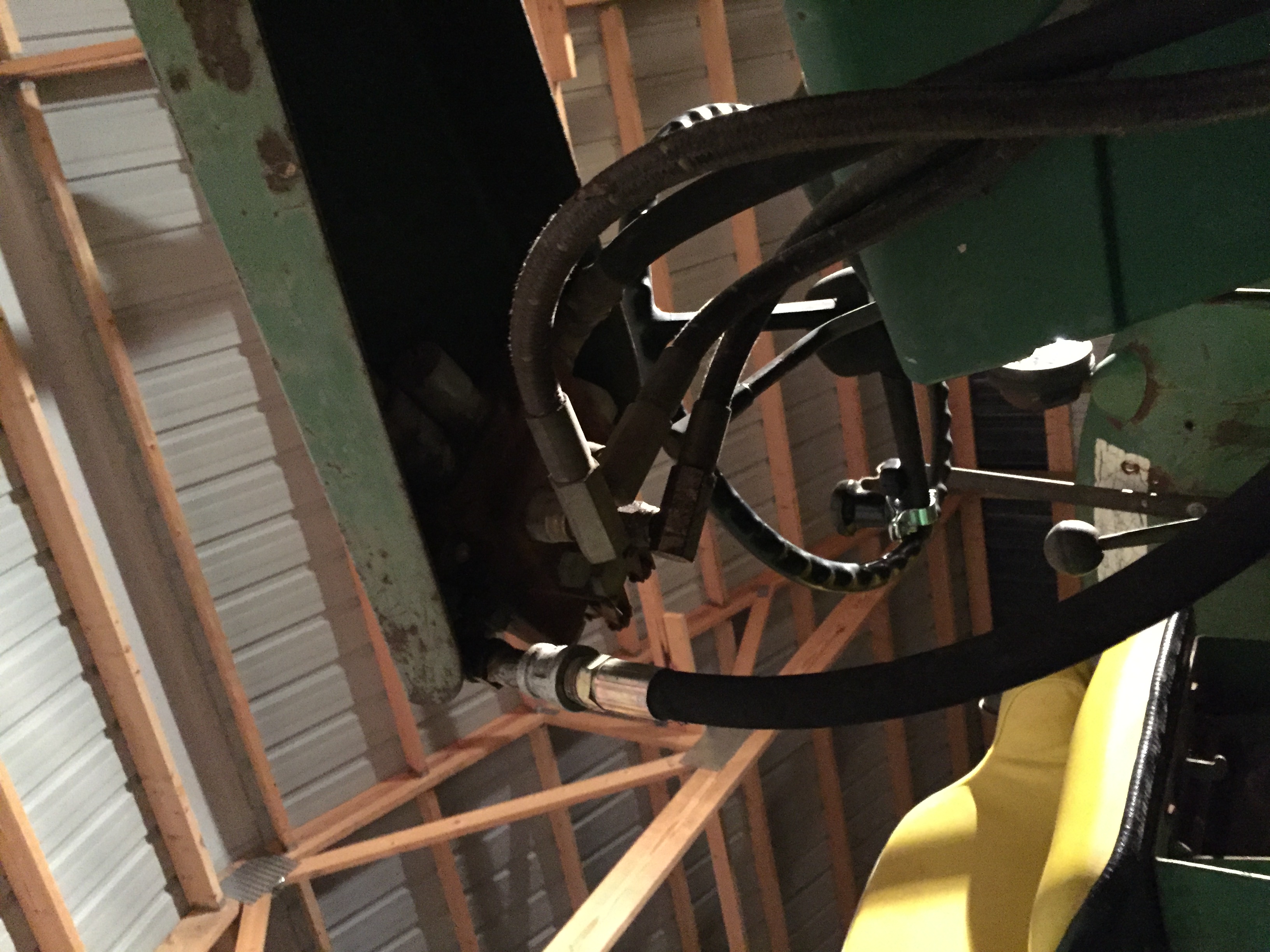

Regarding the routing of the hydraulic hoses, yours is nice and clean; much cleaner than mine. However to feed the left boom cylinder, they route under the tractor. I will snag some photos tonight when I get home.
   / First time tractor owner
#16
Here are more photos of the tractor, specifically the routing of the hydraulics. Again, this is as it was from the previous owner and have not touched it YET.

I'd thought about running the left boom hose underneath, but decided not to. Couldn't find a way to protect it, and my exhaust runs down and back. I tried to route everything where it wouldn't be snag-happy.
