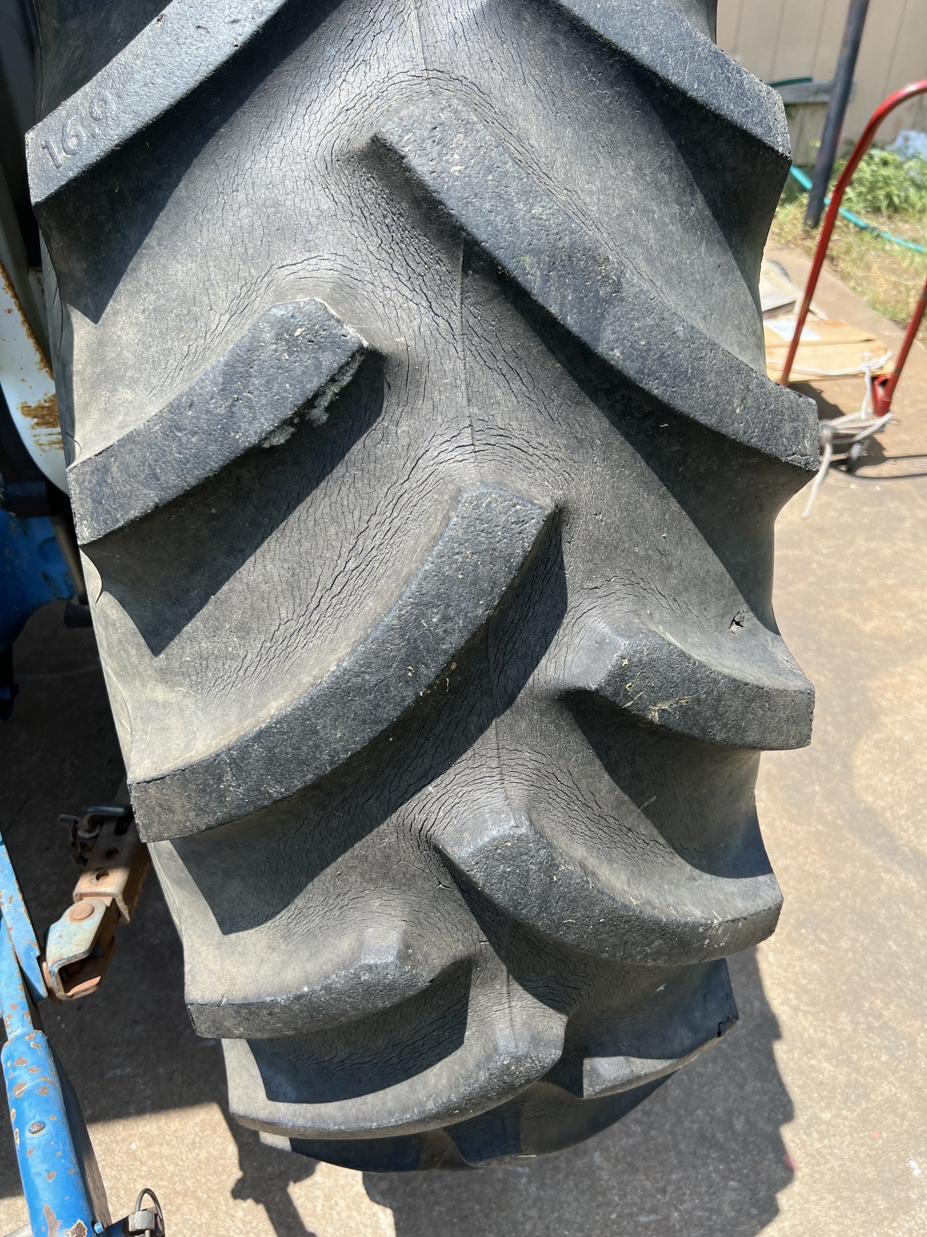

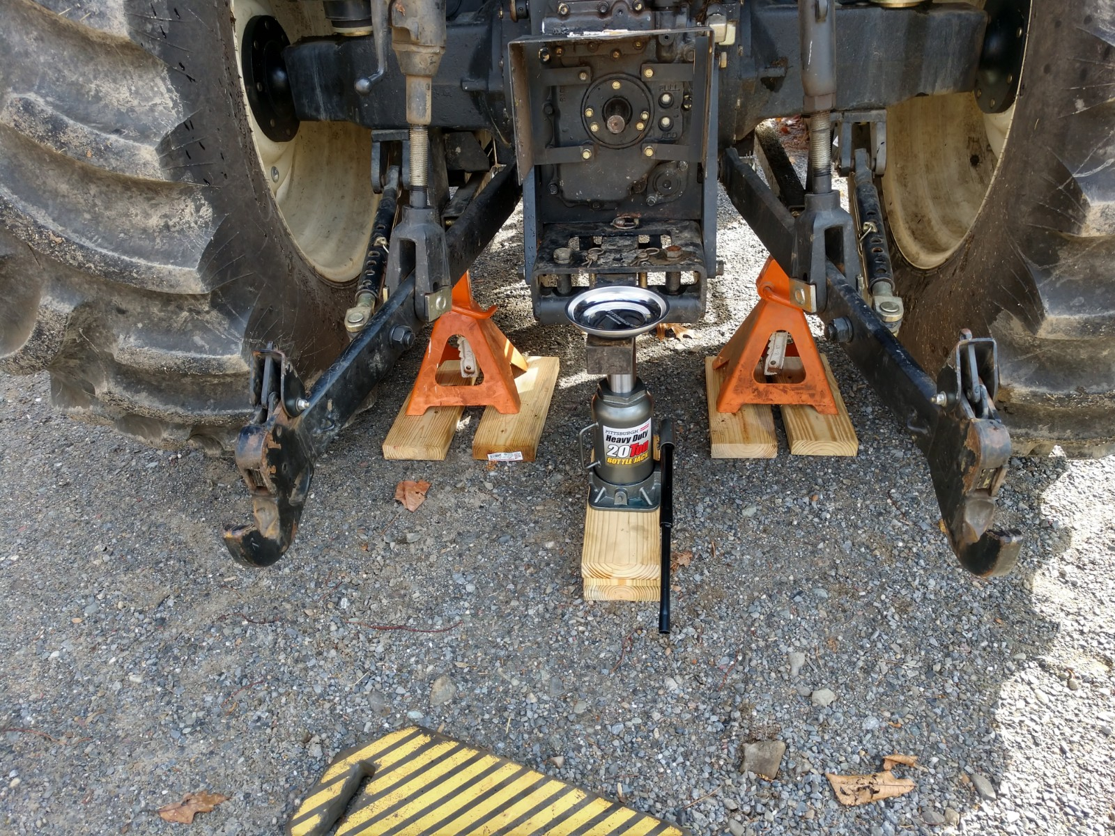

This is my first time jacking the tractor rear end. Tractor is a Ford 4610 purchased new in 1992. Rear tires are original, not filled, and I believe in need of replacement. I was mowing the backside on my property and parked the tractor behind the shop so as to finish the next day.

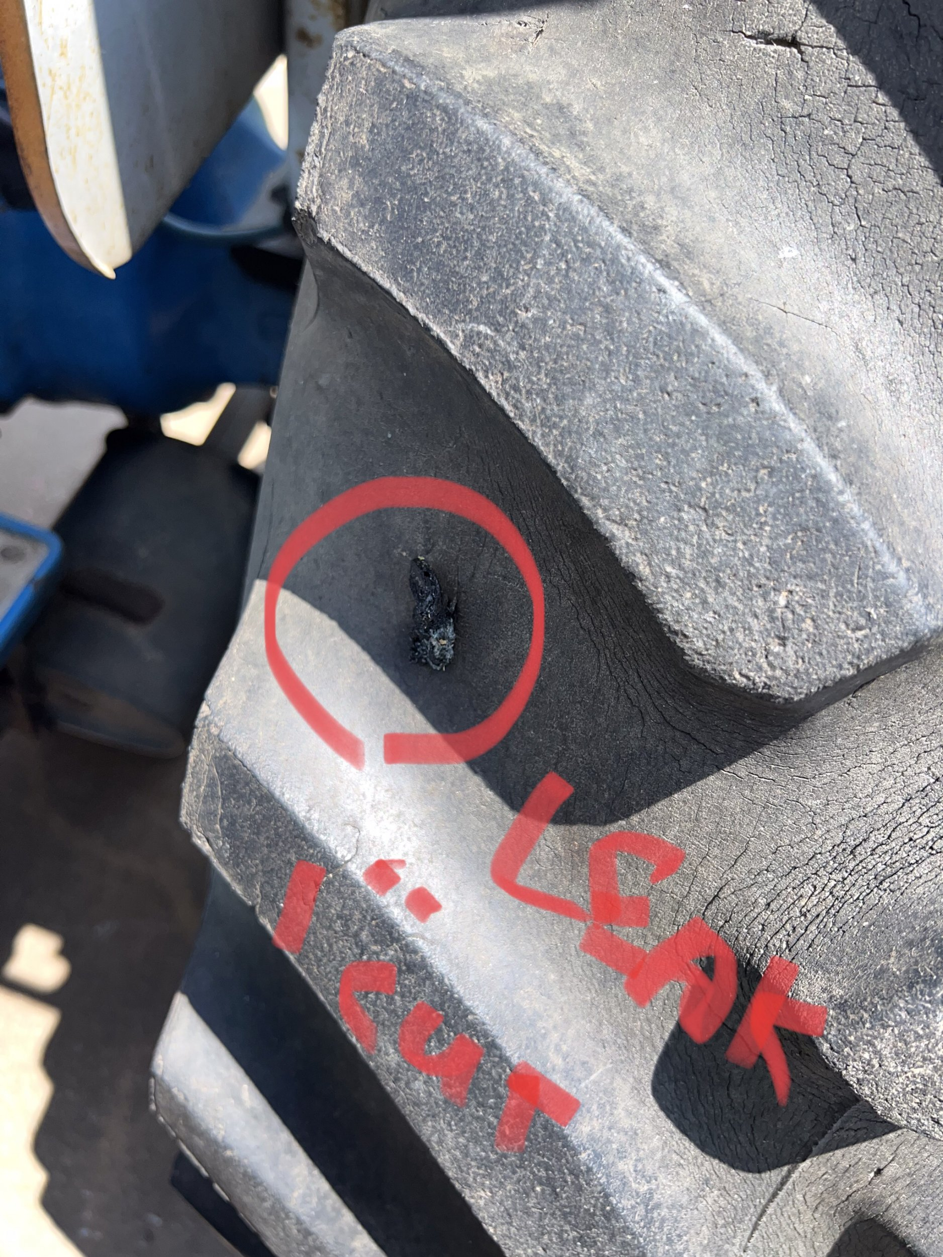

Next day I found the left tire was going flat. I was able to air the tire up so I was able to remove the mower and FEL. I parked the tractor with a jack stand to support the left side. I decided new tires are in order. The problem is I have to take the wheels to town for the replacement. I no longer have a service that comes to me.
First battle was getting the lug nuts loose. They are 1 ½” and we’re on super tight. Either over torqued or corrosion. I made a couple of new tools. Once I had then loose I was on to the next problem; how to lift the rear end?

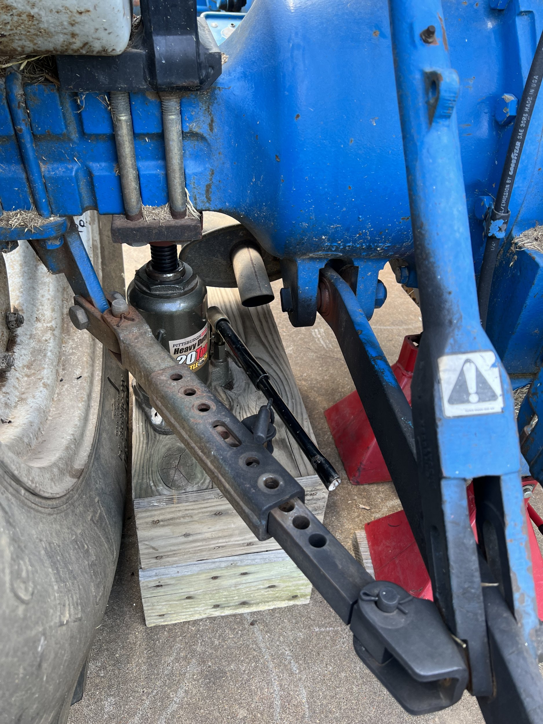

Searching how to do it, I decided to use a 20 ton bottle jack with 2 jack stands for support, one being a close standby. The pictures show how I have this set up. I have the tractor just about level left to right. So I would just raise the left side, remove the wheel and then lower to the jack stands. Do the same on the right side. Doing one wheel at a time.
Just looking for feedback or suggestions if my plan is good. Anything to look out for. Any idea on the weight of the wheel. Thanks.

Weight of wheel is = heavy.
y not just plug that leak? Does it have a tube?

I don't think I would support the tractor under those lower arm brackets. I'm a little gun shy though... Last summer I snapped one off on my Kubota. Totally different circumstances however.
I would also plug that tire and get another 20 years out of it.

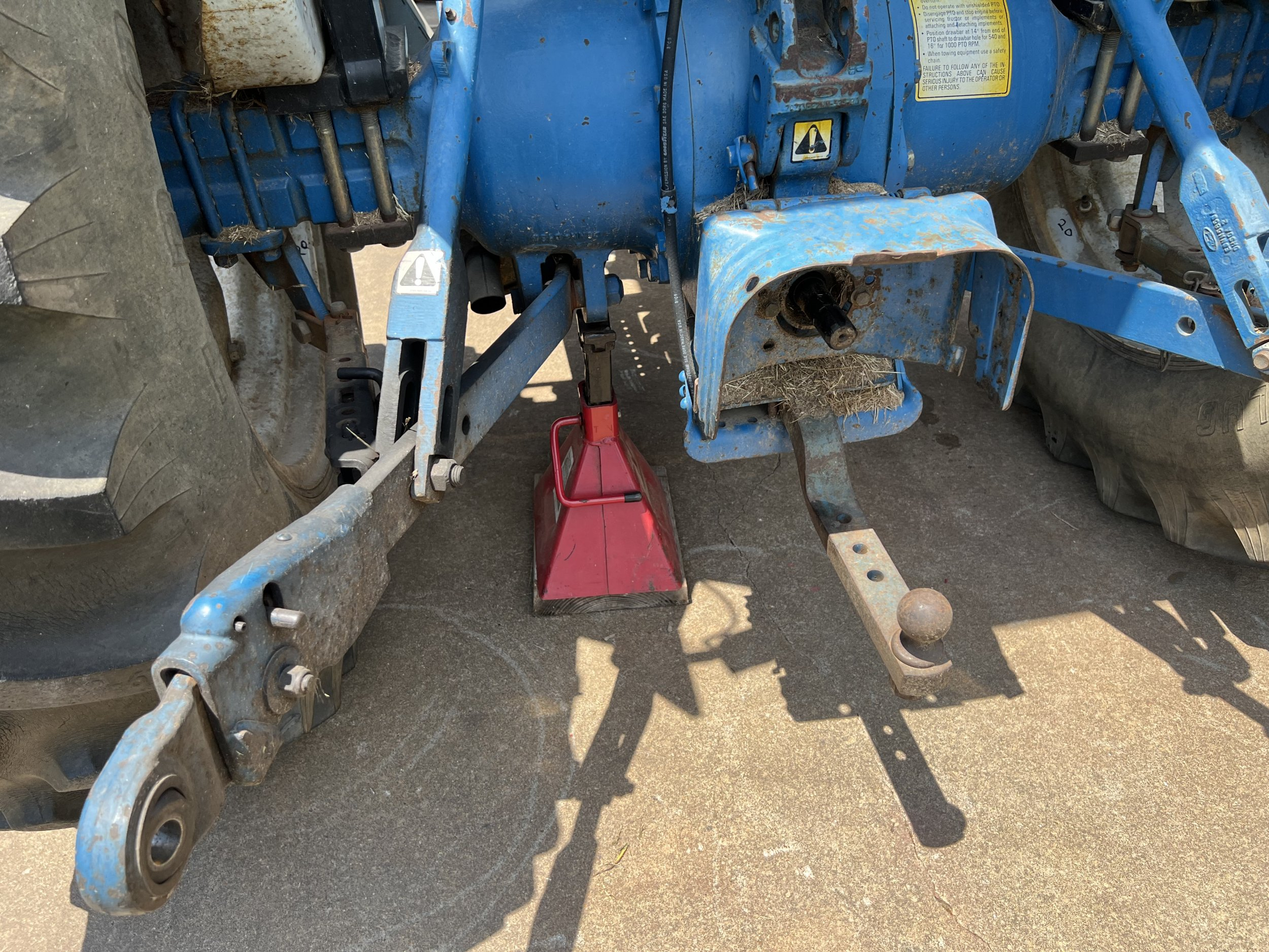

When I swapped my tires around for more space for chains I did very similar;

Typical safety hints... Chock the front tires since the brakes are on the rears. Break loose wheel bolts while on the ground. Then jack and block. I like wood cribbing rather than jack stands. Metal to metal is slippery unless the tractor rests in the jack stand cup. There's only flat surfaces under my tractor. I also leave the jack under the tractor with a preload on. Sort of a belt and suspenders approach if one were to slip or fail.

I would plug that tire and go on about my business. You can get many more years out of those tires.
Elevate the "offending" tire and plug it. No need to even remove the tire/wheel.
/ First time jacking tractor rear end. #8
I want them old bad tires. I'd get another 30-40 years out of them. Just fixed a flat on my neighbors. He knows that tire hadn't been off since he bought the tractor used in 1968.

Thanks for all the replies. The tires are 16.9-30 tube type, not filled. The tractor sits on a concrete pad. I initially placed the jack stand under the lower arm bracket as it was easiest at the time. After reading it was not a good location, I moved it to the drawbar support bracket. It is now in a C channel cross member. Jack will also provide support. Finding a good flat spot is a problem. All 3 wheels will be chocked.

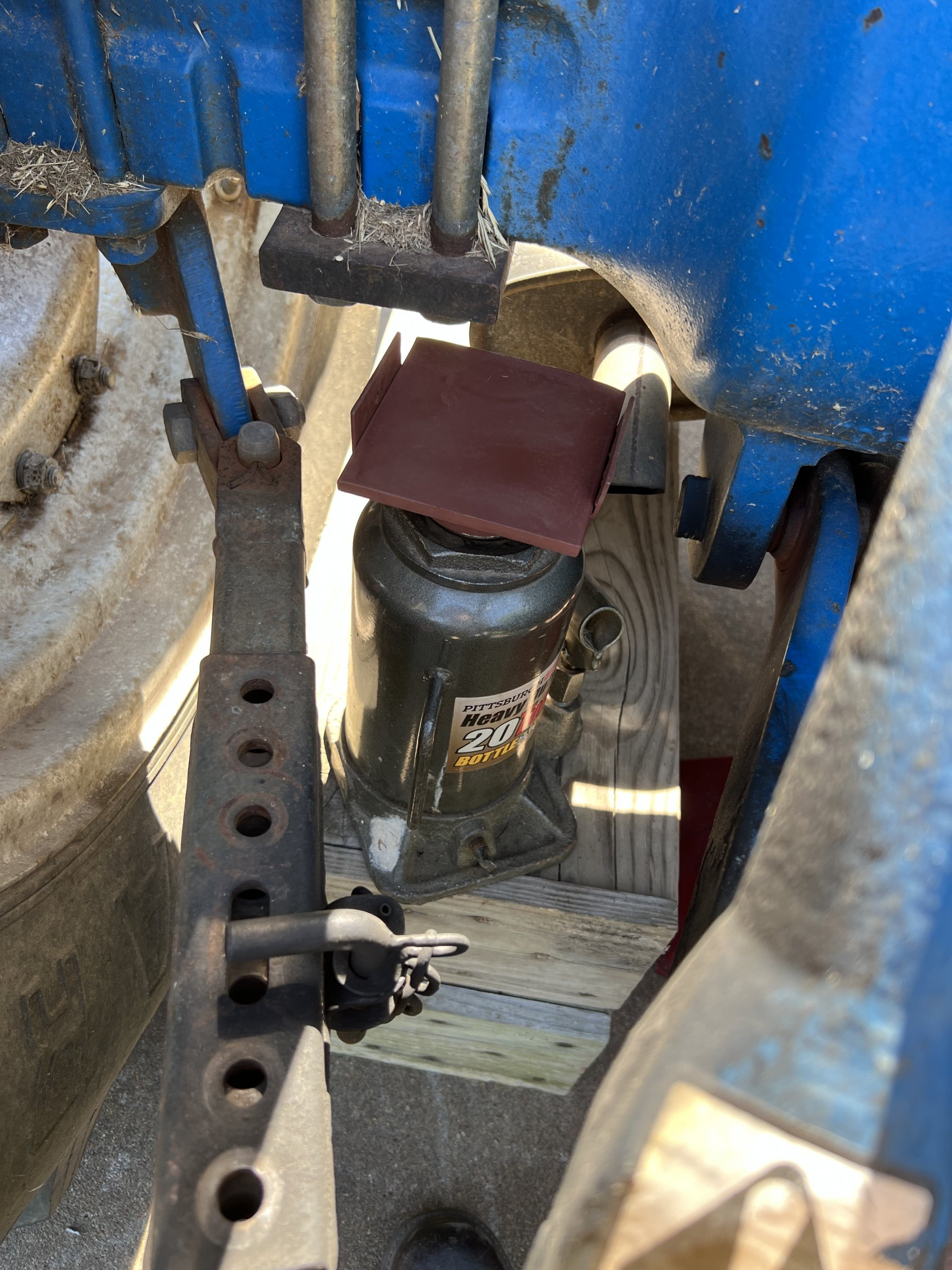

Jacking will be on the axle under a flat plate where the ROPS is bolted. I made a bracket for the jack so it cannot move left to right nor forward and aft. Using the bottle jack will make aligning the wheel with the lug bolts easier. I think.

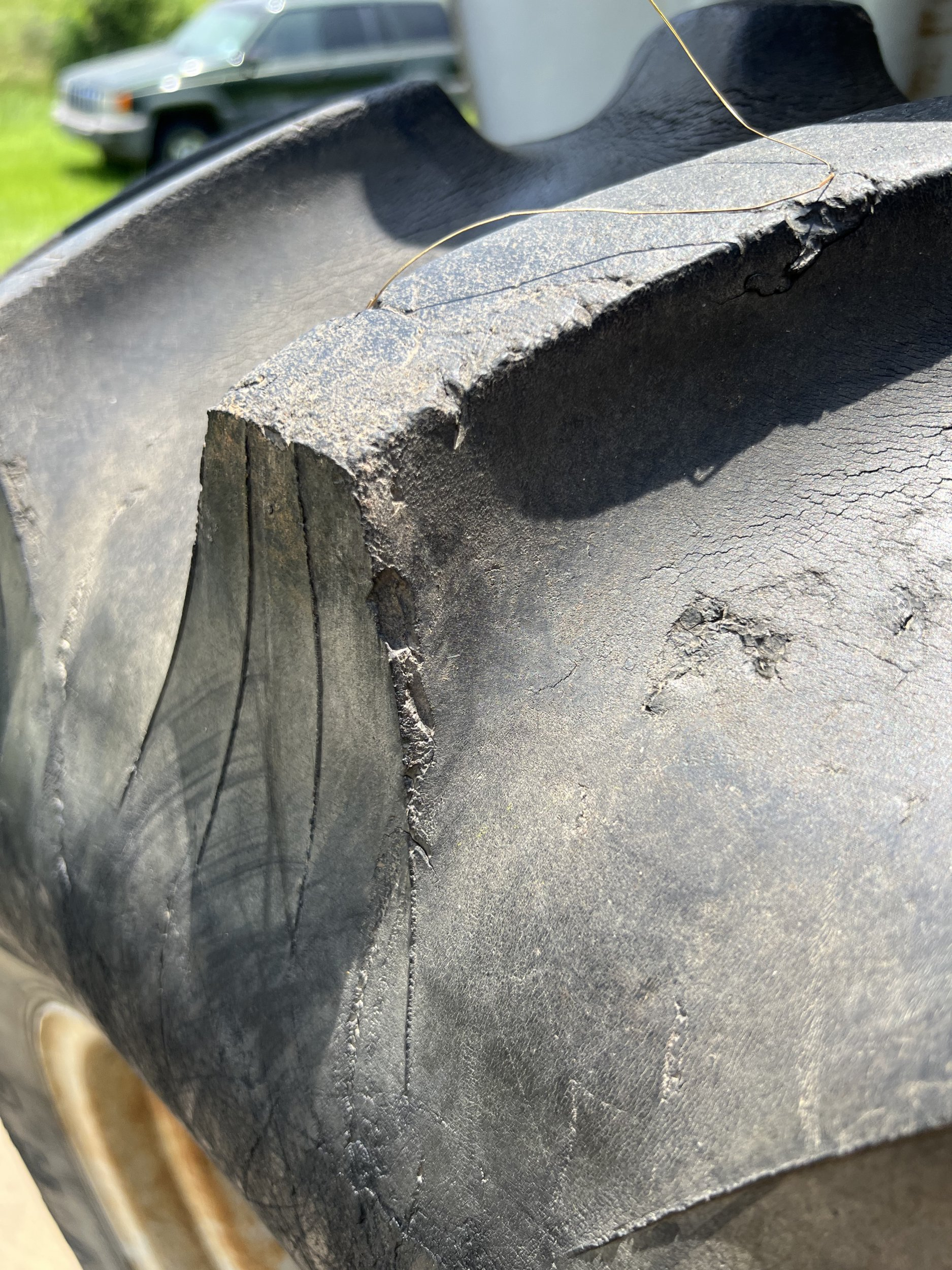

You can fix a tube tire while they are still mounted on the tractor, we never take a rim off to work on a rear tractor tire.
If you are running a tube plugging will not work, it will need to be broken down and the tube patched or replaced.
It something poked through the tire or the tire has been penetrated it should have a boot installed in the tire.
A boot is similar to a tube patch but much heavier and is designed to function much like the carcass of the tire.

Pick up the rear with a floor Jack. Place Jack stand under axle and lower it down being sure to get the axle into the u on the stand.
I use my 3 ton floor Jack.

Important to know, very important, that lifting tractors is completely different than cars or pickups.
The front is not supported by the front wheels at the corners, its supported by the front axle pivot bolt at the center.
If the whole rear is lifted at the center, you've got the whole thing balanced on the jack and the front axle pivot bolt.
If it starts leaning to one side, you're in big trouble in a hurry.
And obviously, the bigger tractor the bigger challenge.
If at all possible, only jack up the rear on one side at a time and leave the other side wheel in place for stability
If the whole rear lift is necessary, two jacks, one on each axle is best.
The challenge there is that you may not have enough room for a jack and a jack stand on each axle.
I have used a single jack at the center with stands at the axles, but it gets tricky.
A helper, or two are needed to keep raising the stands or adding dunnage.
And filling in a 1/2" of space or less.
If the tractor starts to lean over to the right, the jack and stands will get spit out to the left.

Well I could not find a tire service that will come to me. I spoke to my tire man in town and the plan is to keep the tire. He will put a boot and use a new tube. So I will have to remove this wheel and take it to town.
I'm certainly learning a lot regarding lifting this tractor. I’ve given thought to many of the points made here. I’m not in favor of lifting from the center due to the instability I will face. So I favor lifting the axle on left side while keeping 3 wheels on the ground. I will have a helper while doing the work. I will definitely go slow and study the lift as I progress. It going to be interesting.

Well success!!
This morning as I walked to the tractor and looked at it, I had one of those “ why didn’t I think of that before moments” What I saw is that my tractor has a FEL support that sticks out and is even with the inside sidewall of the front tire. A jack stand under that support would stop the leaning concern that I had.
So I just moved one jack stand to the FEL support and made a test lift of about 2 inches on the jack piston. Sure enough the jack stand was supporting the tractor right side. The real surprise was that I found the left wheel was clear of the ground. Hooray!
I called a friend to come to help with getting the wheel off. The lift only required a piston extension of just 1 inch for the wheel to clear the ground. We rolled it on the trailer and it does get heavy once it leans off of vertical.
I’m sure with the tire repaired and full of air I may have to lift the tractor a bit more. I also believe what really helped was my placing the tractor almost level left to right. Right side was just 1 inch higher than the left side. That was my starting point.
It sure will be great getting my tractor running again. Again thanks to all. It was good information and a good learning experience for me. Plus you all saved me a ton of money.
